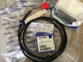

I went ahead and purchase Volvo part# 9442888 and set about the installation of the new replacement wiring, this wiring is only short and is only intended to be patched into the existing wiring harness near the fuse box (RHD car). suggesting a possible fault in the wiring can occur within the wheel housing. I found mine to be in good order and even the plug and their notorious break down of the sealing plastic within the connector were remarkable good.
The additional item in the bag is a lenght of shrink wrap.

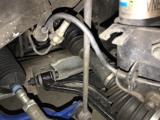

Locating the connection plug to wheel sensor.
wiring into the rhs engine bay.

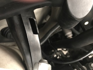

Chasing the wiring up inside the engine bay at firewall, this casing houses the wiring loom, easy enough to pull a part and expose.

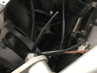

Straight forward here clip the new wire to lenght and break into the existing abs wire that follows onto the ABS module.
I wont bother you with my soldering attempt i can be some what hit and miss with my attempts, however I successfully integrated the new wires into the loom.
