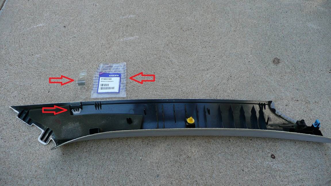

Can someone confirm for me this is the correct PN for my 2006 S60?
Thanks.
PS: FCPEuro seems to say this only fits 2007-2014 XC90?
https://www.fcpeuro.com/products/volvo- ... vo-8616658

The page you linked at FCP says "Fits all Volvos" not "only fits 2007-2014 XC90." Seems pretty hopeful.

e.g. https://parts.smithvolvo.com/p/Volvo_20 ... 16658.html
The evidence is pretty good, maybe worth a $6 risk.

Update,MadeInJapan wrote: ↑...Volvo Ticket clip part number is 8616658 or 31403186...
Bought the "Ticket Clip" PN 31403186 ($5.70 @ FCPEuro) for my 2006 S60, it is a perfect fit...
