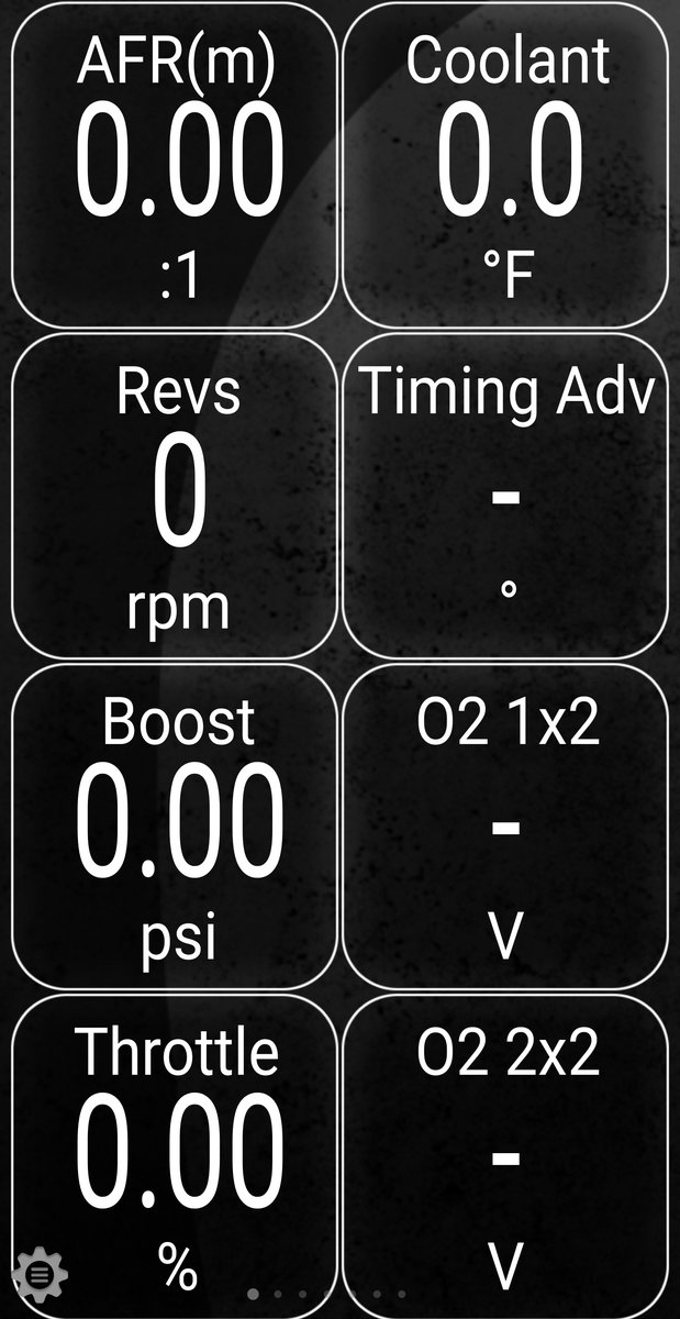

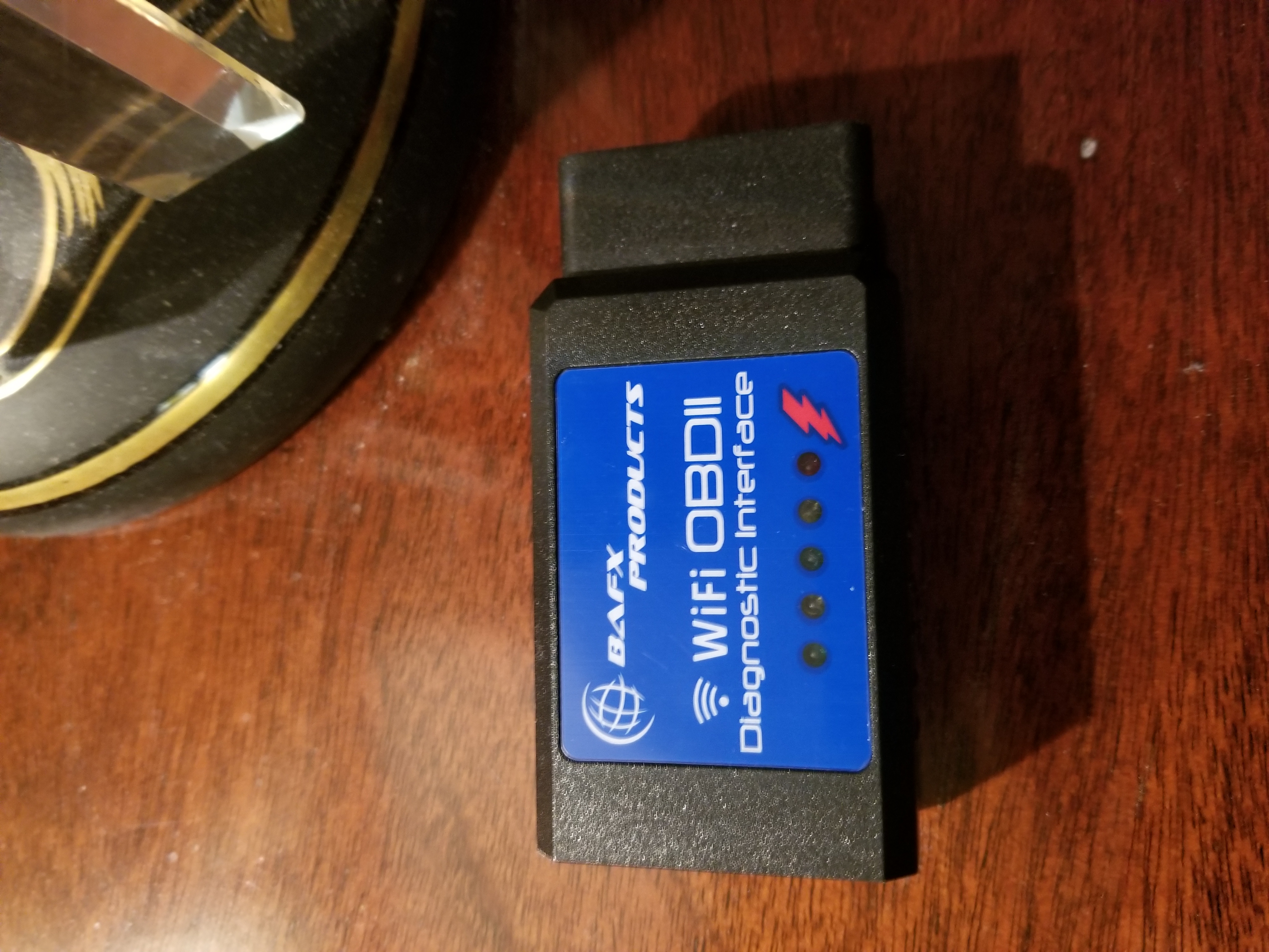

Ok, the gizmo came and I downloaded the app recommend by the gizmo's manufacturer. I was shocked to see how well the cooling system handles heat removal. In my cars case; today I drove for better than a hour with ac on and the coolant temperature ran between 188.6° and 192° and even during a period where I drove hard 199° was as hot as the temp got and quickly dropped back to the 190° range. Attached is a photo of the $25 gizmo and a screen shot of what I selected to monitor. The app "Torque" was another $5. Dont forget guys if you want to order such a gizmo on Amazon to use the MVS link!June wrote: 29 Dec 2018, 20:59This is a great idea! I ordered a similar model on Amazon today. Being as the temp gauge on the dash is useless in seeing temperature changes. Much less Volvo really screwed the pooch by omitting a boost gauge! Apparently with the right app boost among other things can be monitored.precopster wrote: 02 Nov 2018, 01:09

One thing I found interesting was seeing vacuum/boost on this car. With the two turbo chargers boost is instant feeling and now I know in fact it is physically. I also was surprised to see how high the boost pressure is at times. Also interesting to see the other sensors readings in real time. So $30 well spent! June
