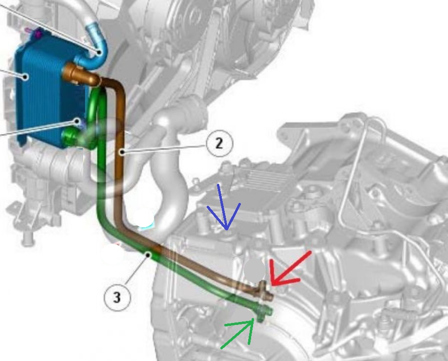

When I flushed my LR2 I used the modified Gibbons method (I am pretty sure that this would work on my 2010 S80, but I just bought that car so I only did a drain and fill, to understand why read Jimmy57's post above)
now back to the Modified Gibbons Method......
Red arrow - don't remove this pipe it will make a mess
Blue arrow - the actual T55 fill port
Green arrow - remove this pipe (held in place by one Torx bolt) and attach an extension hose, put the hose in a bucket and have a helper start the engine, the fluid comes out very fast, in about 10 - 15 seconds you will get air bubbles, turn off the car and add fluid to the fill port (blue arrow), flush as much fluid as you want using this method.
Don't forget when your done to set the level the T30 and snorkel must be installed then the engine turned on, with the vehicle level only then can you remove the T30 to check for dripping. (Per the manual its suppose to be 50C or something, I just make sure that its warm)
