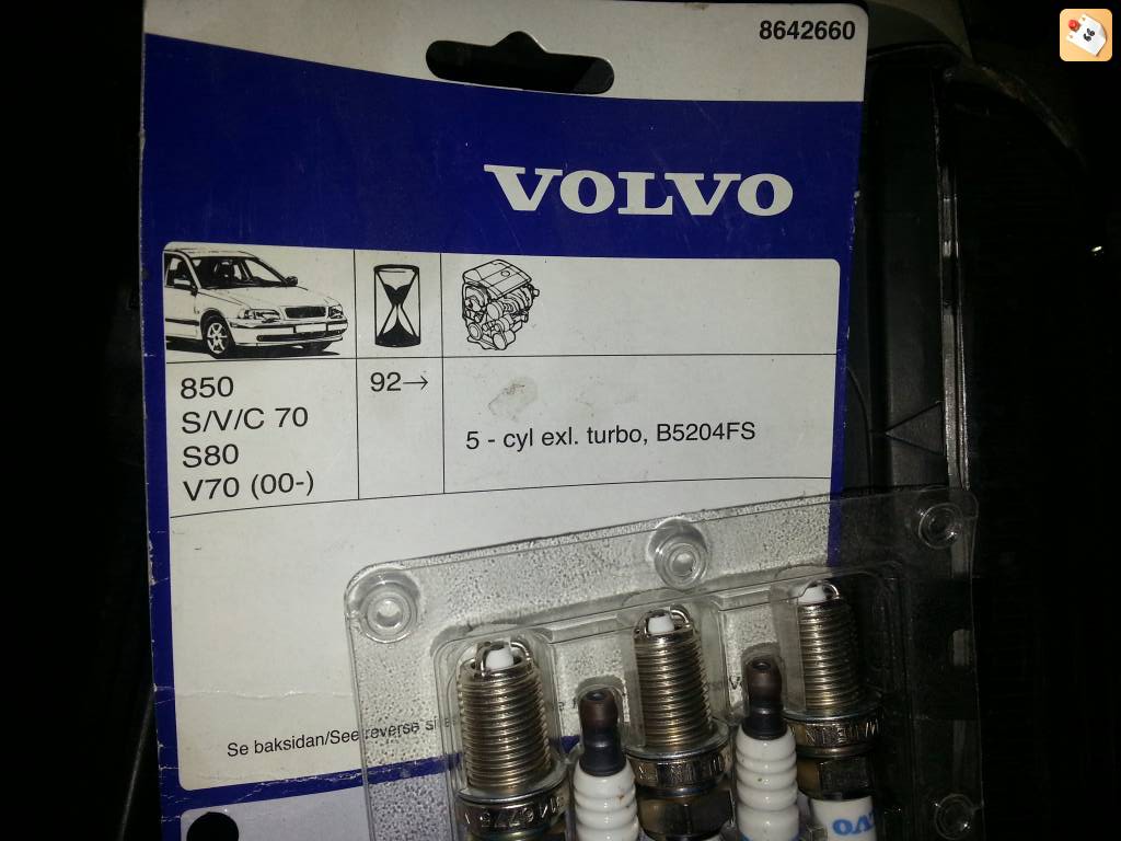

Rotor button, cap and plugs should be thrown and replaced. The non turbos should take the triple electrode plugs as pictured. I've used turbo plugs (single electrode) in non turbos and the electrodes seem to have an accelerated wear rate and need replacing more often
Other manufacturers such as NGK also have equivalents to those plugs pictured such as BKR6ETUC

Hey guys! Small update. I've ordered new OEM sparkplugs and a new fuelfilter to begin with, since they are overdue. I've observed some details concerning the hiccups.
The engine hiccups after long drives, only on a warm engine.
The hiccups only occur between 1000 and 1500 rpm.

So today I finally changed the plugs, rotor and cap. The sparkplugwires are relatively new (5 months old) so I didn't change those. Most of the hiccups/stutter vanished with installing a new battery (I did that two weeks ago). After the tune-up I drove her around for about an hour and the entire drive was without stutter.
So I think that the issue is solved! Thank you guys for giving me advice on tackling this issue!
