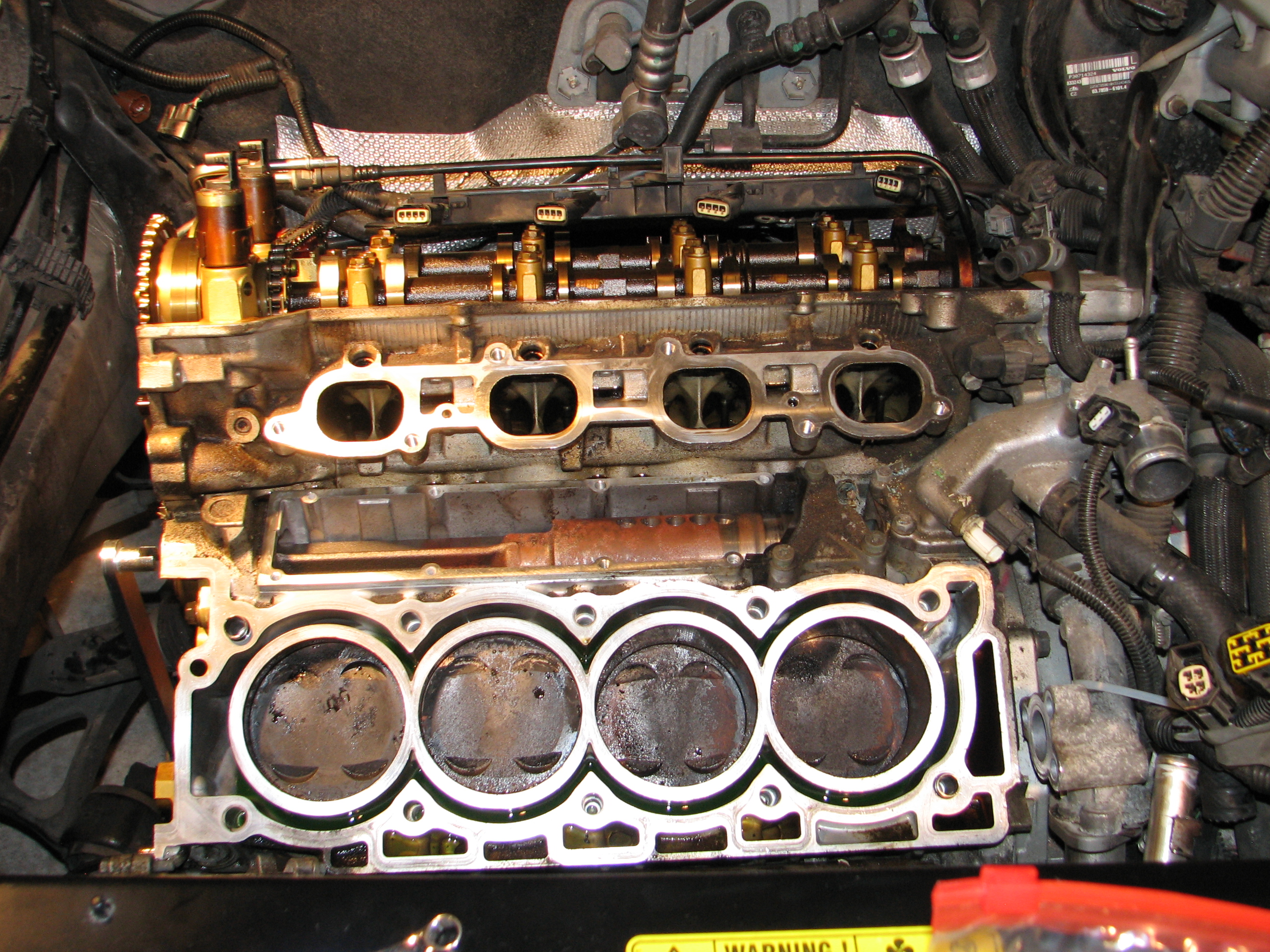

I made good progress today! Thanks for the advice about getting the head bolts loose. I now have a shiny new 3/4" socket set, plus an adapter to fit the 14mm 6-point socket that fits into the head. That, a 4' cheater bar, and a 12 year old helper to keep things steady at the right time, and I was able to break them all loose. Head is now off. Hooray! Here it is with the head off and the balance shaft cover removed.

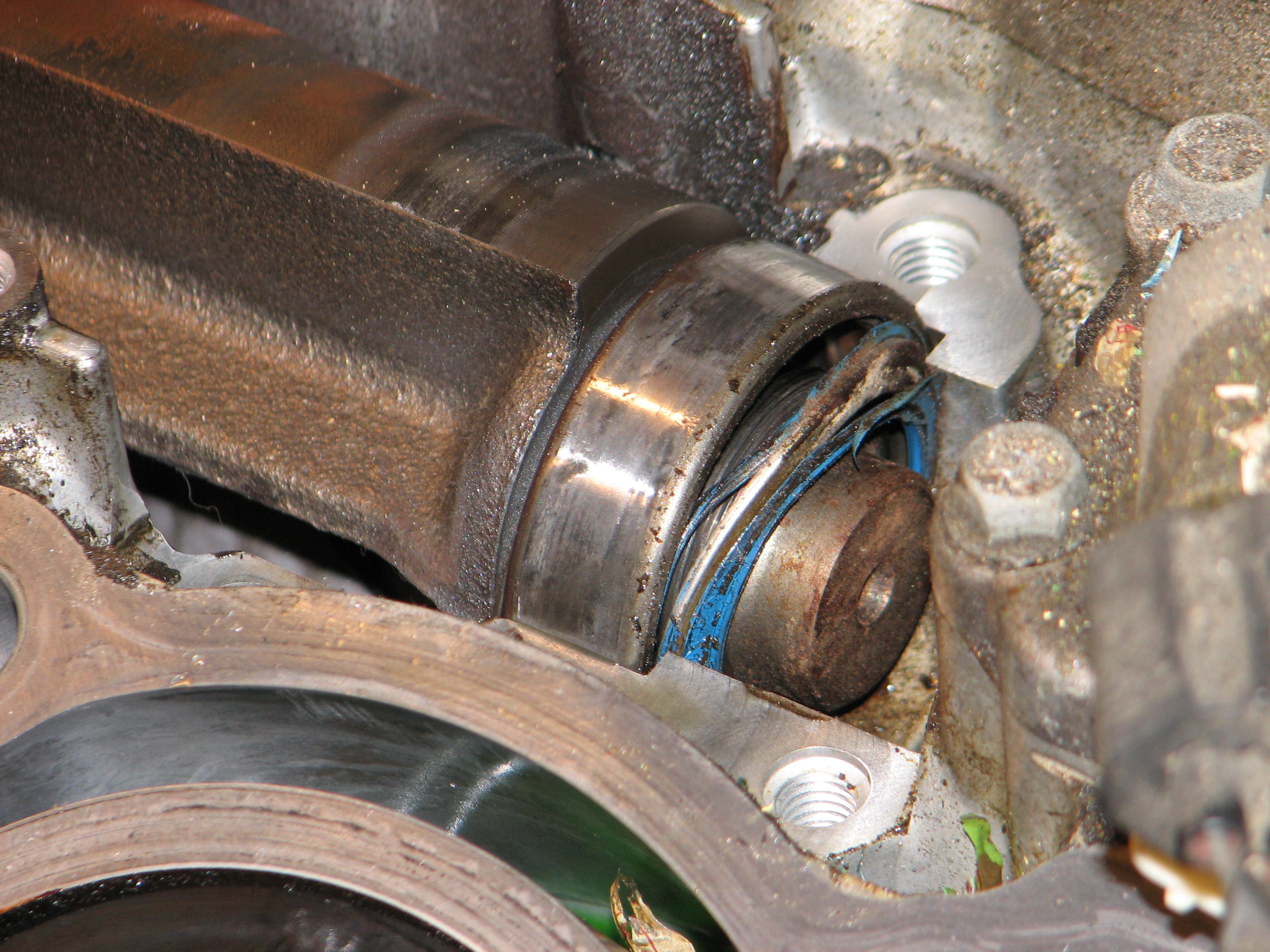

As expected, the rear bearing of the balance shaft is a shambles. Some (but not all) of the balls are missing from the bearing. I can see where water gets down the back of the bearing.

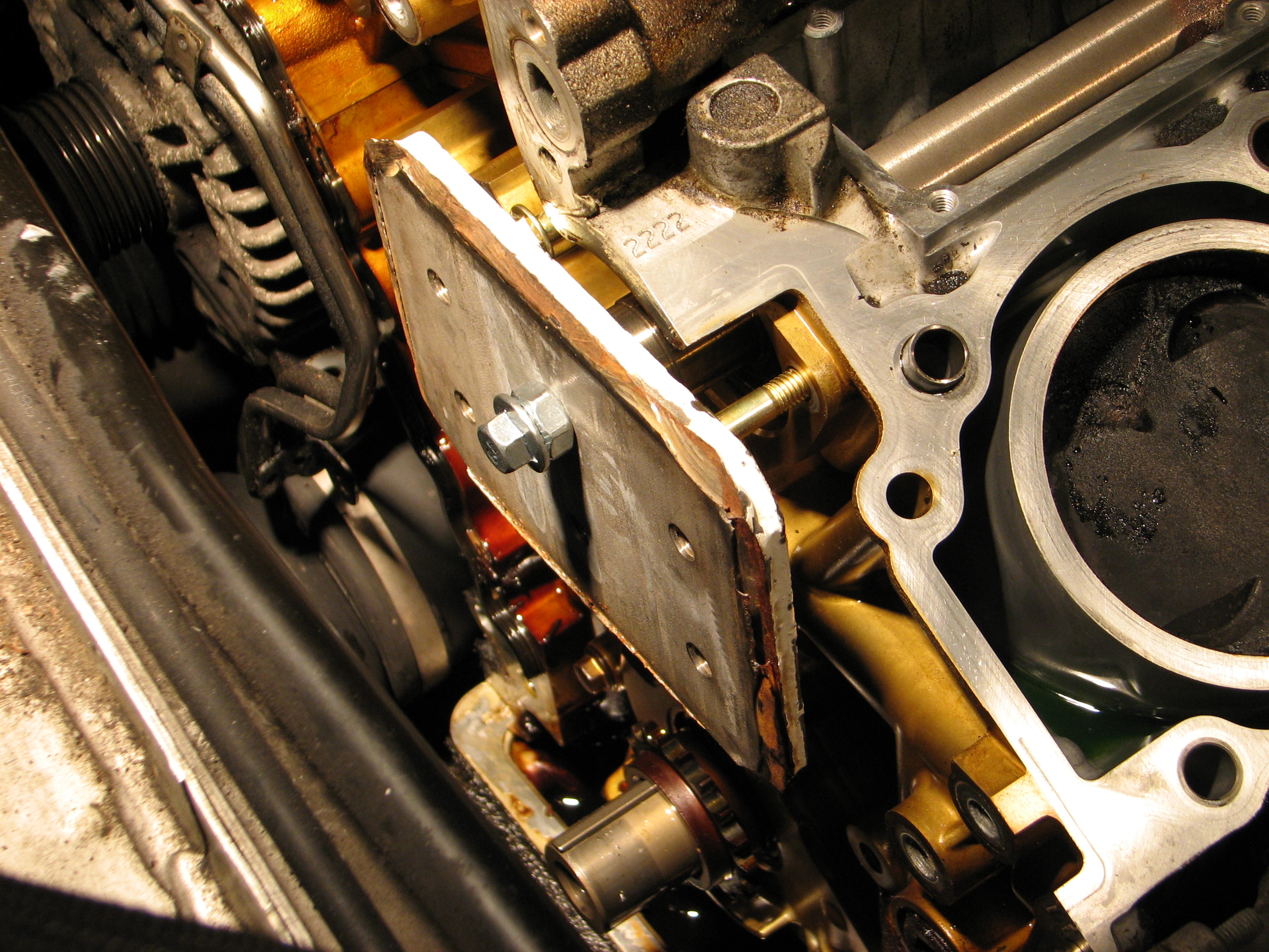

The bearing was very tight and did not want to move. It took two trips to the store and three attempts before I was able to come up with a puller that was stout enough to move it. I ended up using a piece of 3/8" steel I had around from a different project, perched atop three M8.0 1.25 40mm bolts. For reference, the bolt in the balance shaft is 10mm 1.25 pitch. Here's what I ended up with:

One question I'm trying to figure out is if I lost some ball bearings or not. There were certainly gaps between the balls, suggesting some balls were missing, but then I looked at the front bearing, and it has a framework to hold the balls a fixed distance apart. If the framework is what became the metal shards I fished out, then perhaps I have all the balls. Otherwise, I have no clue where they went.

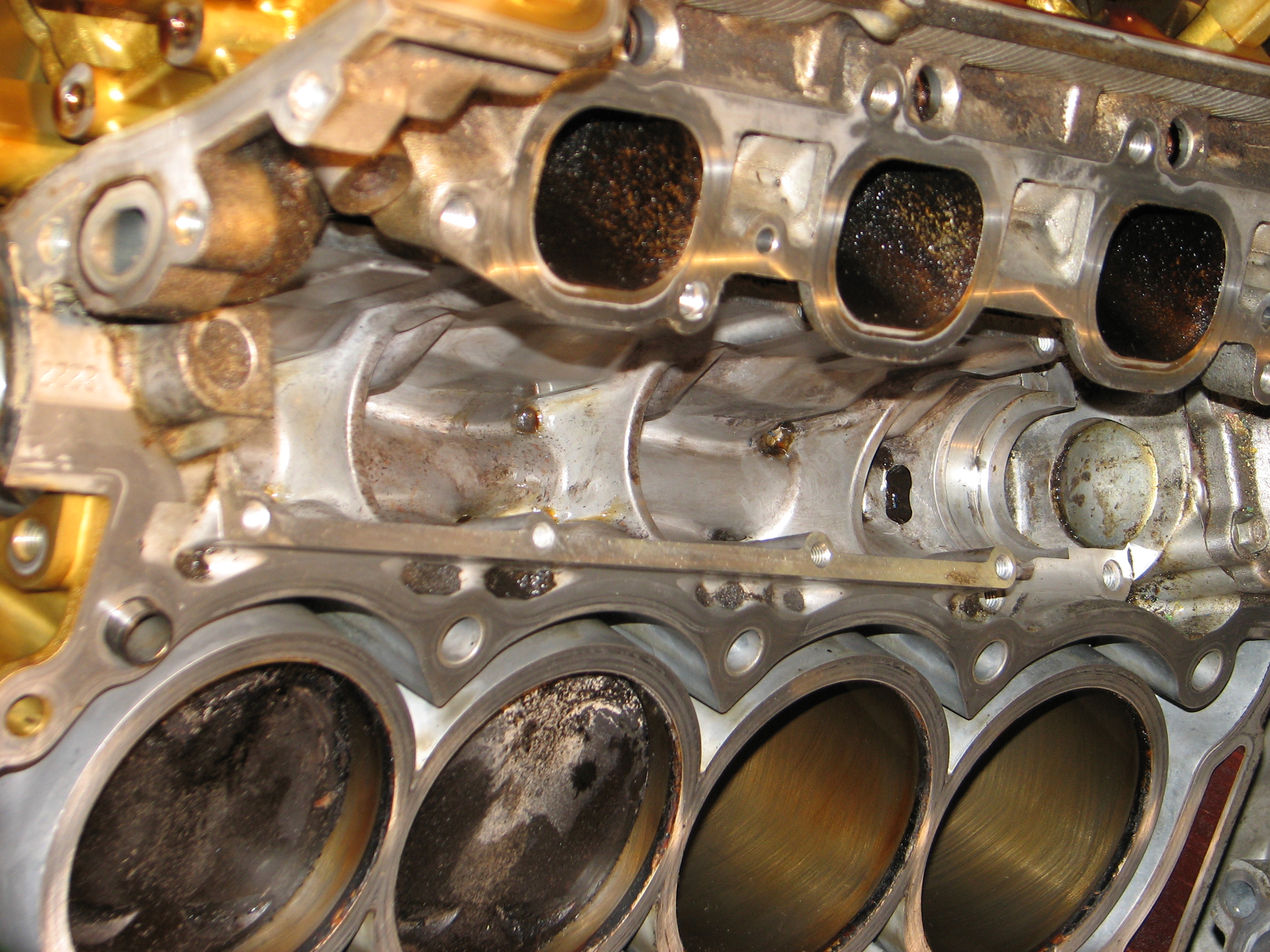

Here is the balance shaft space after I've cleaned it up a little bit.

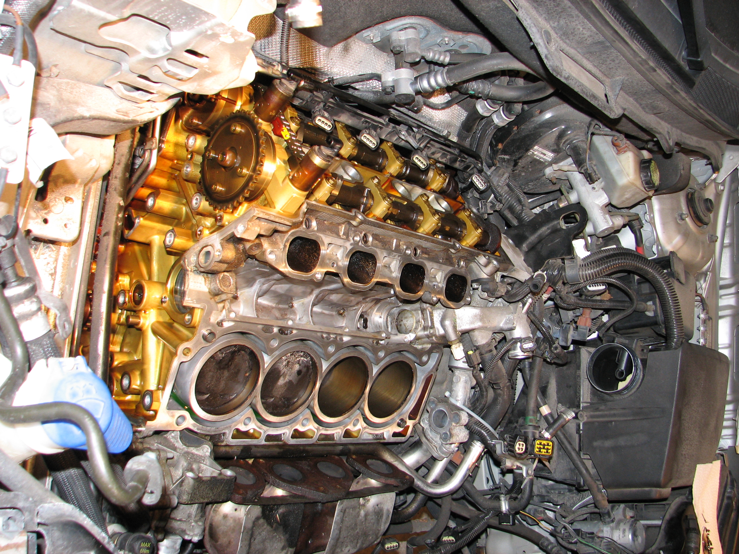

Also, for general reference, here is a nice wide angle shot of the engine bay with everything all out.
I still need to get the remains of the back bearing inner race off the back of the balance shaft, but it looks like the balance shaft is in good condition and can be re-used. (Some slight surface corrosion, but no notable damage. Then, assembling a parts list and sourcing them.

The Volvo tool for install is a drift with that m10-1.25 thread pin. You screw into onto shaft and pull bearing on and it is drilled in center for a pusher bolt on three holed triangular plate that is held by three longer M8 bolts. I might suggest a piece of pipe close to the same diameter of bearing outer race and 5/16 to 3/8 tall. The shaft doesn't stick proud of shaft much but you need dowel pin height too so maybe more than 3/8". A thick fender washer and a 25-30 mm long bolt as appropriate with center drilled enough to act as push bolt seat. Your same plate with appropriate long M8 bolts and a pusher bolt with nut on inside of plate. I don't think you can jack engine up enough to get hammer swing room for "pressing". The wisdom of hammer blows is to be questioned too. I'm not sure what info you have or how well you can make out what the tools look like in VIDA or other repair info. Not trying to step on your toes.

For pulling the shaft in, I'll probably drill some holes in the plate I have to line up with the bolts, then use a carefully selected socket (to have an OD slightly smaller than the bearing) as a drift to pull it in. I have a collection of 80mm M8x1.25 bolts that should work nicely for that, I hope.
