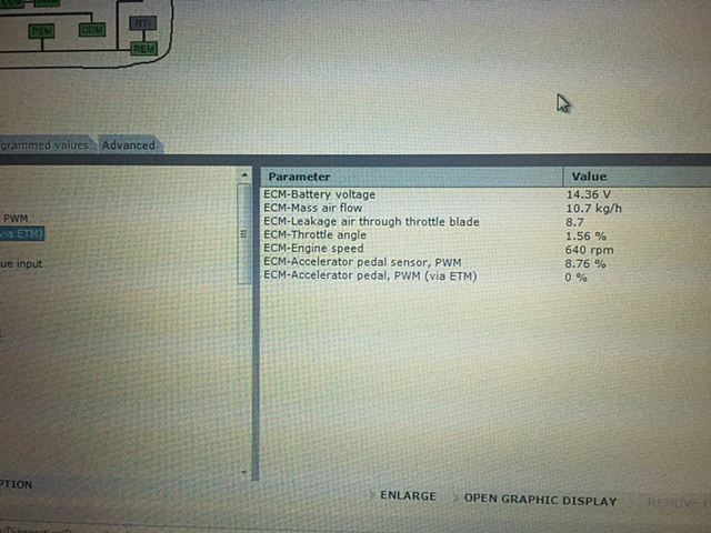

Unless you read it otherwise, ETM data appears to have settled after adjusting to recently RESTORED CRANKCASE, i.e., PCV overhaul.
MAF value is close to Fitness (Normal), i.e. 5-10 kg/h.
What is Leakage air through throttle blade 8.7?

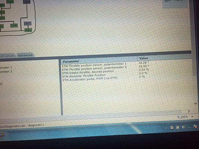

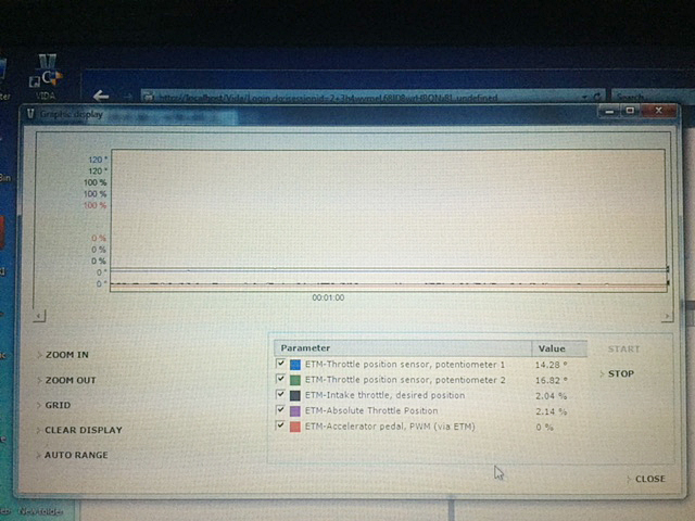

There is no IACV and the butterfly doesn't fully close so I conclude it's the air used to keep her idling. I got nearly the same readings on the new ETM I just installed.
ECM-Leakage air thru throttle blade - 8.8
ECM- Throttle Angle - 0%
ECM - Mass Air Flow - 10.3kg/h
The engine was warm at 186f and was in park.

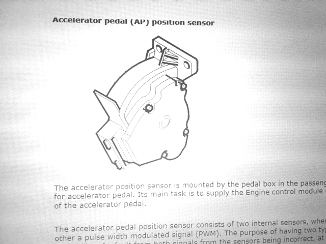

Meanwhile, found following in VIDA. It too is integrated with the gas pedal.

ECM-9180 & ECM-959F Accelerator Pedal (AP) Position Sensor - faulty signal.
VIDA says to check CAN communication fault for 9180 & 959F for possible weak battery issue. Freeze Frame data confirmed strong battery (battery was plugged to a constant charger).
EingeeringBloke, you're right. The sensor is integral to Accelerator pedal, part number: 30683516. Being used to '97 850 NA, it is indeed a wired and different beast.

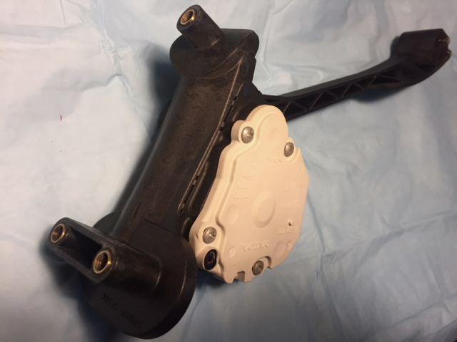

Taking a look for any visible sign at the sensor itself. Can it be tested and repaired?
Unplug at sensor. Clip the zip tie and tuck away the connector. You will need extension to reach the two bolts above -- removed three 10mm 6Mx1.0 long bolts. All three had RED thread locking sealant - takes some effort in tight place with contorted limb. Once unscrewed, pullout each bolts - be careful with wires.
