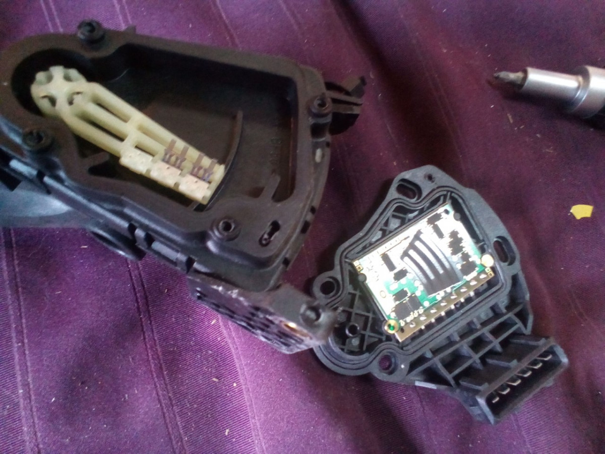

Jumping RPM is i believe the ETM or the early years pedal was also brushed. I changed both my ETM and pedal to contactless to avoid these issues.
- pedal swap
- pedal swap.jpg (38.31 KiB) Viewed 3279 times

Ty! the pedal has 10,000 miles since replacing it January 2019, so suspecting ETM.darrylrobert wrote: 05 Sep 2020, 21:56 Jumping RPM is i believe the ETM or the early years pedal was also brushed. I changed both my ETM and pedal to contactless to avoid these issues.
