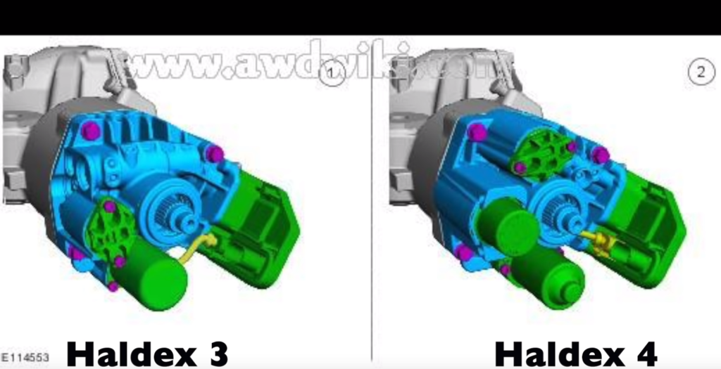

abscate wrote: 22 Feb 2019, 13:10 Is that one of our users' channel??
A member of VOLVOSWEDEN made that video.
Note that he's servicing a Haldex 4 which has a different location for the AOC filter. Our P2s come with Haldex 3 which has an easier AOC filter to access.
