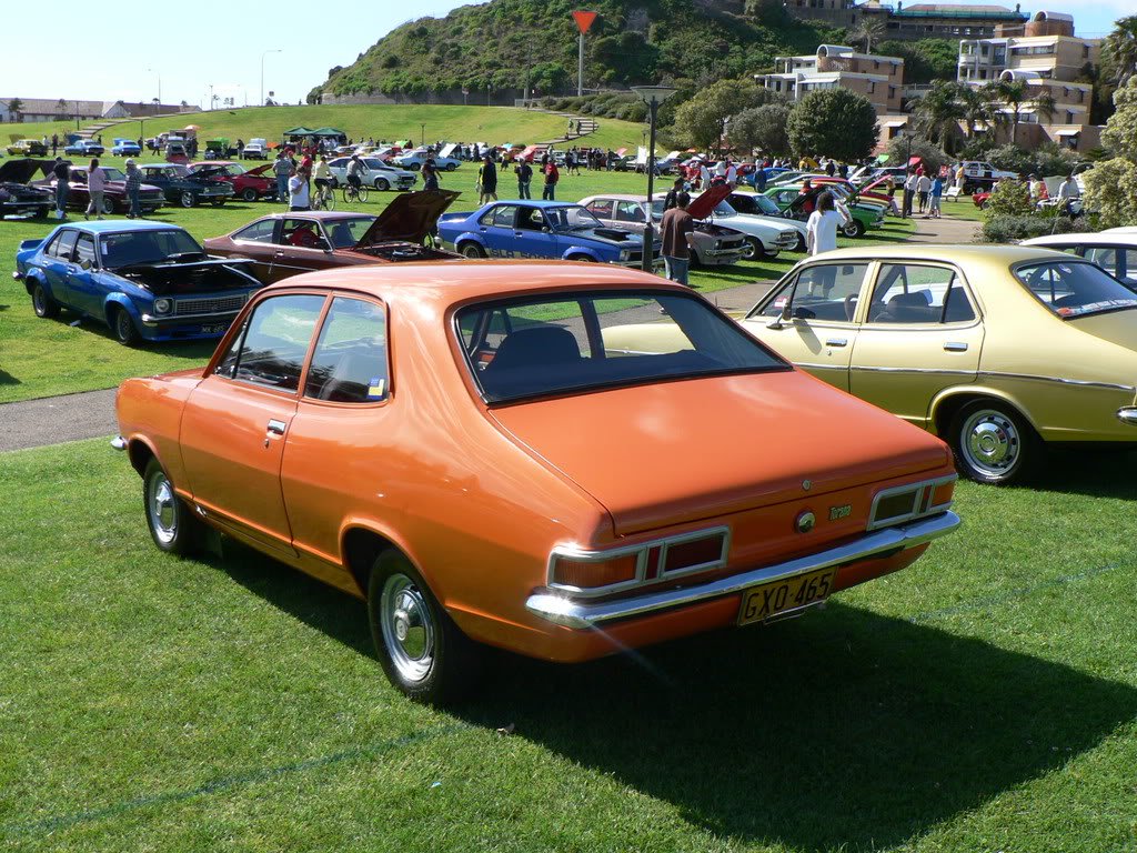

About 30 years ago panty hose twisted and the knot burned together with the cigarette lighter is how we made it about 200kms without an alternator. We ran into two old ladies on their way back from lawn bowls who gladly gave up a pair (not from their legs, though)
When that broke we started tearing up nylon seat covers and doing the same thing. The battery went so flat in 300kms that we made it into a town called Beaufort where a mechanic welded our alternator brackets back together. Car was a 1974 Holden TA Torana with a 1600cc Dodge Colt engine and 5 speed Mitsubishi manual trans (in our market was called a Chrysler Galant)
Once you learn how to burn the knot your home and "hosed" haha
