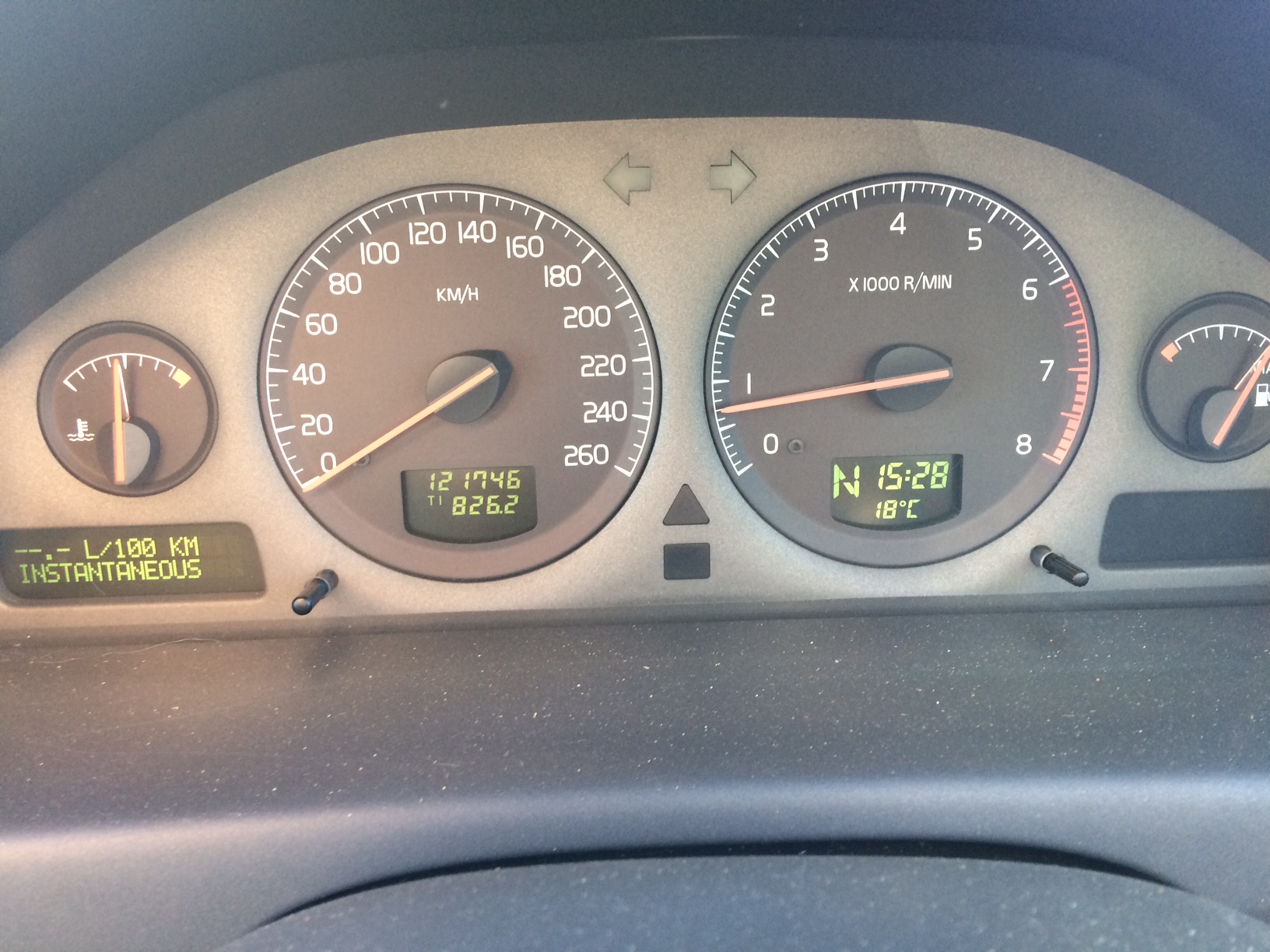

Hi all! Feeling much better today, I decided to do some work on the car. None of my parts have arrived yet, so I thought I would double check the tcv hose routing, and also check the wastegate base setting.
You may recall one of my problems is surging on acceleration which is why I wanted to check this. The TCV is plumbed correctly.
Next, to remove the turbo heat shield. Can I just say what a monumental PITA it is to get the bolt with the spring on it undone in a RHD car! It involved me kneeling on the engine and awkwardly using a flexi head ratchet over a very small arc approximately 1000 cycles... Anyway, the wastegate was set to about 0.5psi instead of the required 4.4 for my B5234T3 engine. This required about 3 turns of shortening (plus another half for luck!). Put everything back together and test drive time. I needed to go do the recycling and garbage run (no kerbside collection in these parts) so a good excuse to take the Volvo.
Surging was still evident but not as bad. I figure the ecu needs to do some learning since I fitted a new TCV and have fiddled with the wastegate setting.
On the way home this happened!! This is the second time this has happened since opening the BCM up. The car also behaves VERY differently when the brake warnings are gone, and several of my own questions have been answered. In my brake failure thread, I asked about speed signals to the TCM, PCM, and DIM and whether they take different data paths. I asked because I DO have normal speedometer indications and normal transmission behaviour (which is something a lot of other posters with ABS faults experience differently eg. limp mode and no speedometer). My live data stream on my CAN/OBD scanner however, had an absent speed signal which led me to believe the PCM gets its speed signal from the BCM via a different path. After the lights cleared, I DO have a stable speed signal on my scanner. The other question I had was “does the abs fault prevent torque converter lockup?” And in my case it’s a YES, and very obvious when compared to driving without the fault codes present. I now hypothesise that my surge problem won’t go away or the ecu can’t learn properly until I banish the ABS fault permanently.
