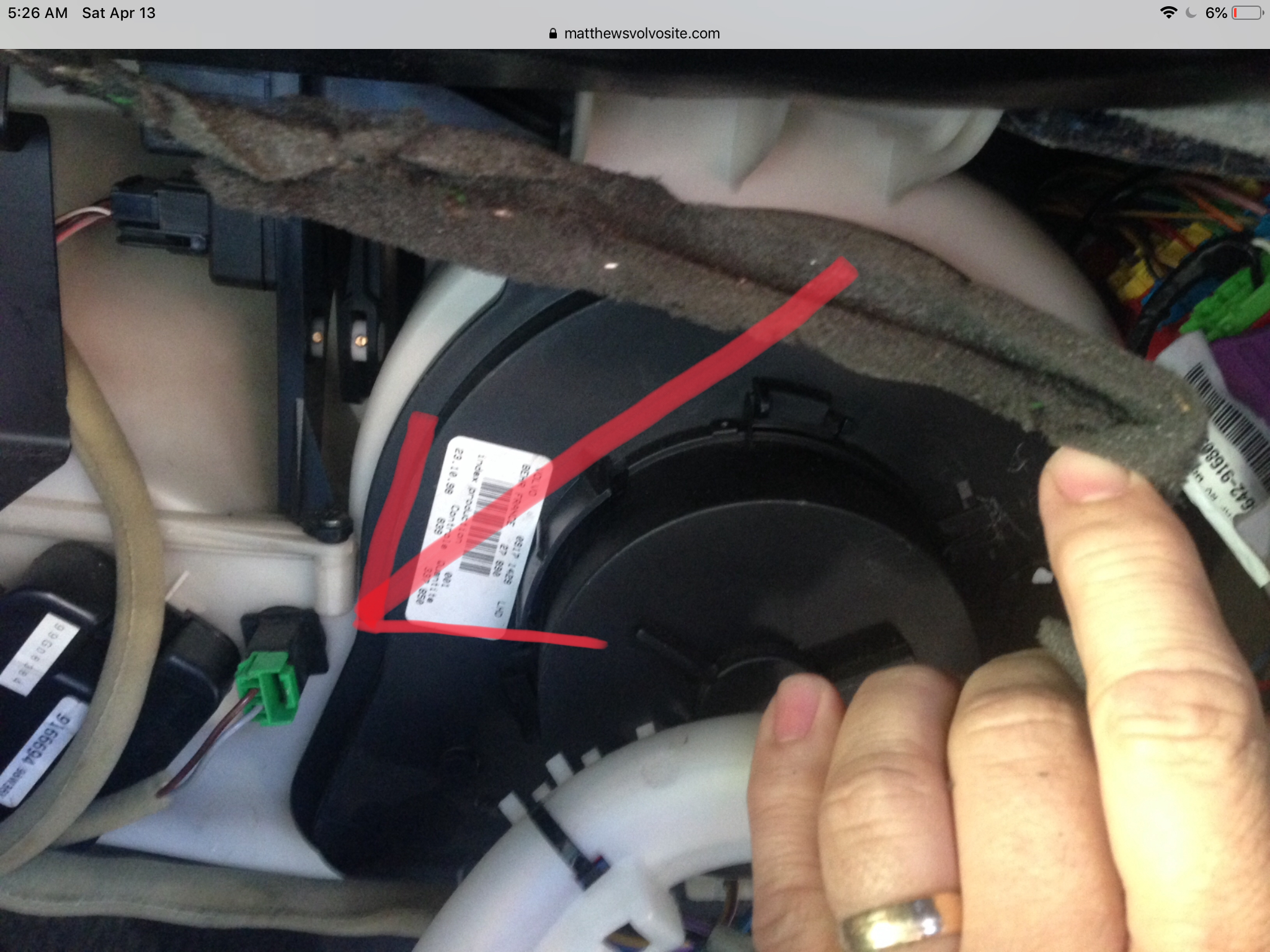

On ECC systems there are two places the climate air is monitored.
On early P80s there were fans up near your head I the headliner that suck in air with a tiny fan , they are thumbnail size and have a little grill on them. In 1998 they moved to the dash, right side of key , in the switch strip. Look for the grill, vacuum out any dust in there, that fixes a lot of climate Systems
The other monitor for temps is not the MOSFET but asensor just upstream of that which plugs into the white climate system. I think you can see it in this picture, red arrow
