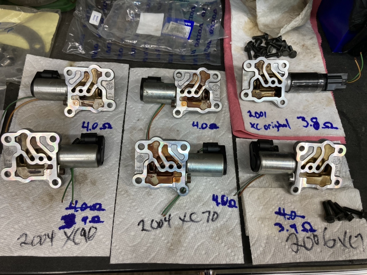

It was a combination of timing being just slightly off and (what I believe to have been) a flaky and/or gunked/sludged up exhaust VVT solenoid. What’s weird is that after I’d cleaned it as best I could (2001’s had what they call a “non-serviceable” VVT solenoid that didn’t come apart), the bench test showed it seemed to behave in a manner I couldn’t find a whole lot of fault with. Even comparing it to a newer “rebuilt” serviceable-type VVT solenoid I couldn’t detect much difference. It even ohms within what I’d call an acceptable range.
Regardless, between the new solenoid and (after several attempts) perfecting the timing, all symptoms and codes of that nature have gone and not returned.
The original “non-serviceable” VVT solenoid is top-right in the photo.
