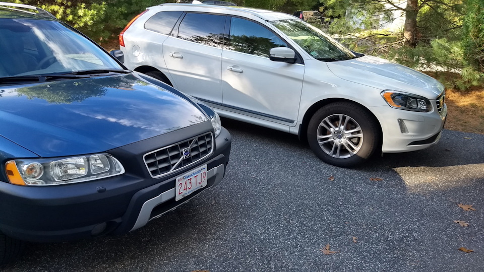

All plastic trim to restore has to be cleaned and degreased. If you wipe it over a silicone stain - it won't do anything.MoVolvos wrote: 30 May 2019, 13:18Interesting? Reviews in Amazon and Walmart does have complaints that it does not last perhaps from not decreasing or allowed it to cure properly.
My bumpers were shining for a couple of months like they were treated recently with a silicone spray, but eventually turned to a matte finish, pretty much like it was when new. And they stay like that for years.
Wipe New and Lamin-X headlight lens film are two best thing I did for the appearance of the car. I abuse the car taking it to nowhere, the bumpers don't care.
This was in 2016, and the trim still looks like on the pic:

Nice! A picture is worth the price of purchase. Haven't seen that clean of a bumper on a Volvo in awhile. Maybe it's the contrast to the nice blue shiny paint

Thanks!MoVolvos wrote: 30 May 2019, 13:42 Nice! A picture is worth the price of purchase. Haven't seen that clean of a bumper on a Volvo in awhile. Maybe it's the contrast to the nice blue shiny paint. I will see how the 303 (30306) Aerospace Protectant I had used for the first time hold up. Then again maybe be done with it one time for awhile?
One more thing to mention: Wipe New fills the pores and restores optical conductivity to inner layers of material. If it can't leak inside the plastic, it won't be able to do much. I can guess that it won't work well on previously repainted plastic without some serious degreasing and washing.
