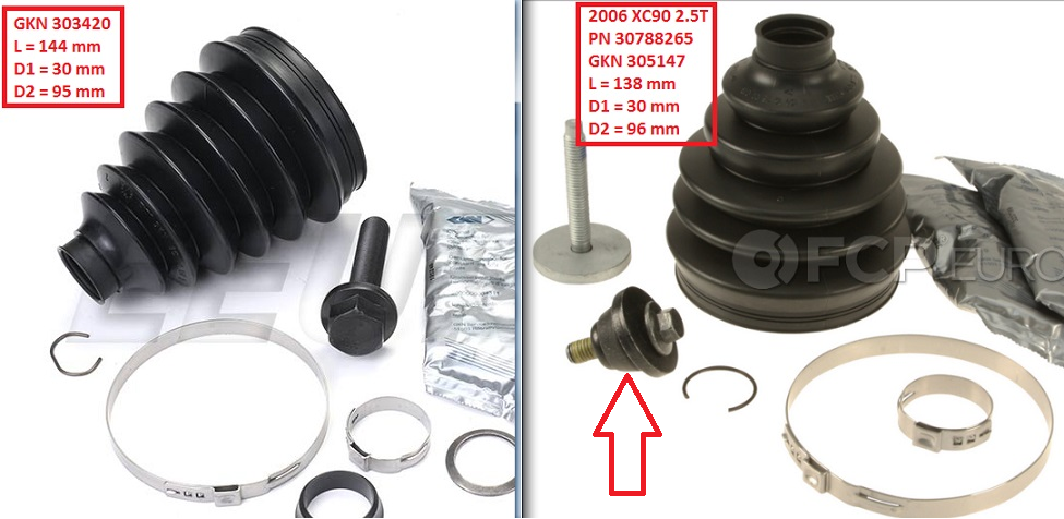

cn90 wrote: 29 May 2019, 23:02 I was looking at 2004-2006 XC90 2.5T Outer CV Boot, from what I researched:
- It is still made from rubber.
- The dimensions for XC90 (right in the photo, dimensions are not certain, I got the dimensions from some websites...) are very close to the S60, V70 (left in the photo).
I personally think XC90 CV Rubber Boot should fit the S60/V70.
- Can someone call FCP to see if they can get one of each and physically measure them for us, and post their measurements?

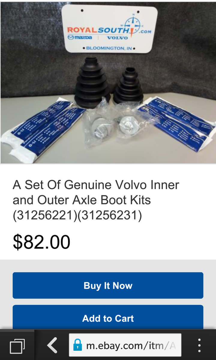

Well, for Volvo 31256231, the photos I see from the web showed plastic, maybe I am wrong.
Volvo bought the part from GKN.
I wonder if the Volvo employee in the parts dept knows the difference btw plastic vs rubber!
The whole kit (Inner and Outer) PNs are 31256221 and 31256231. Picture from dealer listing on ebay: one plastic and one rubber according to my eyes...
