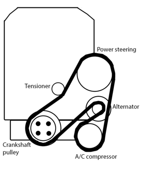

btw. for my 1999 s70, I am using this serpentine belt routing. I lost my l diagram I drew when I first took it off to do my AC shim fix but I believe it's correct. Can someone confirm with more experience than I?
A lot of "s70 serpentine belt " searches show my the 850 and pre-99 routing and that's different.
Below is what I am using.
I have already taken my alt out again so I can't fire it up and watch the direction of spin but I believe this routing will spin my alternator counter clockwise. I verified that is correct with the arrow on my alternator.

Yes. If you don’t have a tool use a strong cord and put the belt onto the ps pulley last, the bigger the pulley, the easier it is to slip a belt on it.

I do have a nice serpentine belt tool now. I battled with using my breaker bar and actually ground down my torx socket because using the breaker bar with the socket was really too long.
When I did my AC shim fix job, I cursed enough times that I went and bought a proper thin serpentine belt tool. Makes a world of difference.
However, I had to buy a new T60 because now my ground down T60 was really too short now. Figures.
But the thin serpentine belt tool works so much better than my breaker bar did. The breaker bar was just too short (oddly enough) and too thick for the narrow clearances.

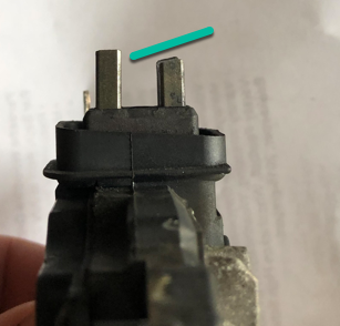

Here a quick update on this issue.
Car is back on the road. Here's what I did.
1) replaced all + battery cables. Did not resolve issue. I didn't think it was going to.. I replaced these because of so many people recommending doing this on a 20 year old volvo. I also realized that my positive battery terminal had already been replaced and I didn't like the style.
2) took alternator out and verified what I could. ie: diodes worked, no shorts, and slip rings* all passed tests.
3) got new voltage regulator.
That seemed to do the job. battery now reads 13.9 V while at idle so the alternator is putting out some juice.
The slip rings were less than ideal. At least one was.
I posted this picture in another thread. As you can see, the brushes are of different length. However, the surprise was with the brush that is worn at an angle. I had noticed that when I took the regulator out but I didn't understand the full implications until I took apart my alternator.
it actually cut a sloped gouge into on of the slip rings. I don't like that. I have a new set of slip rings on order and will replace those in a couple of weeks. I'm getting good at taking the alternator out and apart.
Right now it works. The slip rings passed their continuity and resistance tests but they are definitely damaged.
I'll create a write up on that job.
But for me, what failed was my old voltage regulator/brush length.
