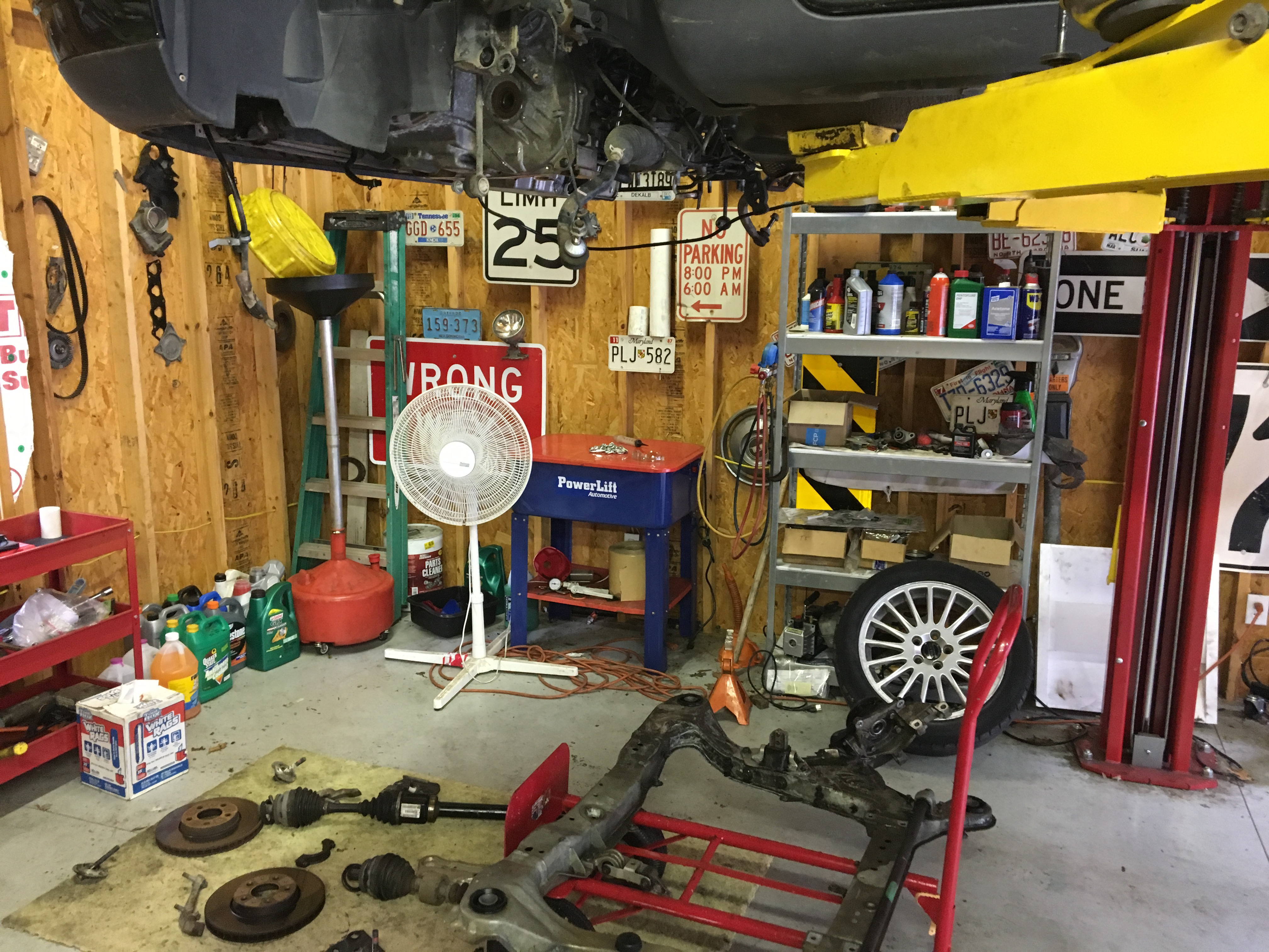

I was hoping to get the transmission out this weekend, but did not quite get there...
The Haynes manual provides decent instructions, though I wish they provided a lot more photos. In some ways it probably would have been faster if I had just gone in with the mentality of "what stay on the transmission and what stay with the car?" and "what is in the way of making that happen?" as the Haynes manual had me chasing some situations that were not present in my car but missed some that were.
The Haynes has you dropping one side of the sub-frame only, but once you get that far you might as well drop the whole thing to really get good access.
I should have it out in short order next weekend, hoping to find something really obvious....

That's quite a pad for a weekend get away or man cave. No insulation though in NC summer or winter? Is it about the same as here in RTP?

@MoVolvos, yes it is a luxury... and the older I get the more thankful I am to have the lift. I am in Winston-Salem, so yes, hot in the summer and cold in the winter. I just had to draw the line somewhere, the next steps would have been insulation, then you might as well throw some heat in there... AC while you are at it some drywall... well, might as well paint that...

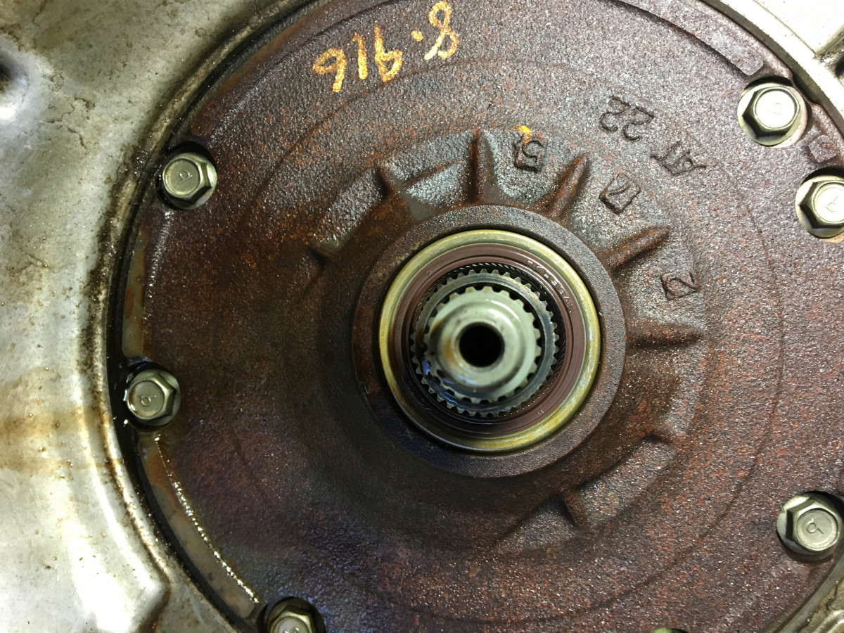

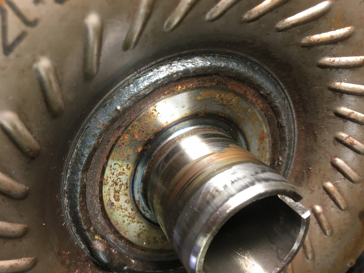

I go the transmission out today, and, as one might guess, there was no obvious defect in the seal. Photos attached.
Two thoughts, I should have cleaned up the torque converter shaft where it mates to the seal better. The car sat for a while before I got it, the TC was still engaged with the transmission, but it was somewhat exposed to the elements as the engine had been removed. There is some discoloration of the shaft, but no sharp areas.
The seal looked just fine, but I am not sure of the brand. I replaced it before I put the motor back in. I removed it and examined it. It seemed to be the correct fit for the TC shaft, though not particularly tight. I will get a new Volvo seal.
OK, three thoughts. I am seen "repair sleeves" that increase the diameter of a shaft to allow for a better seal, I think I have seen this for this application... not sure.
I would really like it if I didn't have to pull this transmission out again... but my only course of action seems to be to replace the seal, clean up the TC shaft and reinstall. Any other thoughts?
Thanks! John

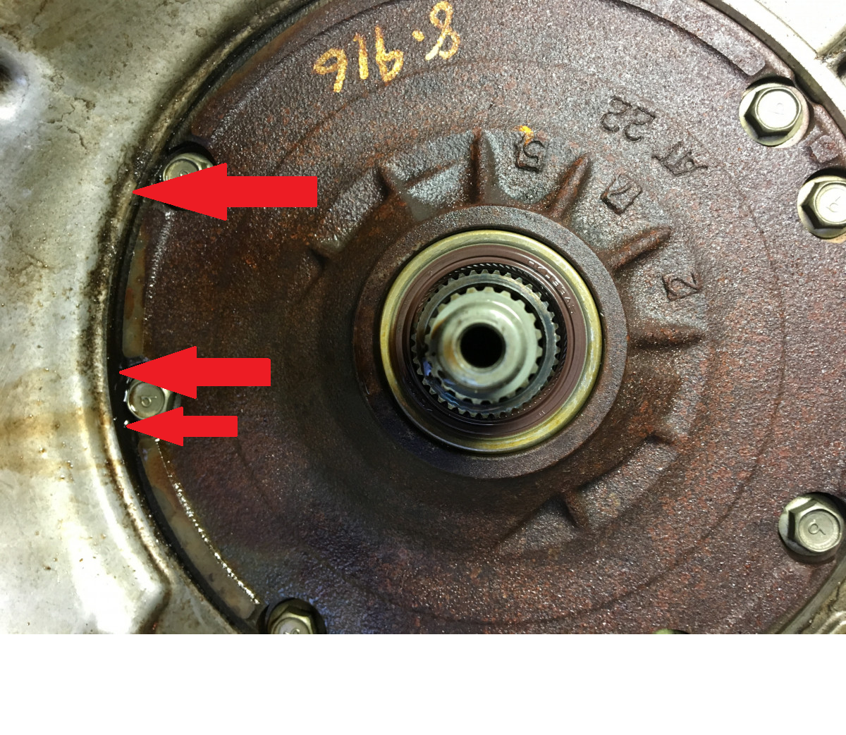

I'm wondering if the oil in the picture is a problem. Did a clutch job on a 78 Mustang II in 1981 and have never seen the inside of any transmission since so am not familiar with what I'm seeing.
Oil Seepage.png (2.53 MiB) Viewed 716 times
Posts: 35273
Has thanked: 1498 times
Been thanked: 3810 times
That should clean up with a fine emery cloth. It needs to be mirror smooth, or it will leak

@Mo, Funny how we try to find that balance between work/hobby/life. I enjoy working on cars as a hobby, might make it more if I can as I get closer to "retirement" age.
I thought about that apparent oil seepage too. When I pulled the transmission I was not able to keep the TC with the transmission so it dumped fluid everywhere. Once I wiped that area up it stayed dry, of course the transmission is drained and not running... but thinking that area would leak all the time some and perhaps not more when running... which is different than the leak the way it presented, but hard to tell.
@abscate good to know that there does appear to be an issue with the shaft. Easy fix there. I am going to give the TC a good look over again for any perforations, with the quantity of fluid leaking it is hard to believe it is just the sealing at the shaft. Really don't want to buy a TC, but might be rational to avoid going back in there. I wonder if a transmission shop can test the TC for leaks. It is functioning fine.
