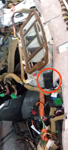

The damper motors are hard to access. This illustration shows where they are. I found it in this thread viewtopic.php?t=50525&p=251432 He did it without removing the dash. If both sides are the same when the airflow gets restricted it would seem to rule out the motors that only control one side. I don't think I would change them without removing the dash and as previously stated the best writeup is here: http://www.woodjoiner.com/volvo/VolvoEvapReplace.pdf
Here are pics of 2 of them to give you an idea.
I borrowed the pic of the left upper damper motor from this writeup. The pic of the passenger one is mine.
