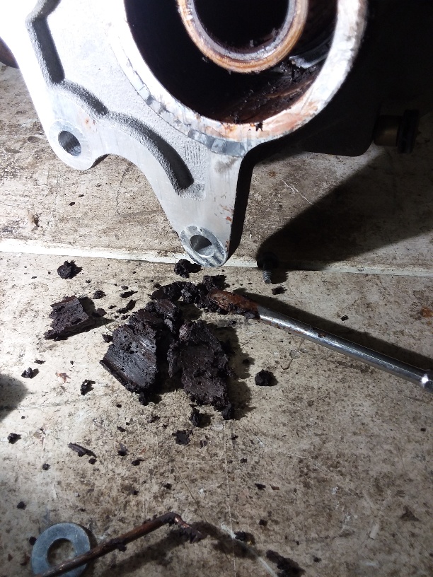

I opened the rear diff and it was dangerously low. In retrospect I must be wrong about the oil that leaked not being from the differential. Not having anything to put in it I had to improvise. I had this on the shelf so I used it.
Don't laugh, some oil is better than no oil and this will be good enough to drive it a few miles and then flush. It took 400 ml so I think it had enough in it to prevent failure, but I am glad I saw it and topped it off. I have some Amsoil severe duty 75-90 on order for this and the front angle gear, but it isn't here yet.

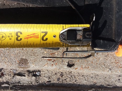

The front angle gear oil looks amazingly clean on the stick. I bent a hangar wire 90 degrees and the level was as shown. About 1 1/4 inches below the plug hole. I used an angle pick to mark the oil level in case the picture didn't show it.

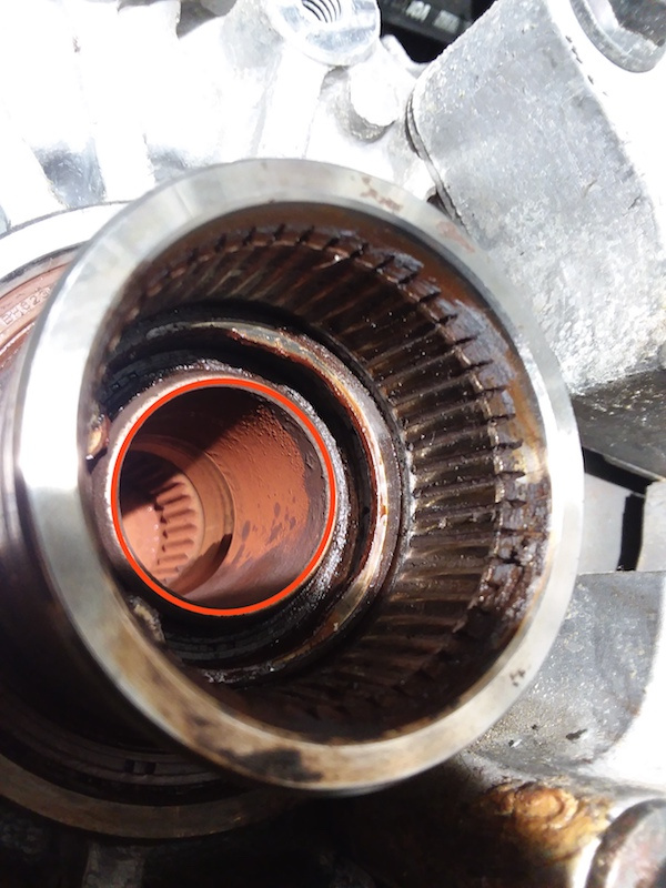

Yes, I changed the filter. The old one was very dark. I also did a drain and fill with 3.5 quarts of recommended transmission fluid and tested it in the air. Still no movement at rear wheels. Slid under and Haldex pump not running. I'm starting to suspect a loose connection at the box back there since it runs perfect when 12v is applied.
Update: I did some more research, got back under the car with it running in gear and discovered that the prop shaft to the rear is not turning at all. I guess I started at the wrong end and should be looking at the angle gear mechanism.

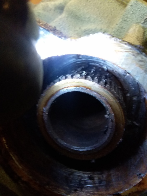

Well I've read enough to know this will not be fun. I'm going to sleep on it and probably start a new thread tomorrow, and link it here, about angle gear sleeve removal.
The red ring in the picture indicates what I shall set up a puller to push on. It does not look encouraging;

Well if that's the case it's basically down to your collar sleeve being shot and/or the input splines on the BG are eaten away. Seems they eat each other out & replacing both collar sleeve AND BG is the only real (long-term?) fix.
I really hope that's not the case for you. When you have the driveshaft out it's a great time to take the bevel gear off the trans to inspect the collar sleeve/BG input splines etc... You'll know if the collar sleeve/BG input splines are done for. There will be cakes & clumps of rusty shredded steel surrounding both & the splines themselves will be worn down to sharpened remnants, if they are even there at all that is.
Did you suck the gear oil out of the bevel gear? There is a chance it failed internally, but that's pretty improbable.
Funny, I just got a collar sleeve. In my area bevel gears range from $500-750 dependent on mileage & wear. Collar sleeves are pretty inexpensive. Hopefully you're not in for a collar sleeve, BG, Haldex pump & other associated AWD items.
I found a guy/place in the Netherlands (I think) that rebuilds bevel gears. I never did arrive at anything or final cost + shipping for one of his units but I sure wish there was one of him over here. Henk Brunekreef. All I've seen is one video & their website. Could be a sham, sure looks nice though.
You said your pump wasn't running also though. Obviously if the driveshaft isn't spinning that's no good. But your pump still should be running. Did you blow compressed air up there around & into the sockets were the 2 Haldex plugs/receptacles mate up? I've had tiny stones lodge up there making it impossible to fully seat the plug/receptacles.
Edit: I see you found your culprit. Sorry, I tried to respond faster. Make damn sure your BG input splines are in good shape before just replacing the collar sleeve.
This guy makes it look pretty easy. This is how I plan to remove the collar sleeve, when my time comes.
Ye ol' collar de-wizard's sleeve is toast, so use the internal snap ring groove for your puller.

135xxx. It does not look good.Splines are still there and the collar took most of the wear but I can see the ends of the splines on the gear looking taller at the end where they went past the collar splines. I won't know until I buy a collar and fit it if there is enough left to get me by for awhile. I don't know if that tool would even be an option with it still in the car though. I also doubt my local auto parts has one for rent. Any idea where to get it?

If the splines still have flats at the top on the BG input you could be ok for a while. With all the debris on there it's hard to tell from the pictures. If on the BG side they still have flats (the full length of the splines), just replace the collar sleeve. I think collar sleeves are about $115 or $120 for these XC's.
That seems like low mileage for collar sleeve spline's to give up. Wife have a heavy foot?
Our 280k mile 04 XC with original BG is still going. Not sure for how long though, the teeth are pretty sharp on both sides of the equation.
I'm not certain there is a rhyme or reason to why some fail earlier than others. What I do know is the metal on one side is crappy, fails, and that in turn causes the other side to also fail.
Collar sleeve is toast so no need to be careful with it. Worst case could weld a nut to a plate (that has a pre-drilled hole) over the end. Weld that nut plate to collar sleeve. Then slide hammer it out.
Ya might get enough bite on the snap ring groove with an internal puller setup.
