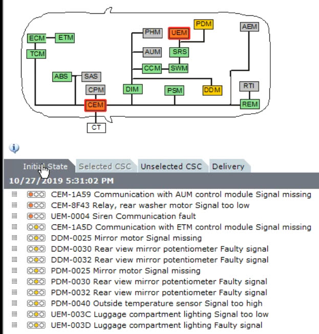

I just scanned the car.
First off, the starting fume is really stinky. Don't know how to explain it, it's just nasty.
In the scans, any light issue would be from all the LEDs I put in the car (low voltage).
Every interior bulb now has LEDs. Any audio issue would be from not having connection
to the steering wheel controls after installing an after market stereo in the car.
Before I scanned, the car started for about ten seconds and turned off, then started this way:
https://drive.google.com/open?id=1ULaoj ... tYAGsk77PK
I have a 10/27/19 scan and another one showed, I believe the current (11/19/19) scan.
I just did a simple scan. I was just cold for some reason, though I was well wrapped up.
My body was not just too tired to take the warm 31F, and I have been tired already. Being
a very busy day for me. So, all I did were initial scanning.
