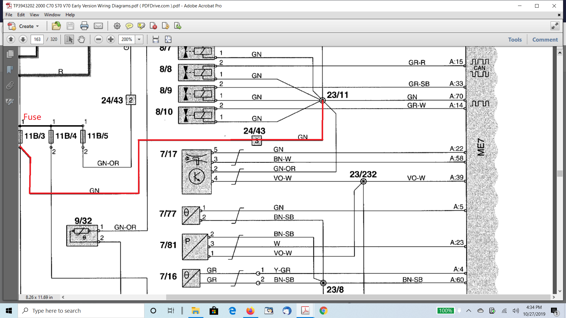

So the injectors and the MAF green wire is shared, both parts have voltage loss, so does that green wire go back to the fuse box on the shock tower or the main fuse box, also should i be tracing the ones going to the ECU since all the wires except green go there. i just got my emanual, trying to figure it out, its software form and is VIDAS,not easy for me to use.abscate wrote: 27 Oct 2019, 15:43 ME7 is the name of the ECU software
All of th MAF wires run to the ECU except the 12V supply which goes to a common Bus with the fuel injectors

There is no indication of anything wrong with the ECU
The battery voltage should be the same on the supply wire to both injectors and MAF.
If it isn’t, you trace it back to find the voltage loss using the wiring diagram.

All injectors read 12.5 ohms and the wiring plug for each injector reads 88 Mv, as does the green/orange stripe wire going to MAF plug
So if 23/11 is shared power node where is it getting it's power from, can't tell from the diagram. I assume 8/6, 8/7, 8/8, 8/9, and 8/10 are supposed to be the injectors.Is the power coming from 9/32 if so what does 9/32 represent

subzerocarfanatic wrote: 03 Nov 2019, 12:18 So if 23/11 is shared power node where is it getting it's power from, can't tell from the diagram.

If wires cross but don’t have either a dark dot or a circled X, they don’t connect.
You should be making voltage measurements, with the VOM on DC 12V scale

Thanks for the input, I have already replaced the B+ battery cable going to the main junction post in the relay box on strut tower, the 4 red wires, I removed them and installed a single 4 gauge wire, they were corroded very bad. The relay you speak of jumpering is it the main control relay? I am pretty sure red relay #103 is fine, i can hear my fuel pump on when key is on, it never had any problems starting.RickHaleParker wrote: 04 Nov 2019, 01:462019-10-27 (2).pngsubzerocarfanatic wrote: 03 Nov 2019, 12:18 So if 23/11 is shared power node where is it getting it's power from, can't tell from the diagram.
