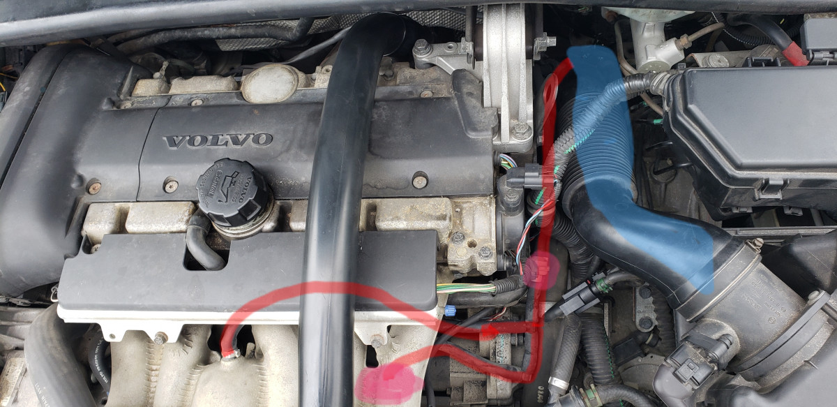

Red highlights follow the bad tubes as best I can. Magenta box on bottom center is some control valve I'm assuming, couple wire connectors on it (circular thing below leftmost red circle in previous pic). Blue line is air box, where the end of that vacuum (or pressure?) line plugs into.

This is a part of EVAP system.
Upper hose goes to the MAF-turbo pipe (always has at least a bit of vacuum), middle goes to inlet manifold (a lot of vacuum when not under boost), bottom goes to the EVAP purge valve.
Replace them with a silicon hoses. While replacing them, do a mouth-check of two vacuum valves: should not pass any vacuum in one direction (against the arrow).

Replaced lines and checked valves and all seemed well on that end. Also found most of the hoses around the brake booster vacuum ejector were loose, so popped off the old clamps and put new ones on and now that's all tightened up.
Didn't resolve the performance, but at least that end of things is in better shape. Going to track down a decent vac tool and see if I can find anything out on the turbo related lines, but that might be a few days.
