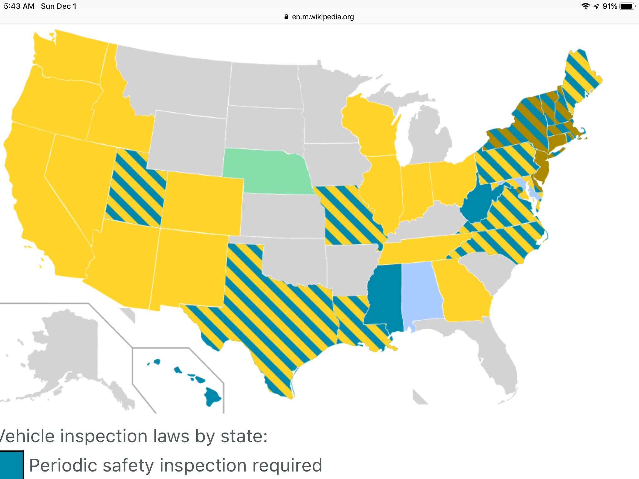

Just to shock the Swedish on this Forum..on the map below, the States without either solid blue or blue stripes...
...........Do not inspect cars at all.

Yikes.abscate wrote: 01 Dec 2019, 03:46 Just to shock the Swedish on this Forum..on the map below, the States without either solid blue or blue stripes...
Considering the rust buckets people get away with driving here even with inspections that's not a scenario I'd feel comfortable about.
