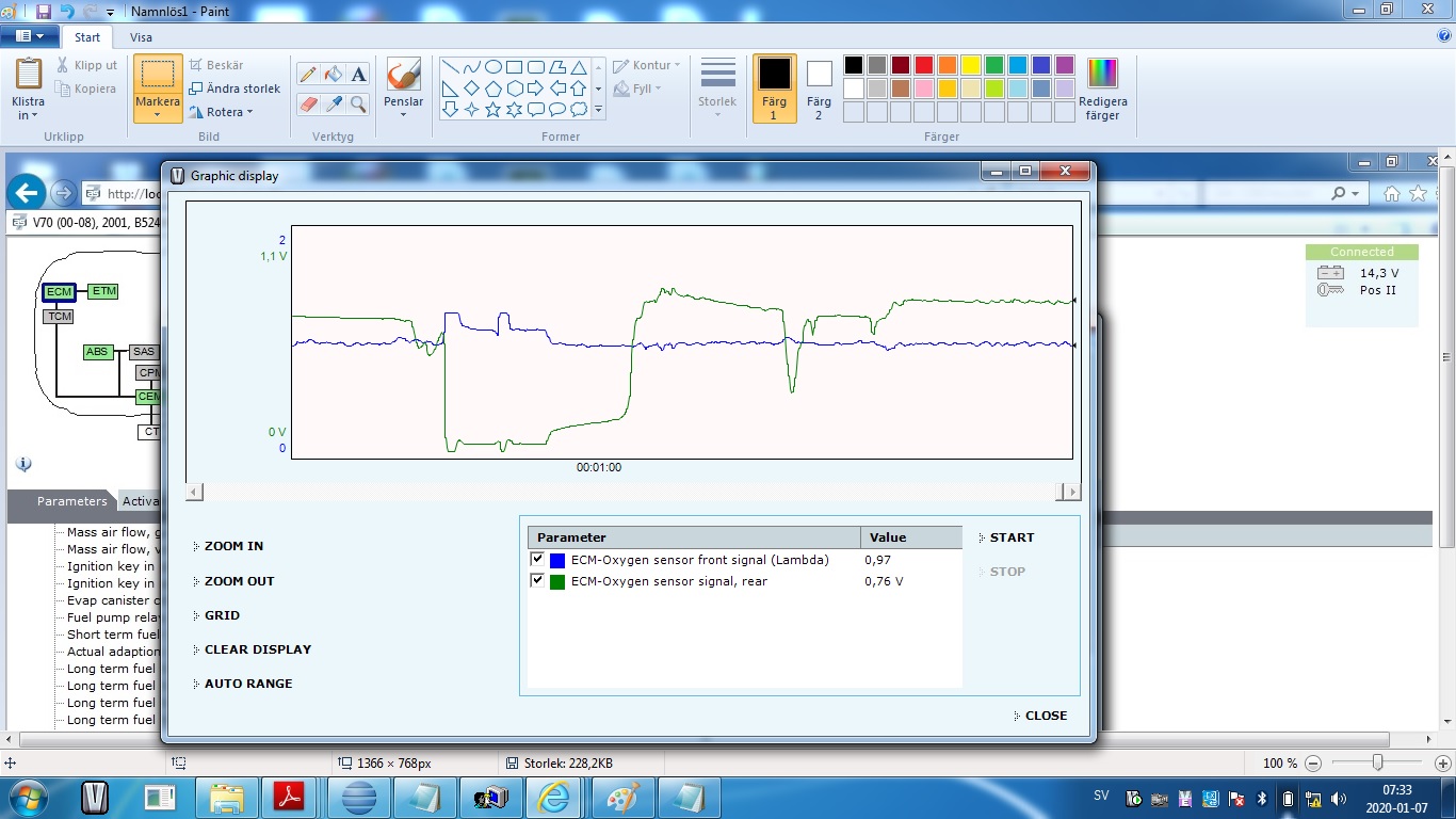

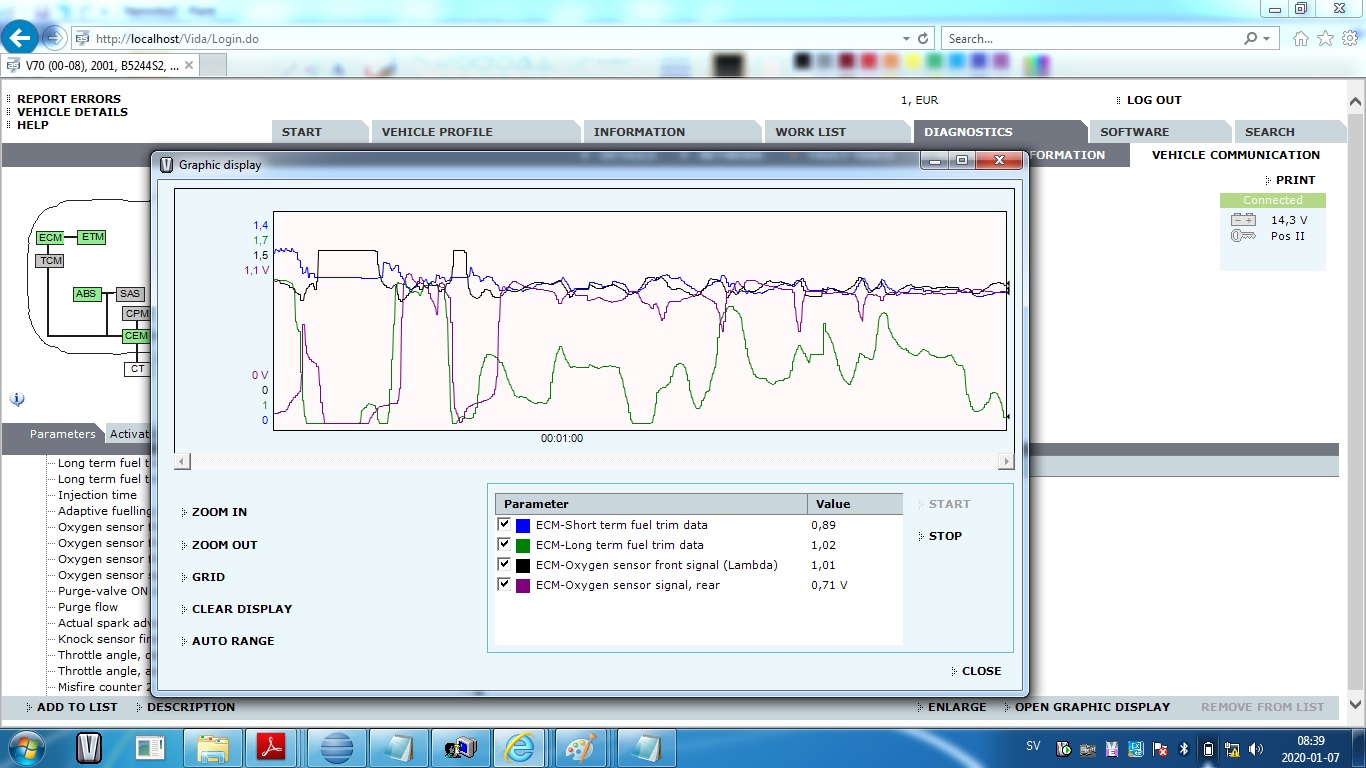

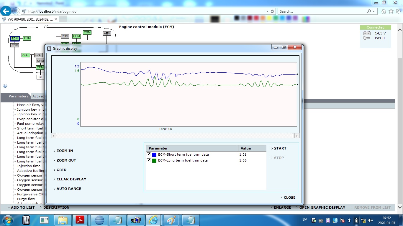

We have been driving today - so I logged some values of the lambda sensors.

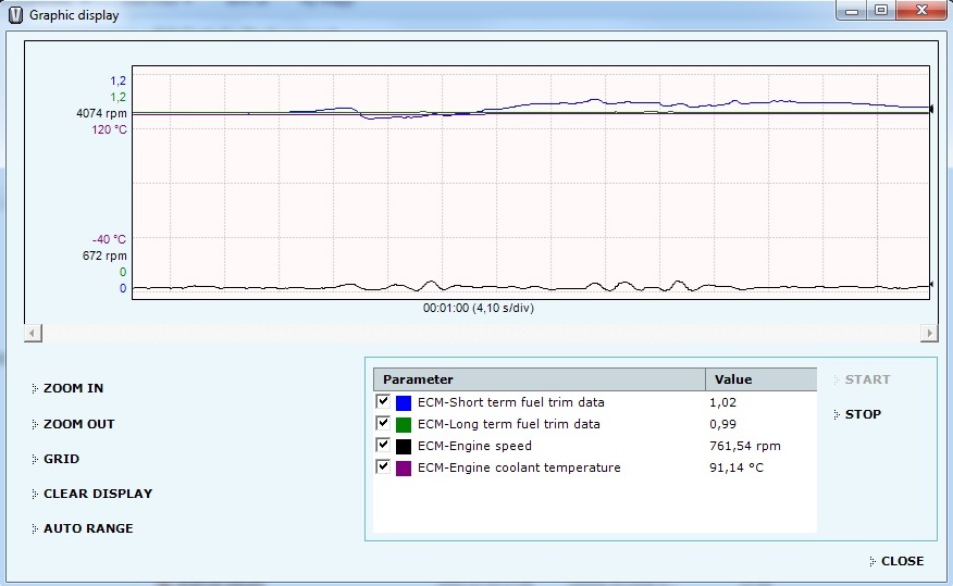

First idle STFT and LTFT:

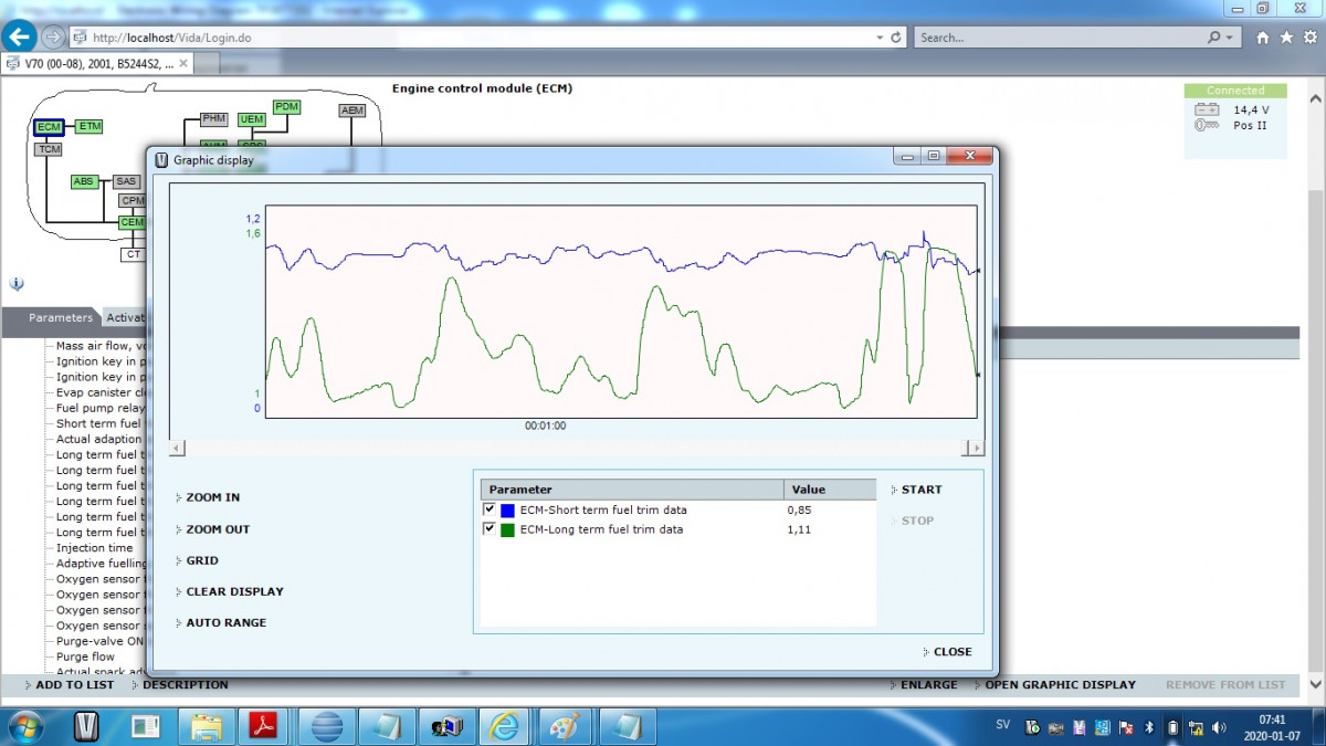

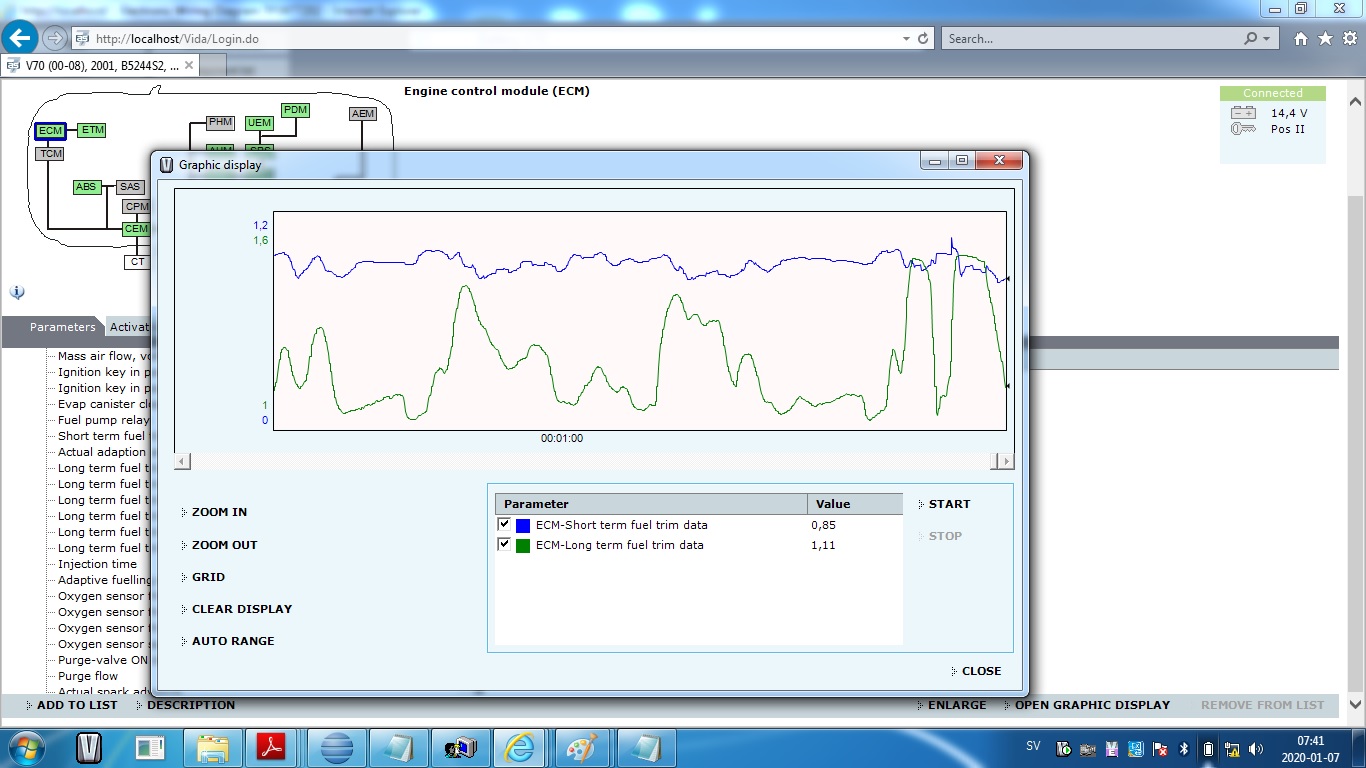

Same during drive:

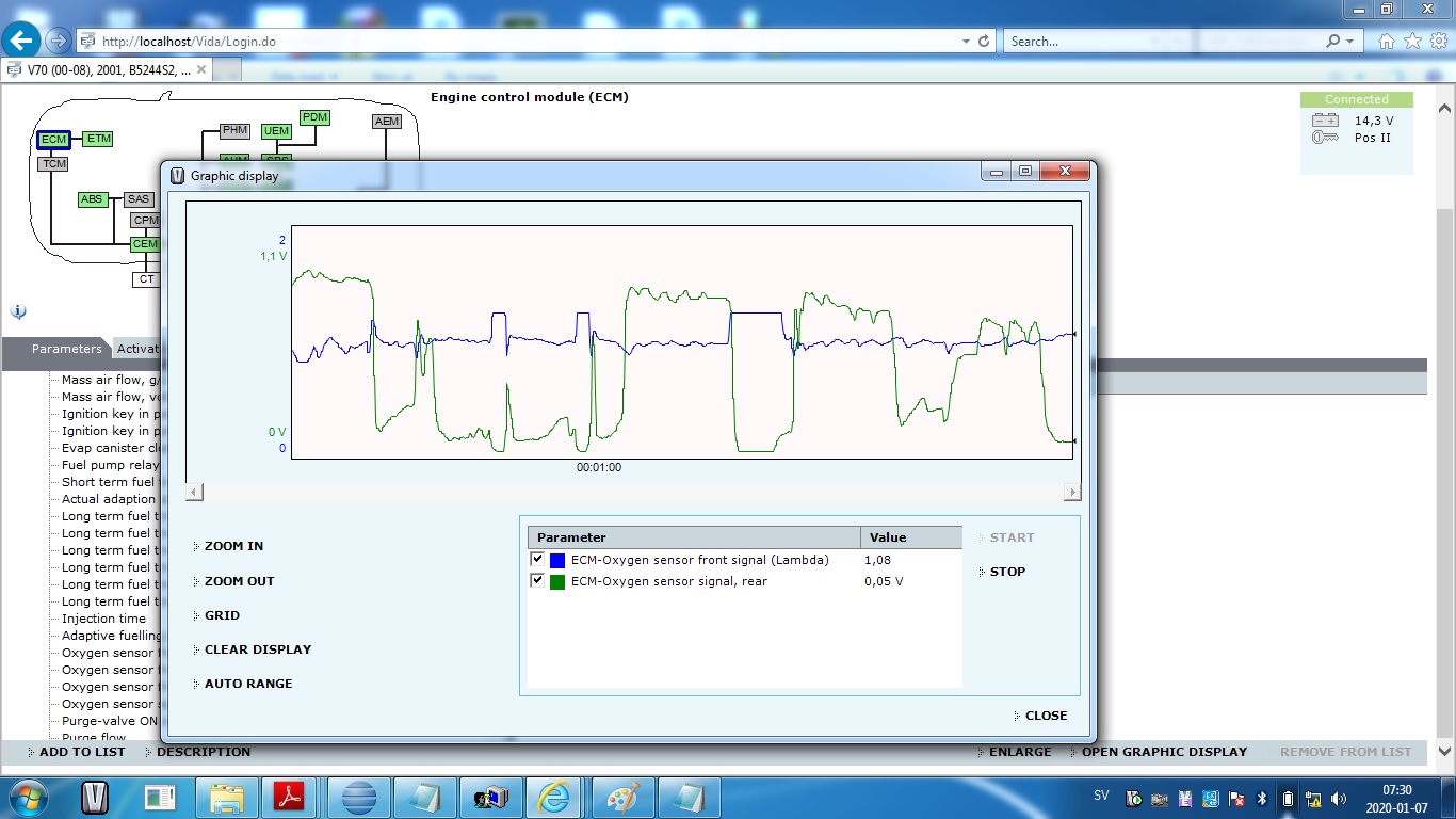

Pre cat lambda and post cat lambda during drive:
Same during drive:

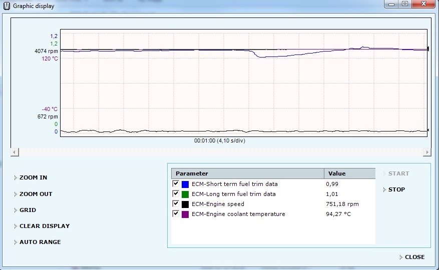

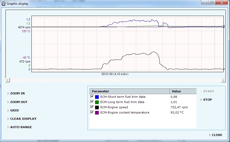

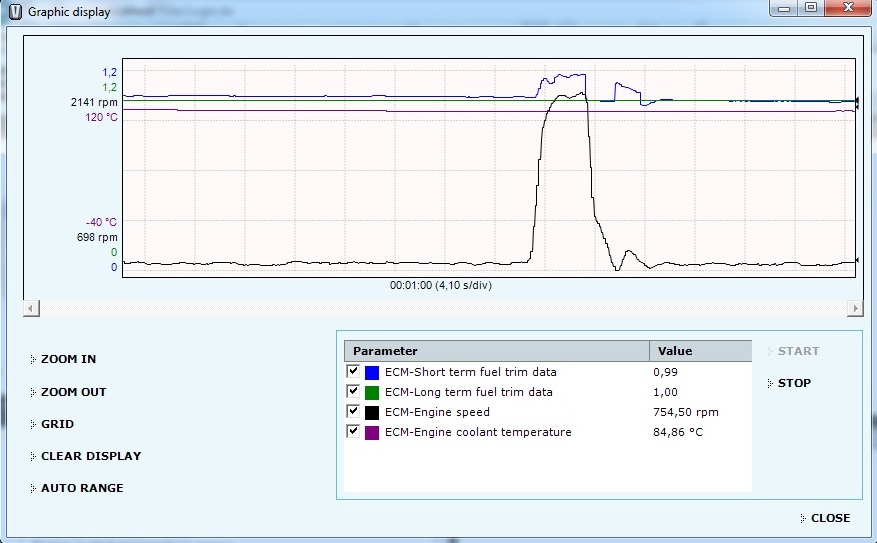

Ive been adapting the car the last ½-1 hour.
Both STFT and LTFT stay close to 1. Between 0.94 and 1.04.
What would those numbers be in % - as usually are the STFT and LTFT presented?
I have never seen a engine have STFT 94% and engine speed at idle 750. It doesnt make sense.
Here the first rev with warm engine: AC on and some fluctuation: NOW - the STFT is moving and LTFT is steady =) Not like before, the other way around:
