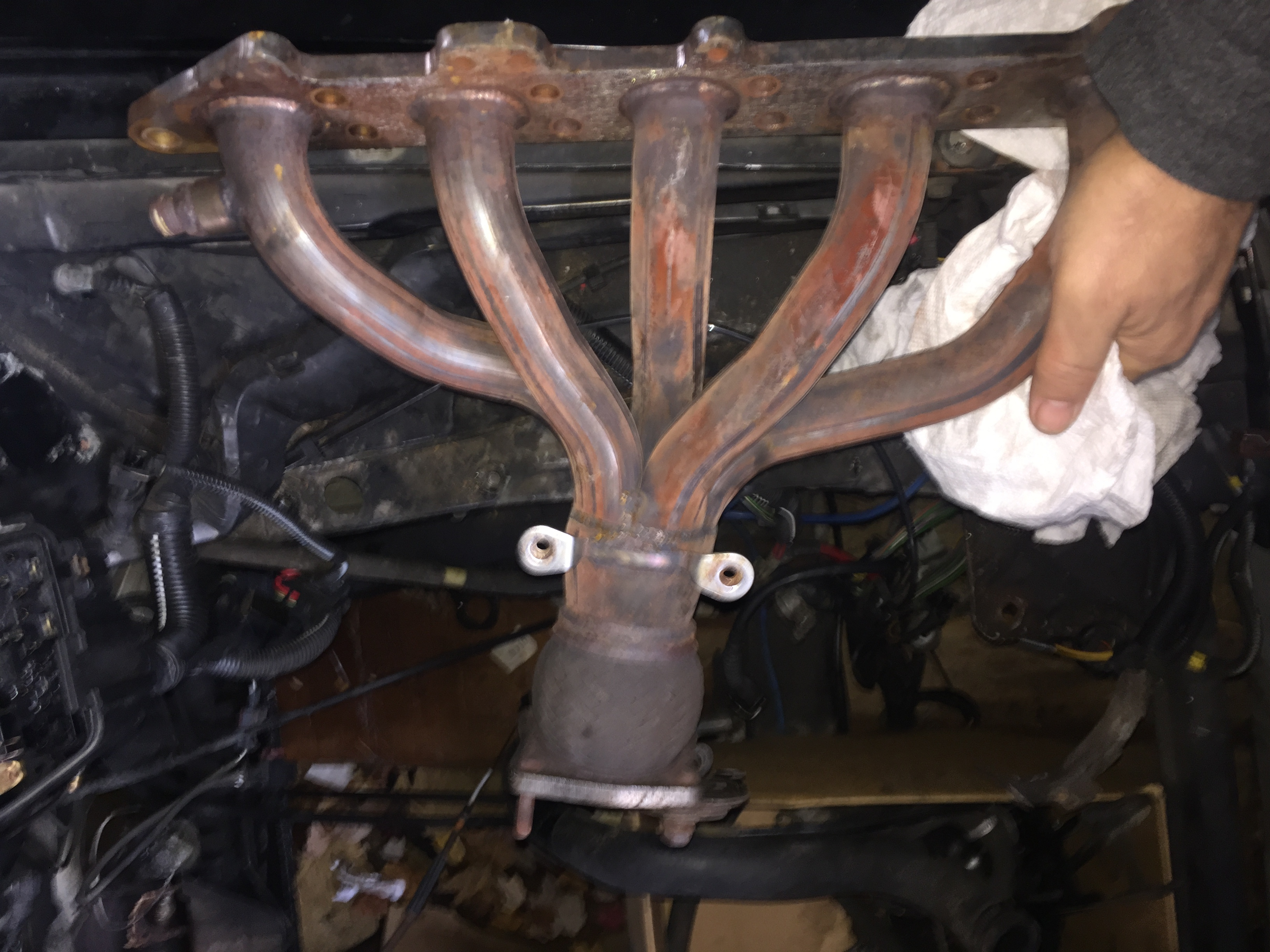

They appear to have one. Sent them an email to see if it’s the right one. I read here somewhere that ‘98 to ‘00 V70s were bastardized with various parts from factory. I suppose that’s my case since every single manifold I find does not match my model. Next stop will be the dealer I suppose but I’ll probably get raped there.

Engine number
ENG 585600- takes the 31216153 manifold, pricy at about $400
Previous takes the more rectangular looking part 9486055 at a mere $200
I have one of these from my 1998 parts car but I don't think its either of these.
Source - Volvo Parts Web Store in Illinois, Land of Lincoln Welders

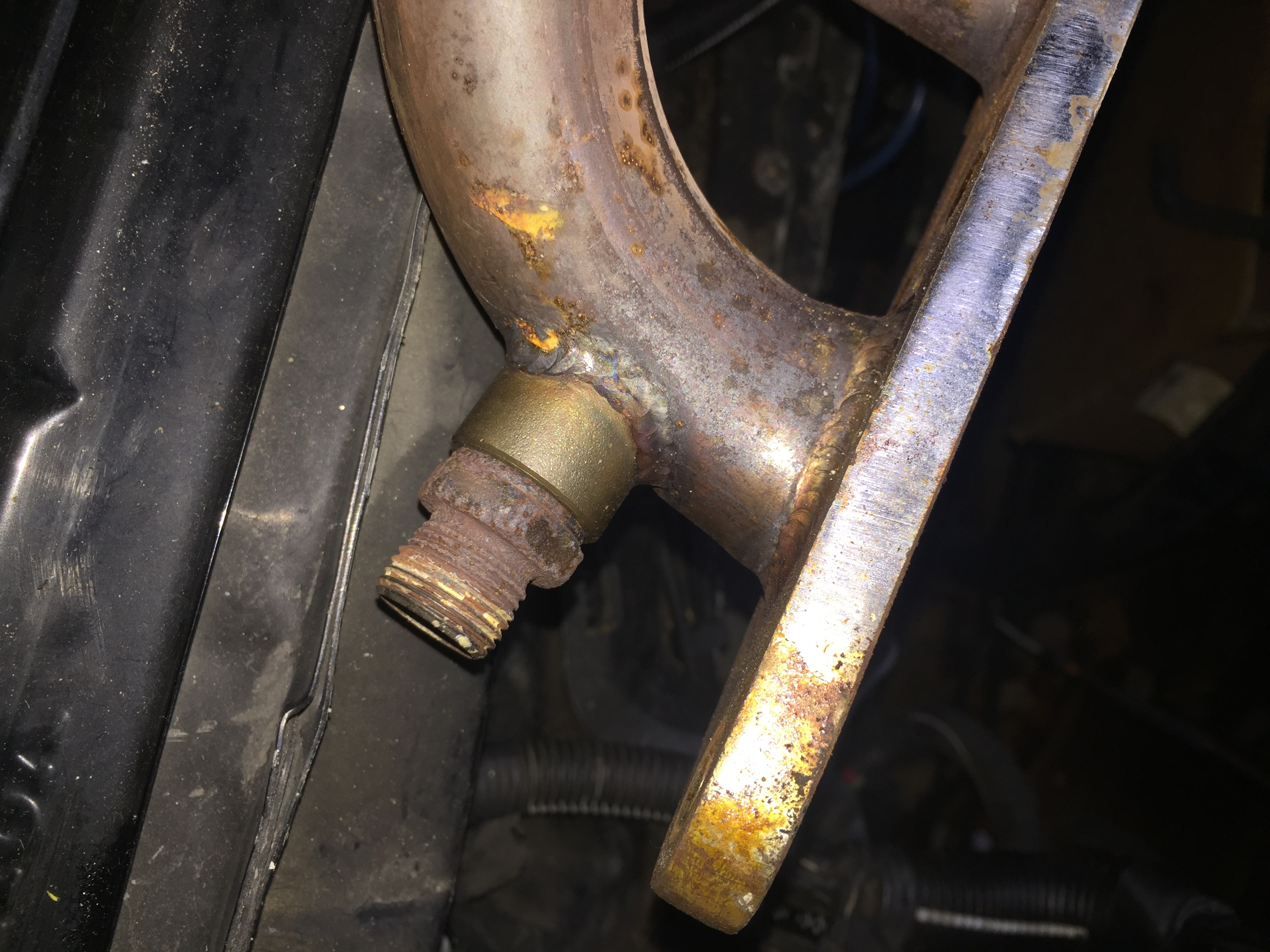

That boss on the #5 is not for an OXS it is for SAS - air injection, which you won't have on your 2000 car. You don't need that boss.
I think it is also incorrectly described in parts manuals as being EGR, too.

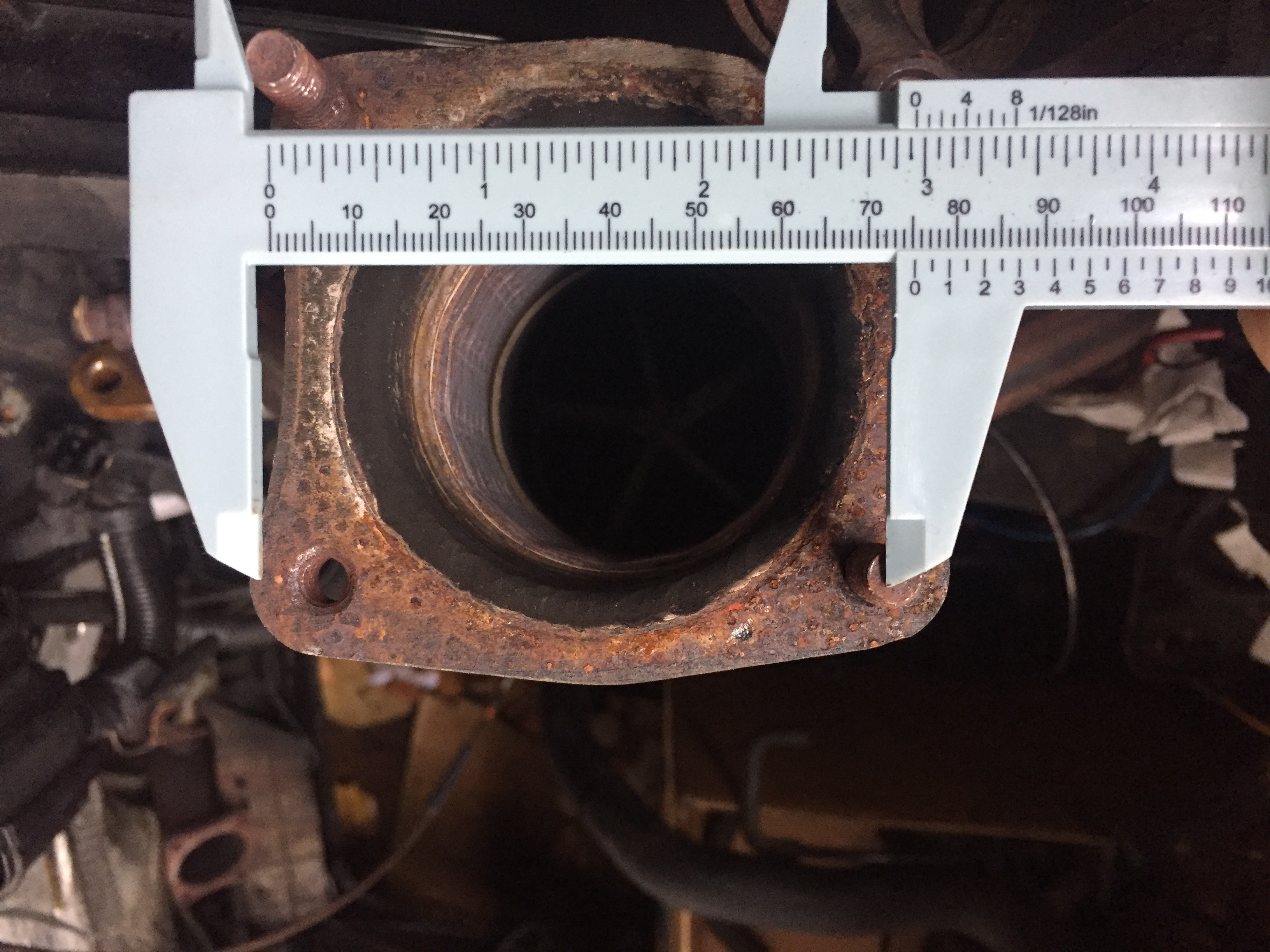

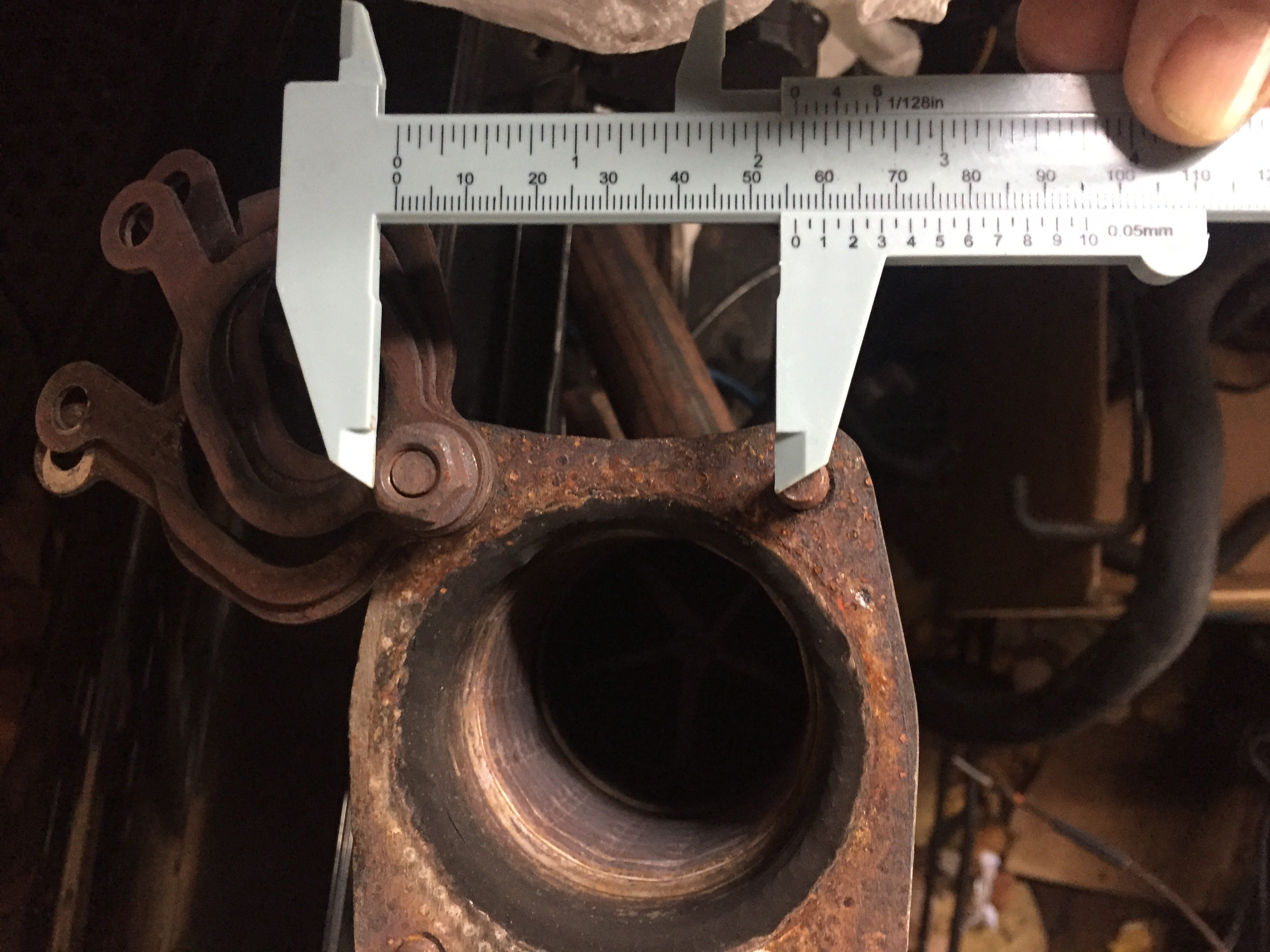

Yeah, neither one is large enough. The one I have has approximately a 4.4” spacing between studs.
Thanks for the info though.

I’m thinking of just drilling out the studs and using nuts and bolts instead.
- Posts: 6510
- Joined: 19 Jan 2014, 09:51
- Has thanked: 987 times
- Been thanked: 1075 times
I am not sure I understand the manifold you need, but if what you have is all steel (not cast iron), then have a welding or machine shop make a flange to fit. Then have it welded to your steel tube exhaust manifold. Add any coupling needed for sensors and you are ready to go. Of course, if local emissions laws permit.
