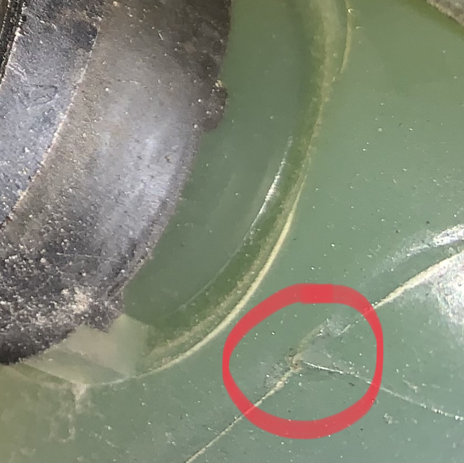

Just zoomed in on my own pic, guess I didn’t notice this before thought it was a seam...pretty sure it’s a crack...
