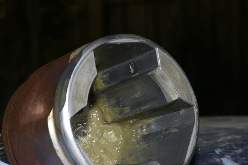

I've had two cars (Volvo V70 and Acura RDX) that vibrated under throttle at certain speeds and in both cases it was the inner tripod joint. I spent considerable time trying to determine which axle was causing the problem and I couldn't do it. It's been my experience checking for play doesn't work because it's only a small pitted area on the surface where the tripod bearings slide and roll that causes the vibration. You can't manually feel this type of problem at the axle joints by hand. See the attached photo. If you really don't want to replace both axles you could take the axle you suspect is causing the problem and confirm by taking it off and taking the inner joint apart to inspect or just replace the side you suspect is bad and hope for the best. On my Volvo I was able to fix the vibration by just replacing the passenger side axle, which was a best guess but my best guess for the Acura didn't work, ended up replacing both axles and it was the driver's side for that car.
