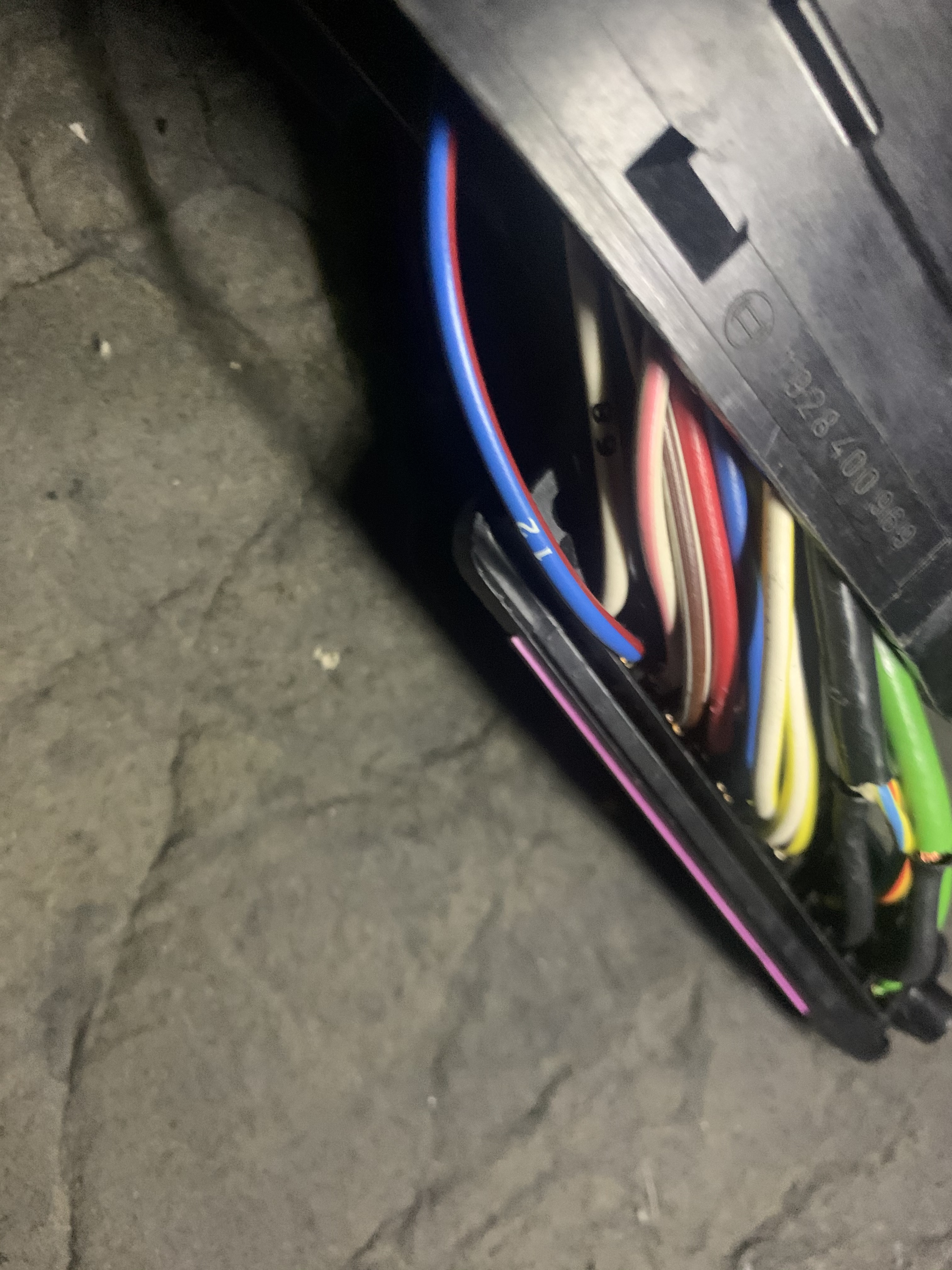

Hi, I've checked the wiring and I don't see any broken wires or bad contacts. I have tested the ECU terminal number 2 (but my wire is blue and red, and it should be white and yellow no? ) I have tested it and it gives me a reading of 0.99 and then it jumps to 1000 but returns to 0.99... does not give a concrete or consistent reading. My ECU has the white sticker on it. I have adjusted the TPS with the gauges. I'm going to check the V reading on the TPS wiring to see if it's okay. I heard the ticking of each injector seem to jump out... that doesn't mean they're working right.
Yesterday I looked at the fuel relay, it's white and has no reference of any kind. I'm doubting if it's 30A (B230F), I've asked for it because it looks quite corroded on the circuit side.
It keeps doing like a vacuum before accelerating, it clearly sticks. If I accelerate it little by little it goes well, although little force.
Thanks

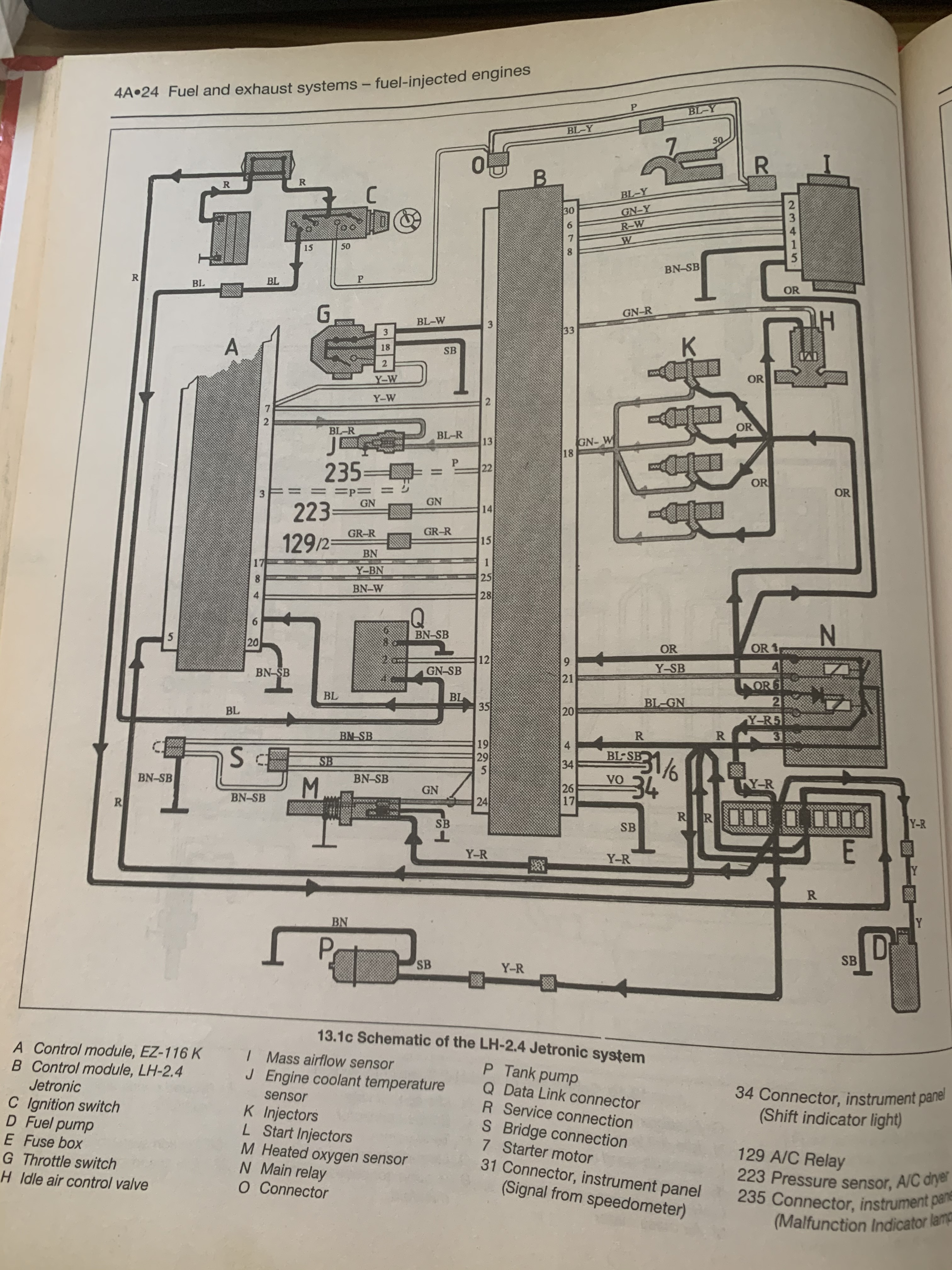

The colors are correct, however that is the is the EZK Ignition module not the LH-Jetronic fuel injection module.
With a electrical measurement two points of reference are required. Such as pin #2 to chassis ground, Pin #2 to Pin#1 .... ect.
Ticking injector means it is firing but the spray pattern maybe not be good or the injector maybe leaking.

MALL240 wrote: 05 Mar 2020, 01:45 Hey Rick, my system isn't Jetronic? It's EZK?
Them cars have two Engine Control Units. Jetronic for controlling the Fuel injectors and EZK for controlling the Ignition spark.
Jetronic is located on the right of the driver’s side footwell. I think it is behind the Kick panel.
EZK is located on the passenger side firewall. This is what you been working with.

Okay, just to be clear, which one is the ECU?
Edit: THANKS!!!
Edit: I see it's 3 different components. I'm going to take a good look at everything, because I don't remember seeing the ECU around. Thanks

MALL240 wrote: 05 Mar 2020, 02:03 Okay, just to be clear, which one is the ECU?
Both are. ECU means Engine Control Unit. One controls the engine by means of the fuel system and the other controls the engine by means of the Ignition system. Years later they combined the two into one unit.
What is the third one you are looking at?
