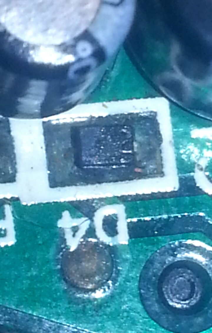

Good evening. I was just about to start removing the electrolytic capacitors when I noticed something. It appears to me that D4 is somewhat burnt and was hoping for some opinions as if this may be the source of my problems/headache.
Many thanks
Andre
Many thanks
Andre

Yes, D4 and the surface of the board around it do look unusual -- from the pictures it looks like they have overheated and left burn marks. Is it possible to do a diode test on it and see if it still rectifies and what the forward voltage is?

It may not be the diode. If you look at the capacitor above it there looks like it may have leaked to the other side too. Try cleaning the diode with Q-tips and rubbing alcohol (if you can buy any these days due to coronivirus) or IPA (same as rubbing alcohol but higher purity).
You may find that this cleans the component up.
Coming from the way back time of circuit board manufacture, some manufacturers of commercial pcb's were not to careful on cleaning the boards after manufacture leaving fluxes on the surfaces.
