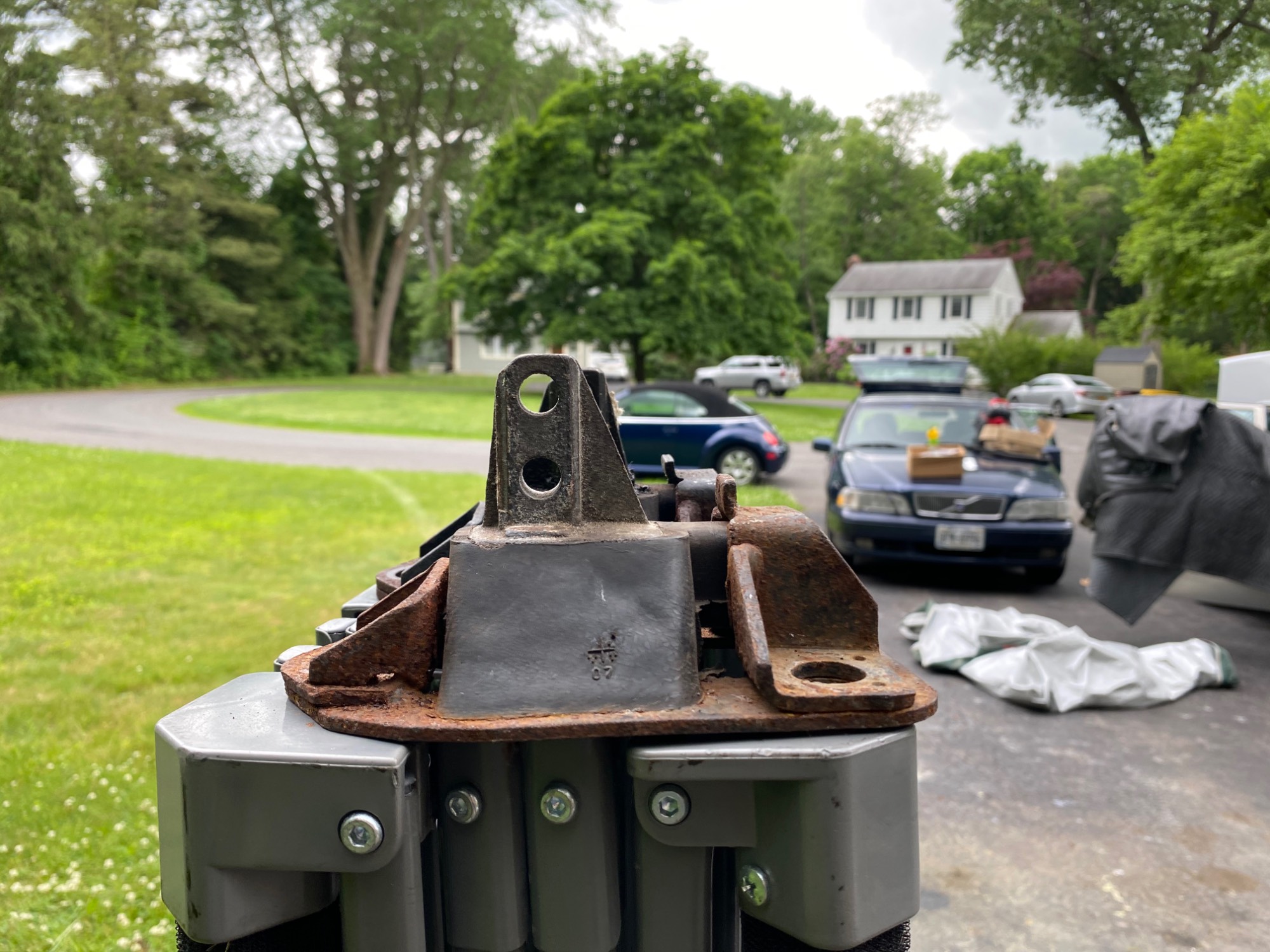

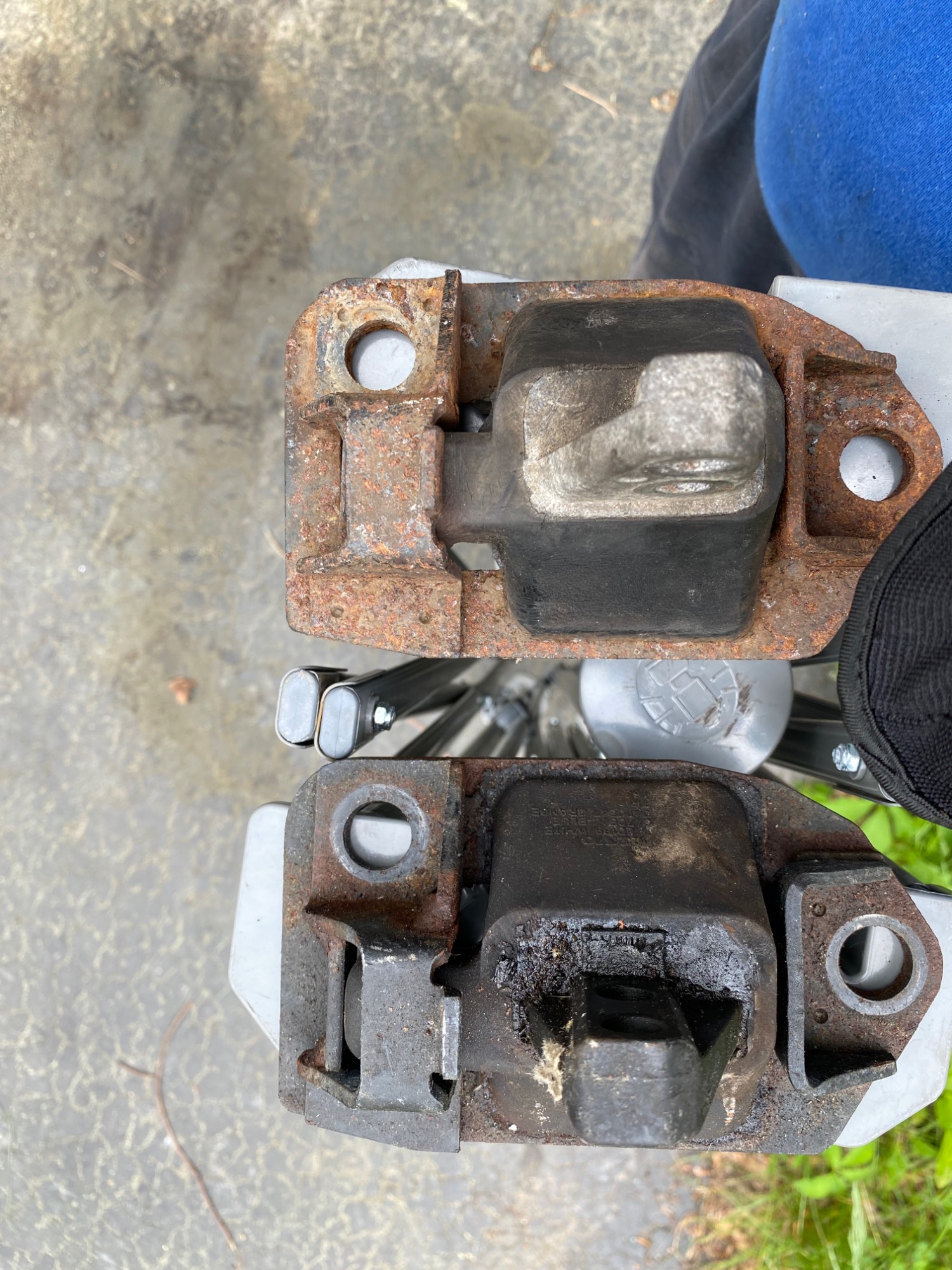

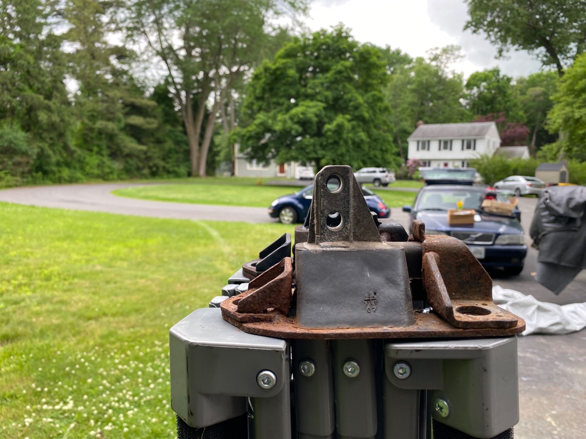

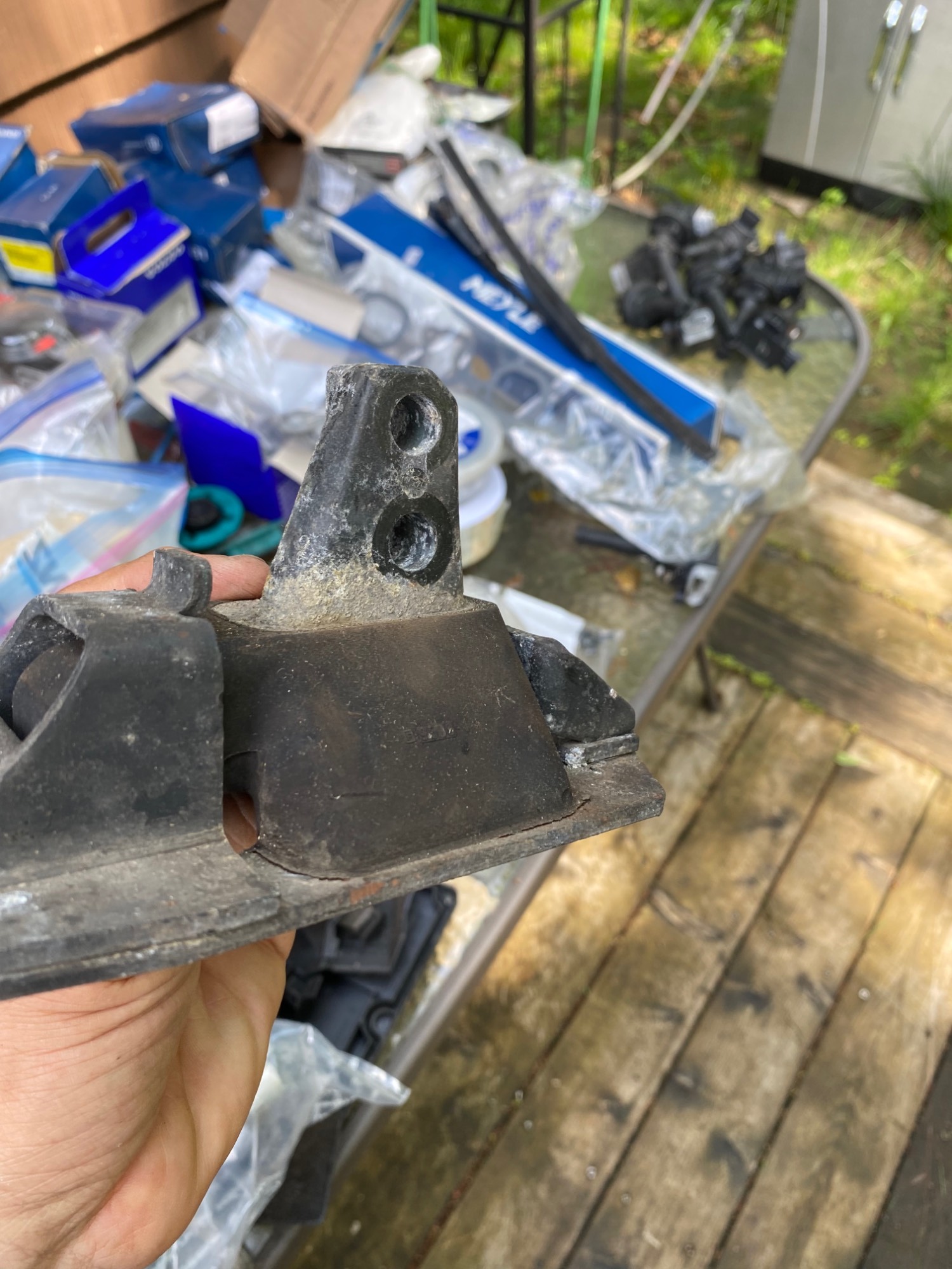

Here are some more pictures of the two different p80 mounts , the tower displaced about 8-10mm front back and also set more to left closer to engine. ( all directions relative to car)

Does anyone know what is going on with the
White , blue, orange
Part designation ?
See part numbers in rubber in photo
Part designation ?

But anyways on a more serious note,, Didn't anyone notice a spacer under their right lower mount? My 1999 has about a 1/8 aluminum spacer clipped to it.

I have seen a shim offered by Volvo for that mount. Can only think it may have been to overcome and axle alignment issue possibly?
