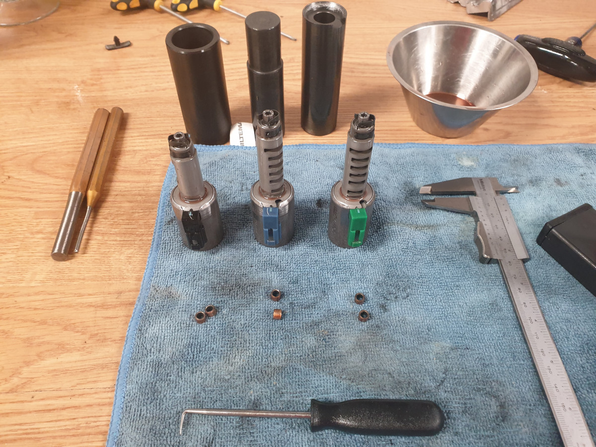

OK so now I'm half in to this job, getting to the solenoids take a bit of time and patience.
I have taken the solenoids apart and cleaned them and change to new bushings. The old ones where not that bad but new is new.
Question: The blue one did rattle when I did the shake test before taking it apart.
To me that would indicate that the shuttle inside was locked up inside ?
Now when they are all serviced they rattle fine before I put the spring and shuttle together. When when everything is put together they are all silent.
Any one hade a solenoid locked up like this blue one? and could that cause a shift flare 3 to 4 only ?
