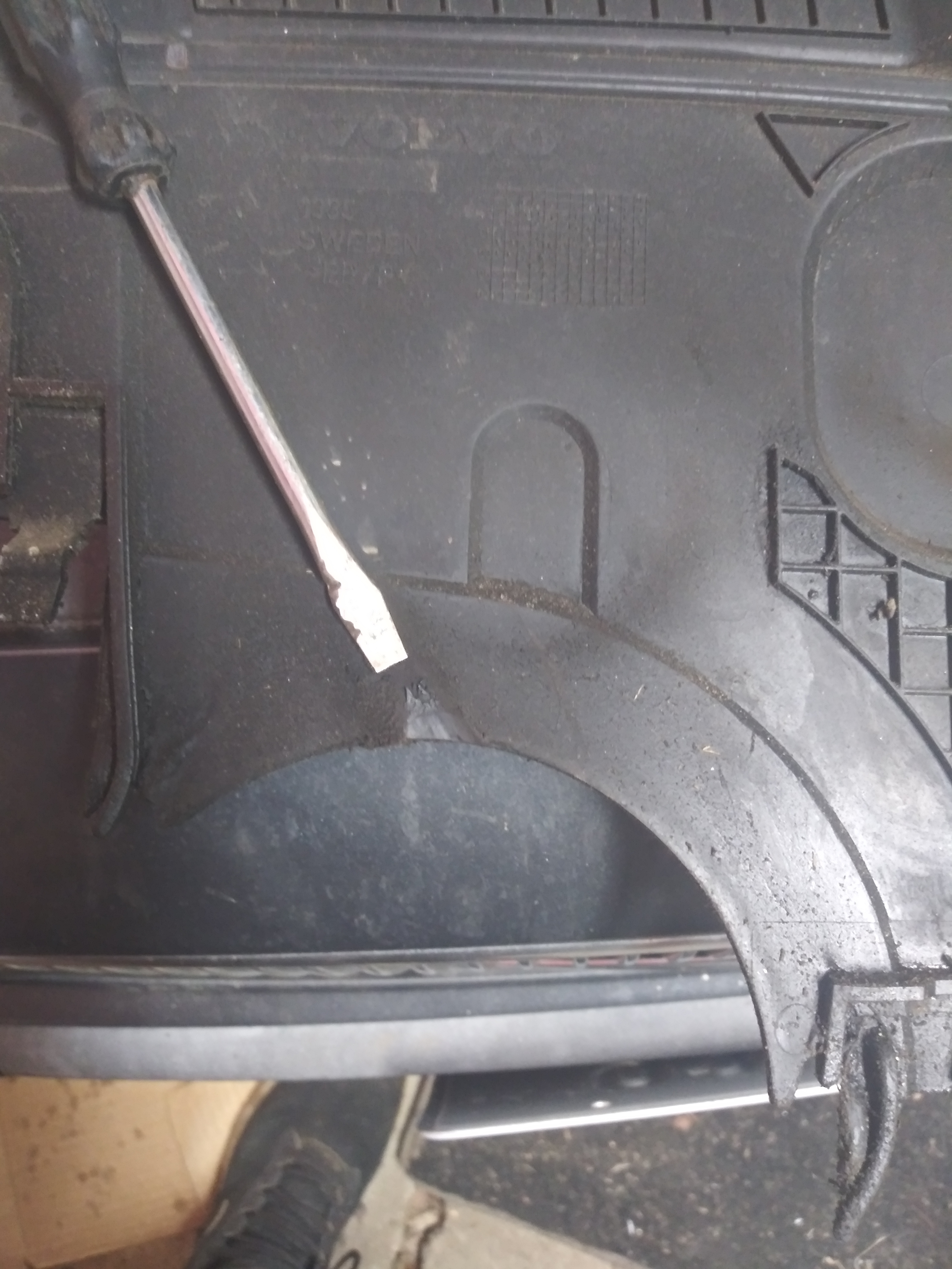

I took a pic of the plastic belt cover, rub mark at the tip of the screwdriver.
Fresh mark. just above crank sprocket.
is the belt shot already?
