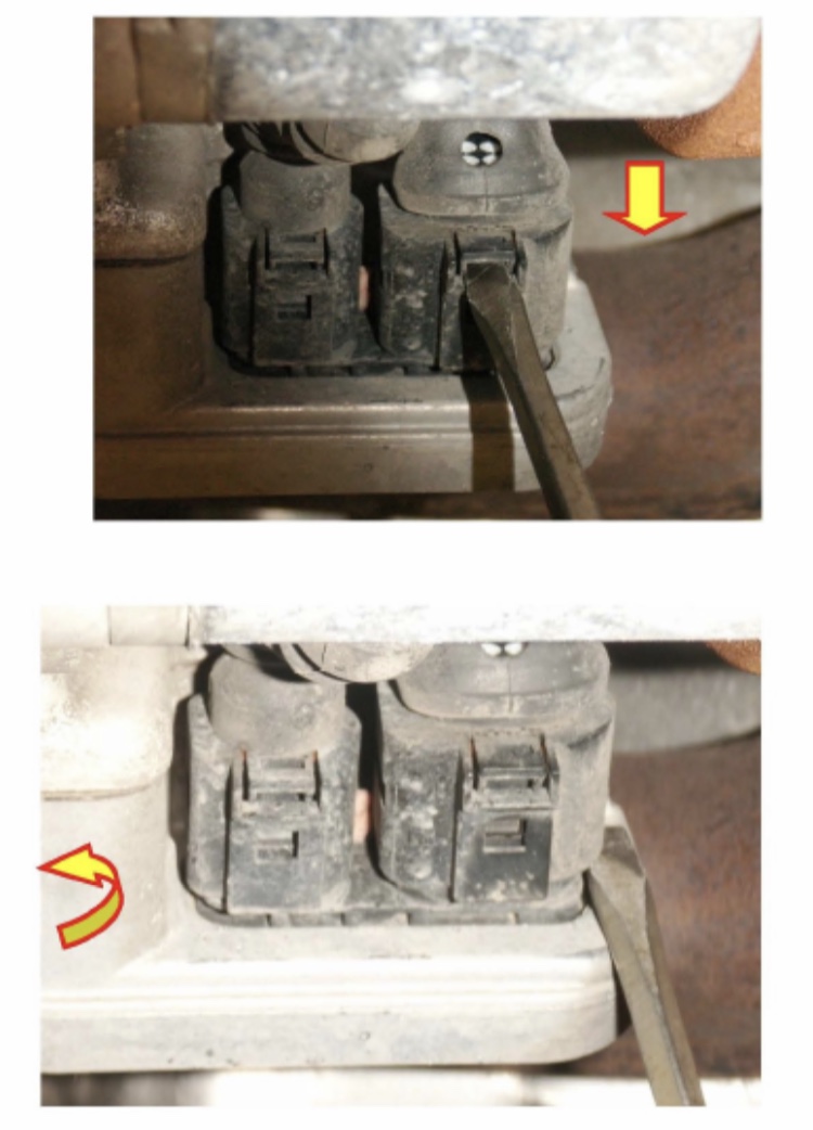

- Unclip both electrical connectors. These become very brittle with age & the locking tabs are easy to break if you don’t pay attention to how they come undone. When releasing the connector, press down on the connector, towards the DEM, to relieve pressure on the connector tab. Insert a small flat-blade screwdriver under the connector tab and gently rotate the screwdriver until the tab is unlocked. See photo. Then, gently push up on the connector.

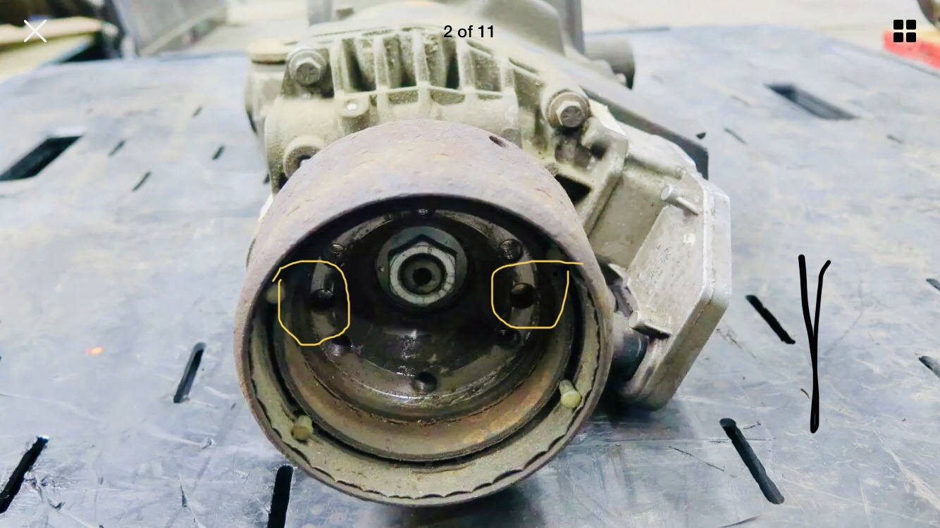

Ok so I got under the car and looked at the Haldex, looks pretty good, not much evidence of leakage. I then disconnected the pump and put 12 volts to it and a ground on the other terminal and there is no life in it at all. I wonder if there's any point in rebuilding it or it's probably in need of replacement. I don't know if I can afford a new pump if the DEM is not functioning and will need to be serviced.
I also took off the pan and looked at the bevel gear. It seems like it hasn't been leaking either and the fluid is just below the plug so thats good. I gave the driveshaft a turn, it will not turn without moving the front wheels so that's also good. It does turn maybe 5-10 degrees before it hits resistance when I turn it back and forth, I assume the resistance is the splines on the collar sleeve. Does this sound like too much movement?
Should I perhaps remove the bevel gear and give it and the sleeve a good inspection and oil change? It actually looks pretty easy to remove.
