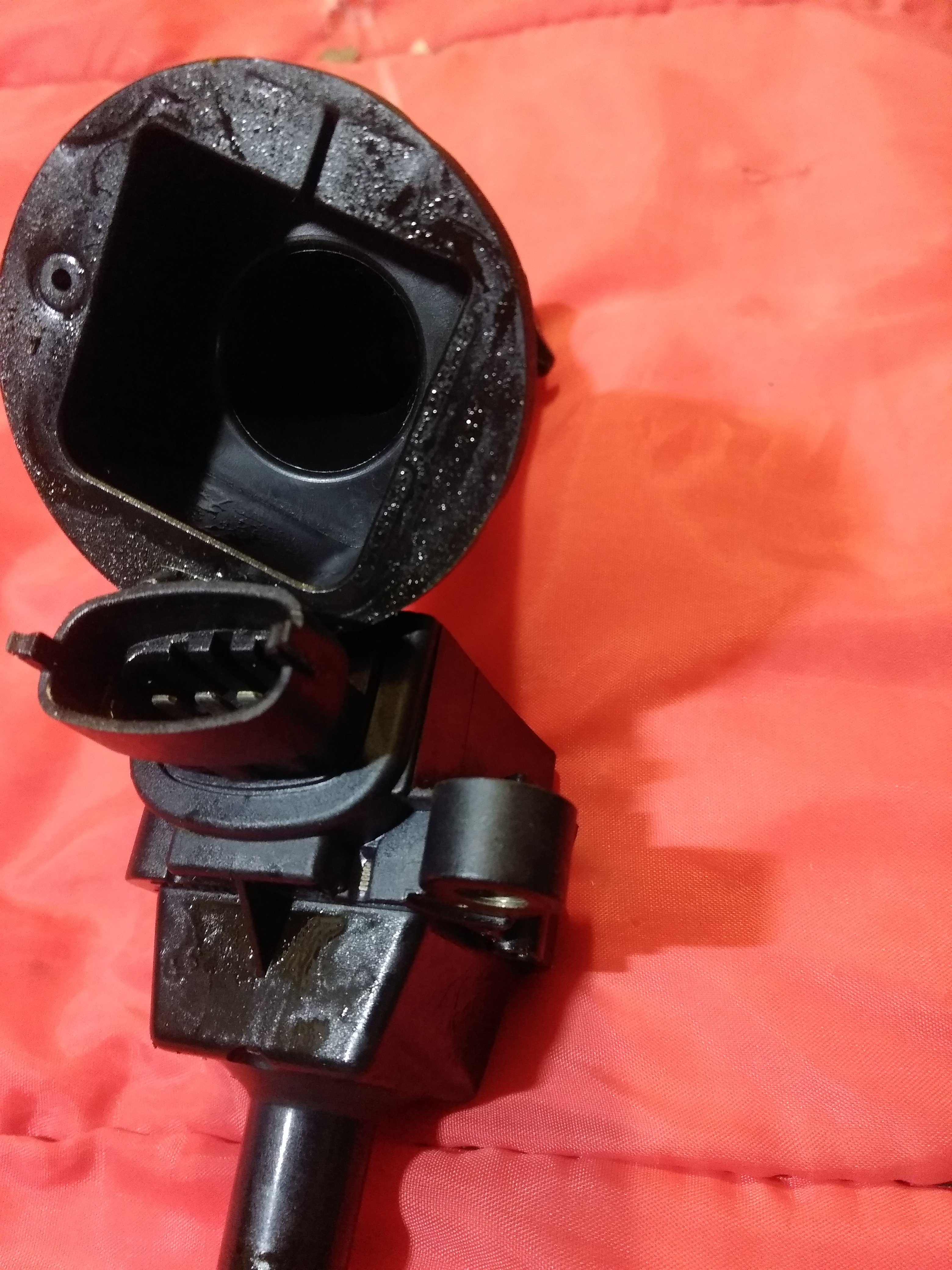

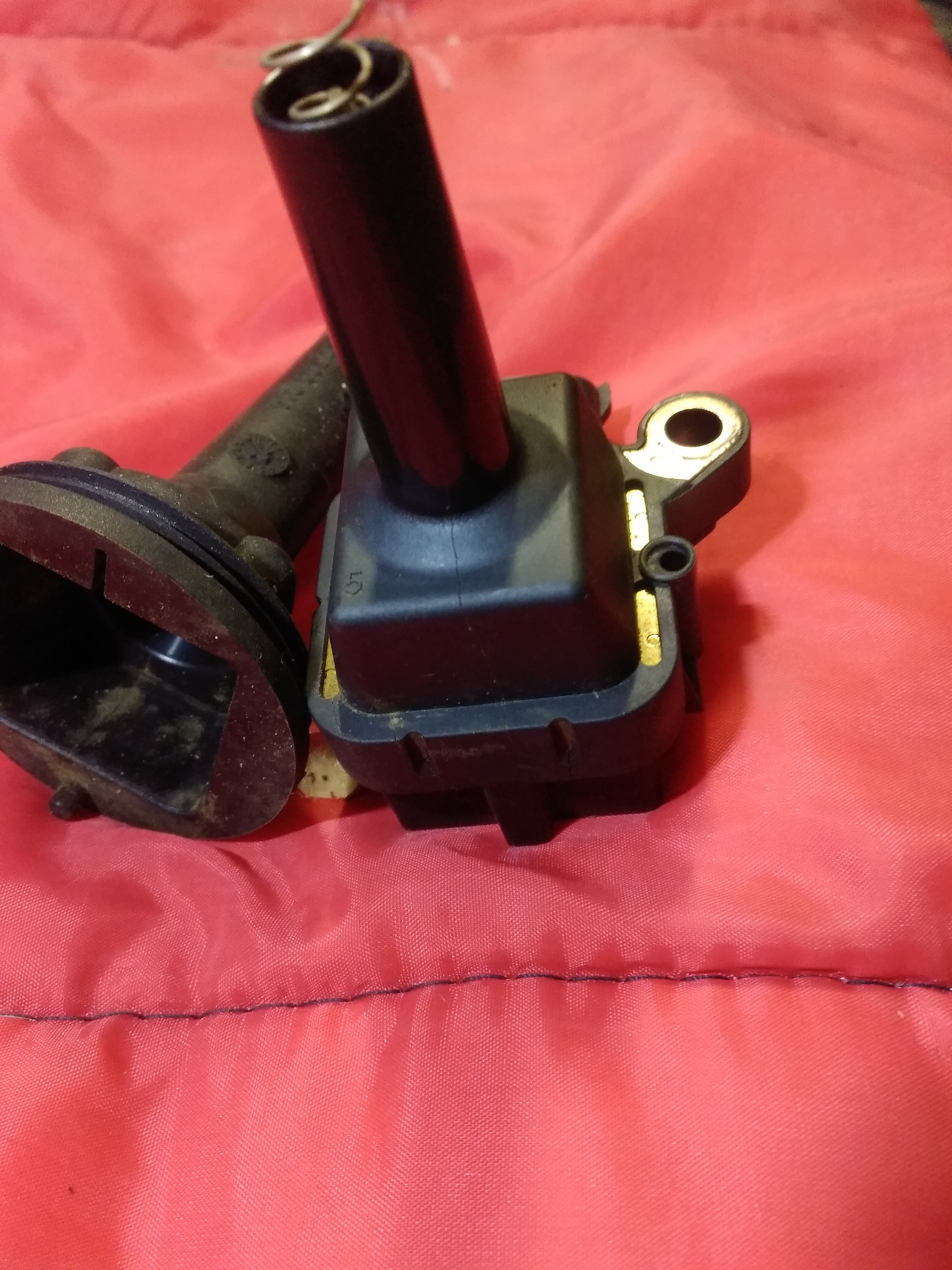

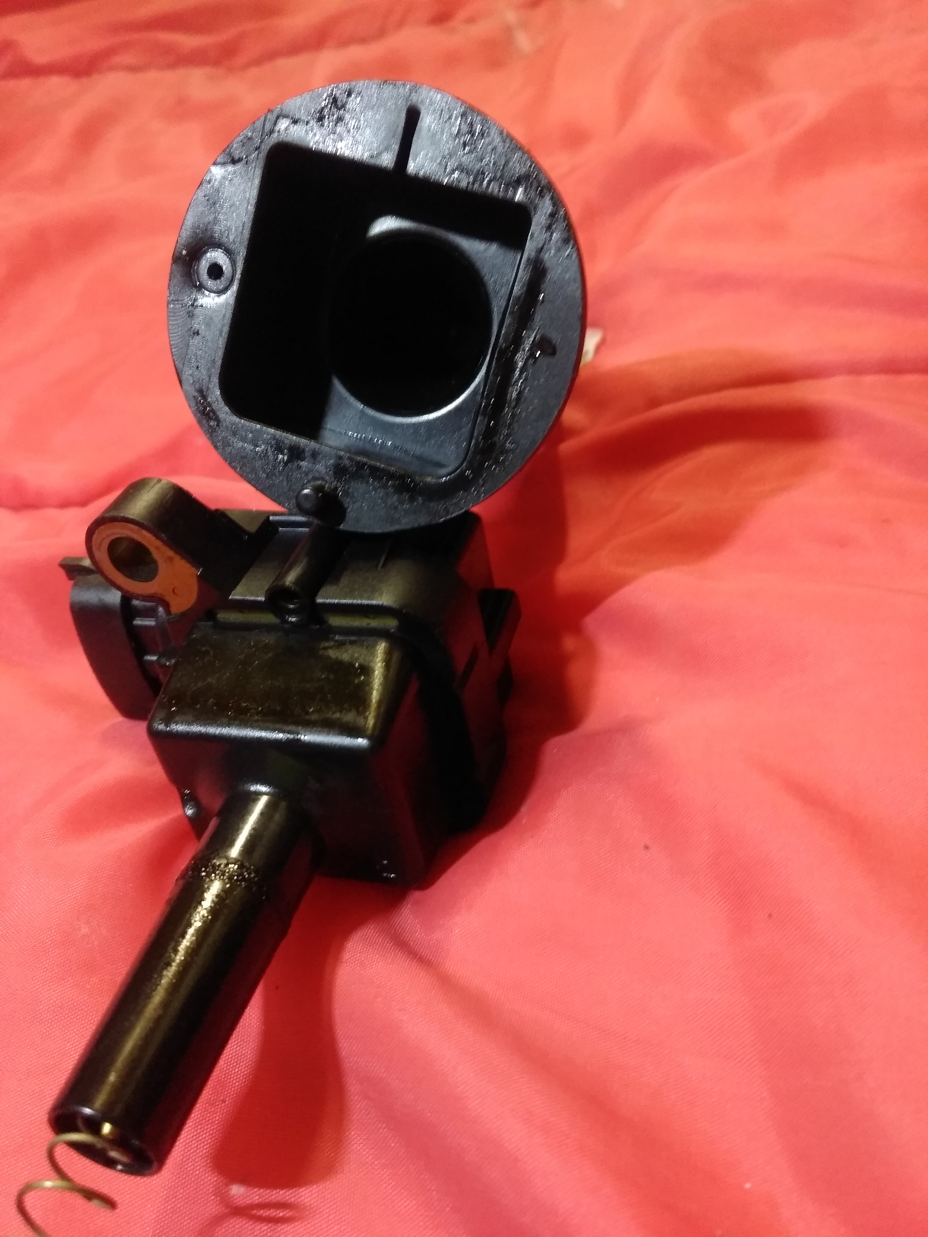

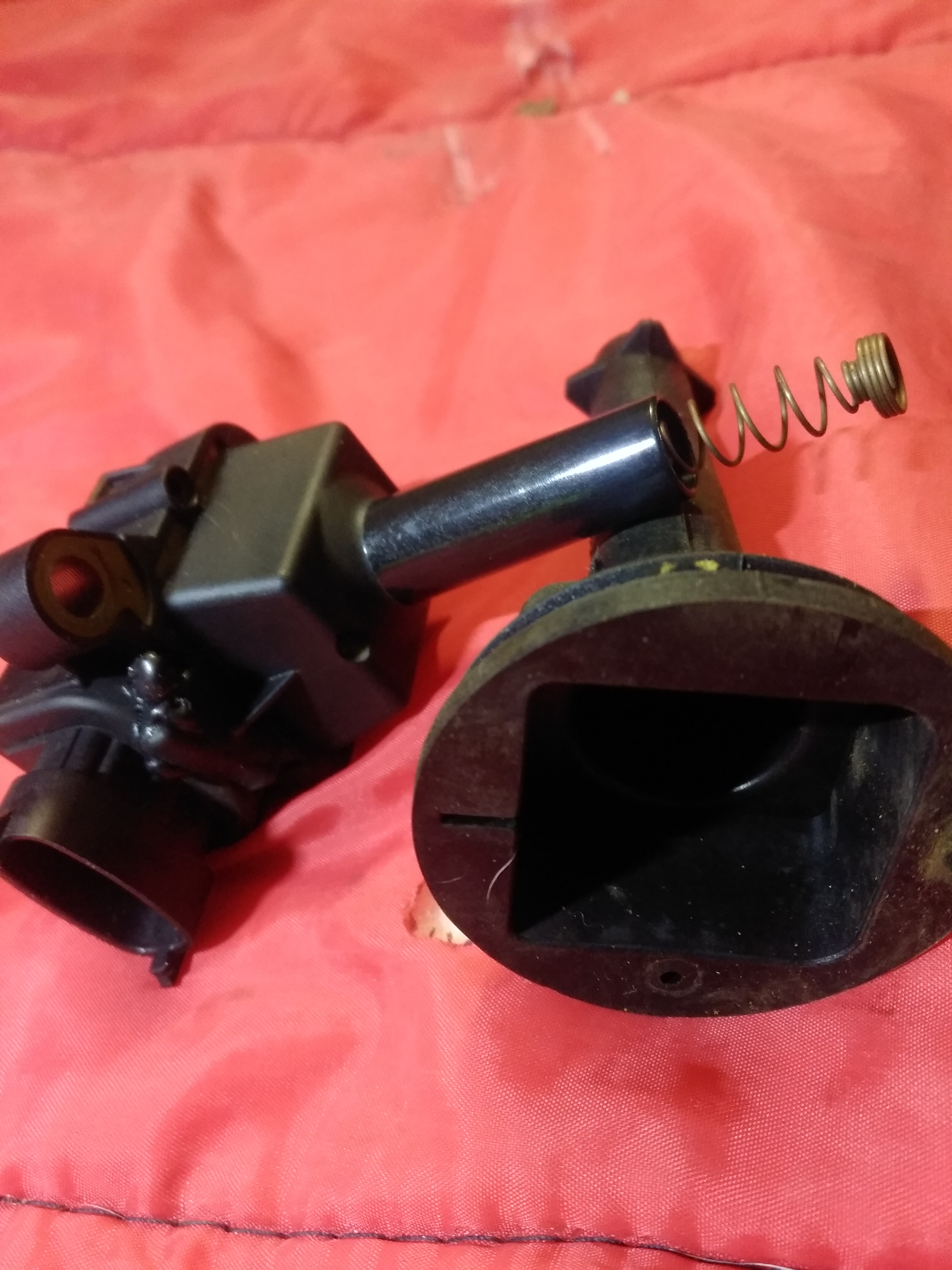

I will try again, I have had them apart before. The plug itself has some of the melted plastic melted onto it.

What would cause such a short, do I need to resolve this before installing the new coils,don't want to ruin a set of OEM Coils, or could the coils be the cause?scot850 wrote: 01 Jul 2020, 11:37 OP said it has melted! I have never seen that before and can only suggest an internal short of some kind. I'd pull the spark plug and have a good look to see what it is like.
Did you replace any of the coil packs? Reason I ask is that I have heard of them shorting out. When I puled some out of a V70 I had a few years ago, they were full of cracks in their casings. One was causing a misfire. I ended up replacing them all, and cleaned the surface where the bolt for them goes through and connects to the head, and the head surface to make sure they were clean. This is the ground and again will cause a misfire if not clean and in good contact.

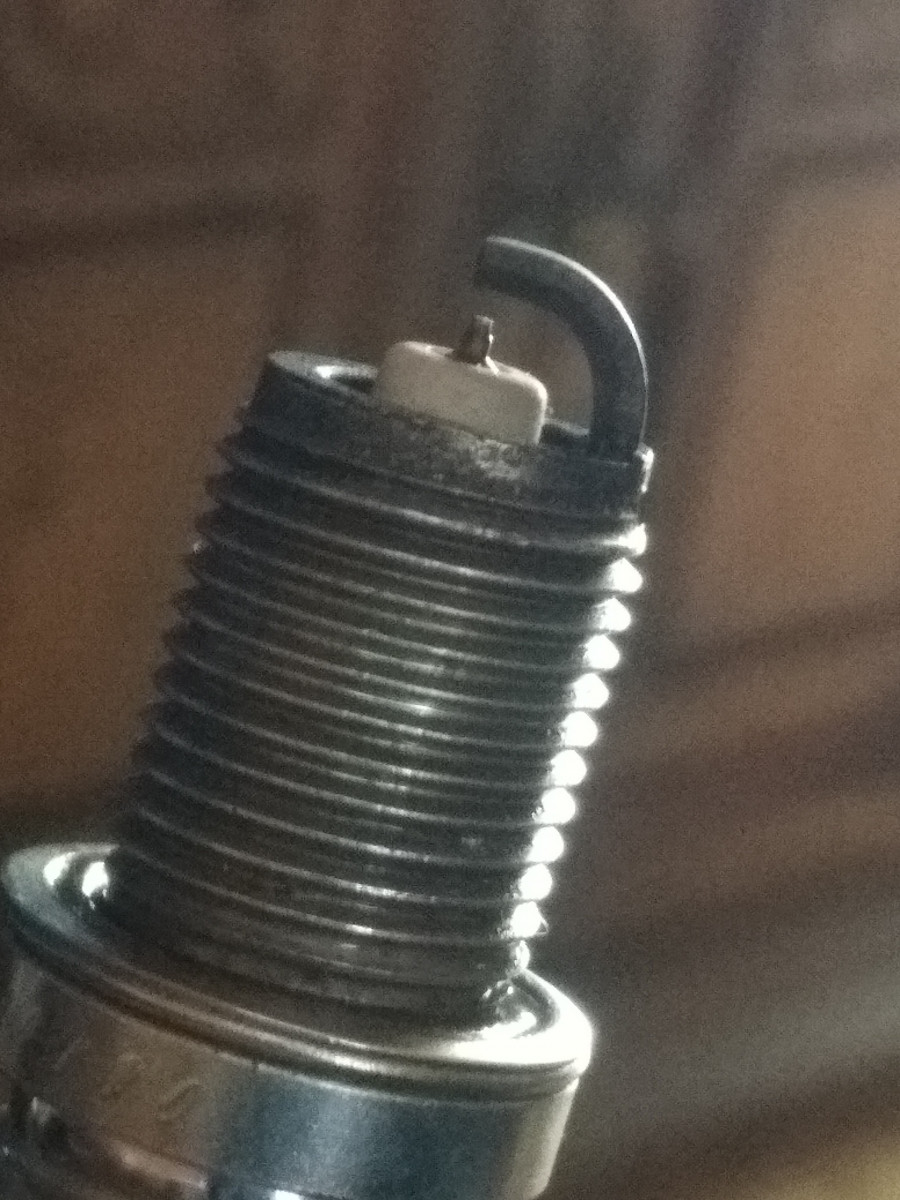

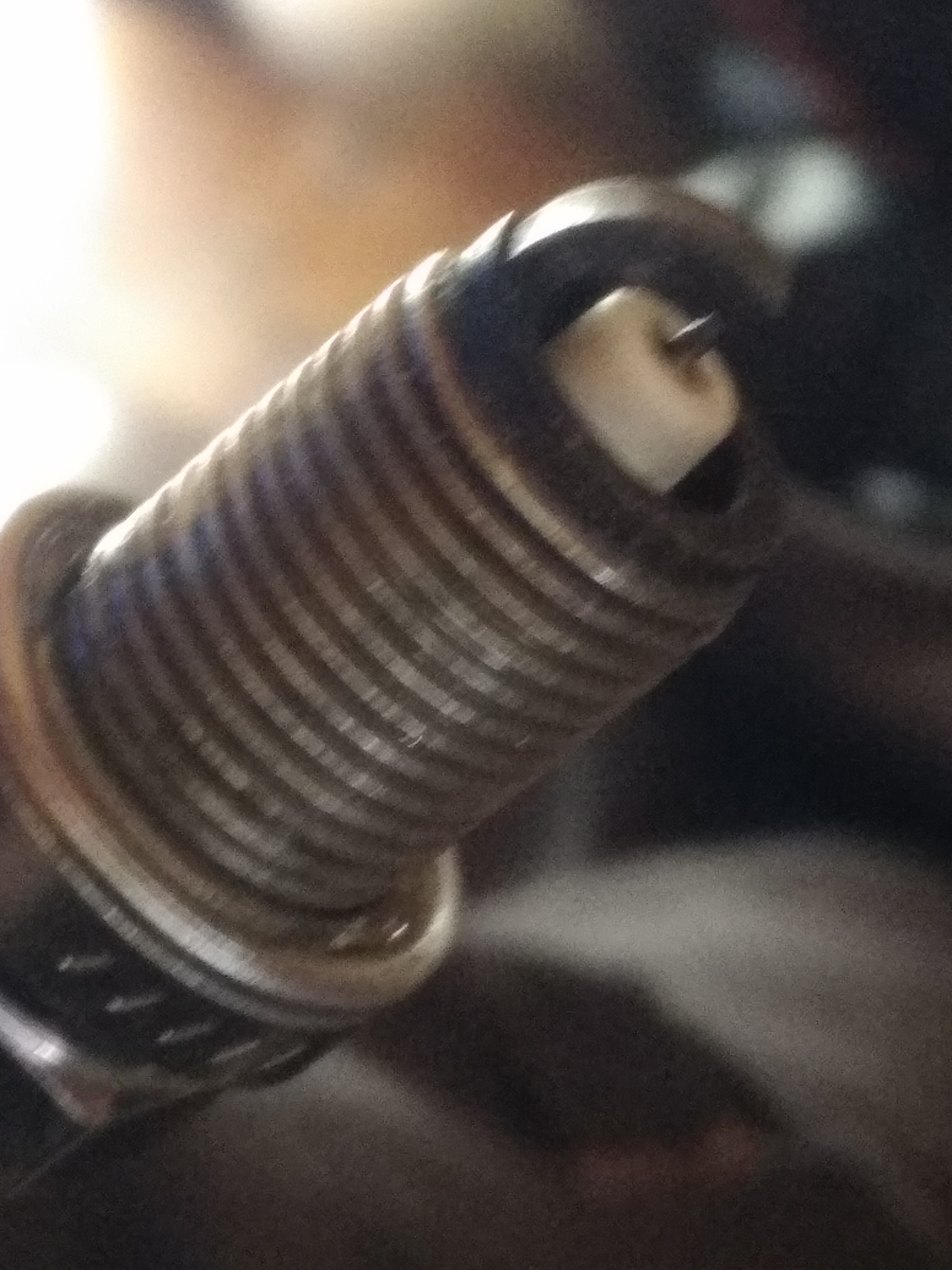

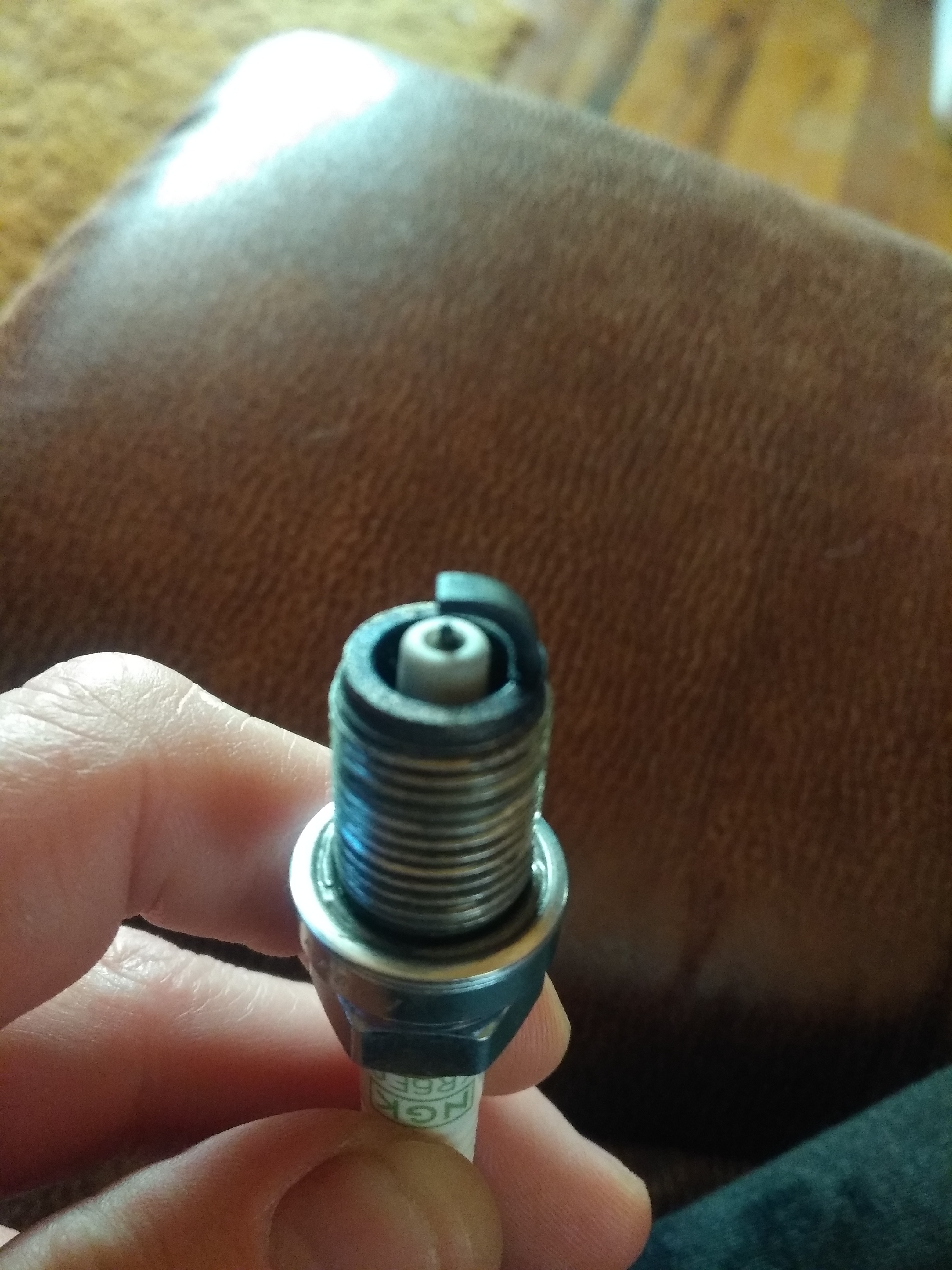

Here are some images of plug from cylinder 3. The plugs have less than 100 miles on them,probably around 50 miles or so since installed new,they are NGK Platinum,I did not gap them because they were specific for my make and model and i assumed they would be gaped accordingly.

Check around the body of the coil for cracks in the plastic around and under the square section. Also check the boots for splits in them.
Finally was there any old engine oil down that spark plug recess, perhaps from an old failed oil filler cap seal. That could cause an issue.
It could just be an old coil having an internal short.
So all you can do is try to see if there are any shorts between the coil connector harness pins to try to eliminate any shorts there.
If you find no splits or cracks in either the coil or boot then that is all I can suggest unless you have a problem like in another thread with a leaking injector. Easiest way would be to sniff the oil on the dipstick and look for damp in the cylinder or on the spark plug.
Careful checking that type of plug for gap they are a little more fragile at the tips. Should still b 0.028" ideally, but sometimes get gapped to 0.030" out of the box which to me is a little wide.

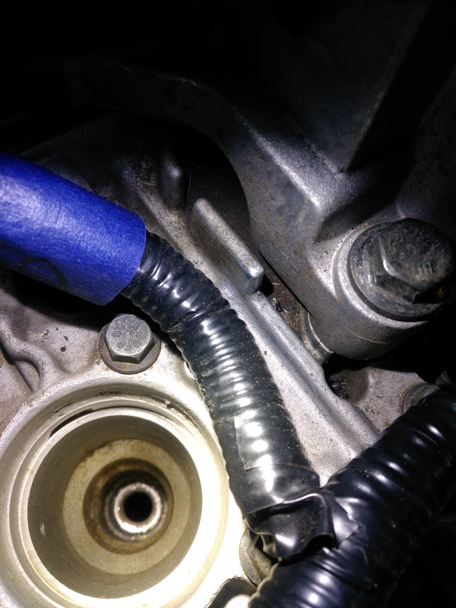

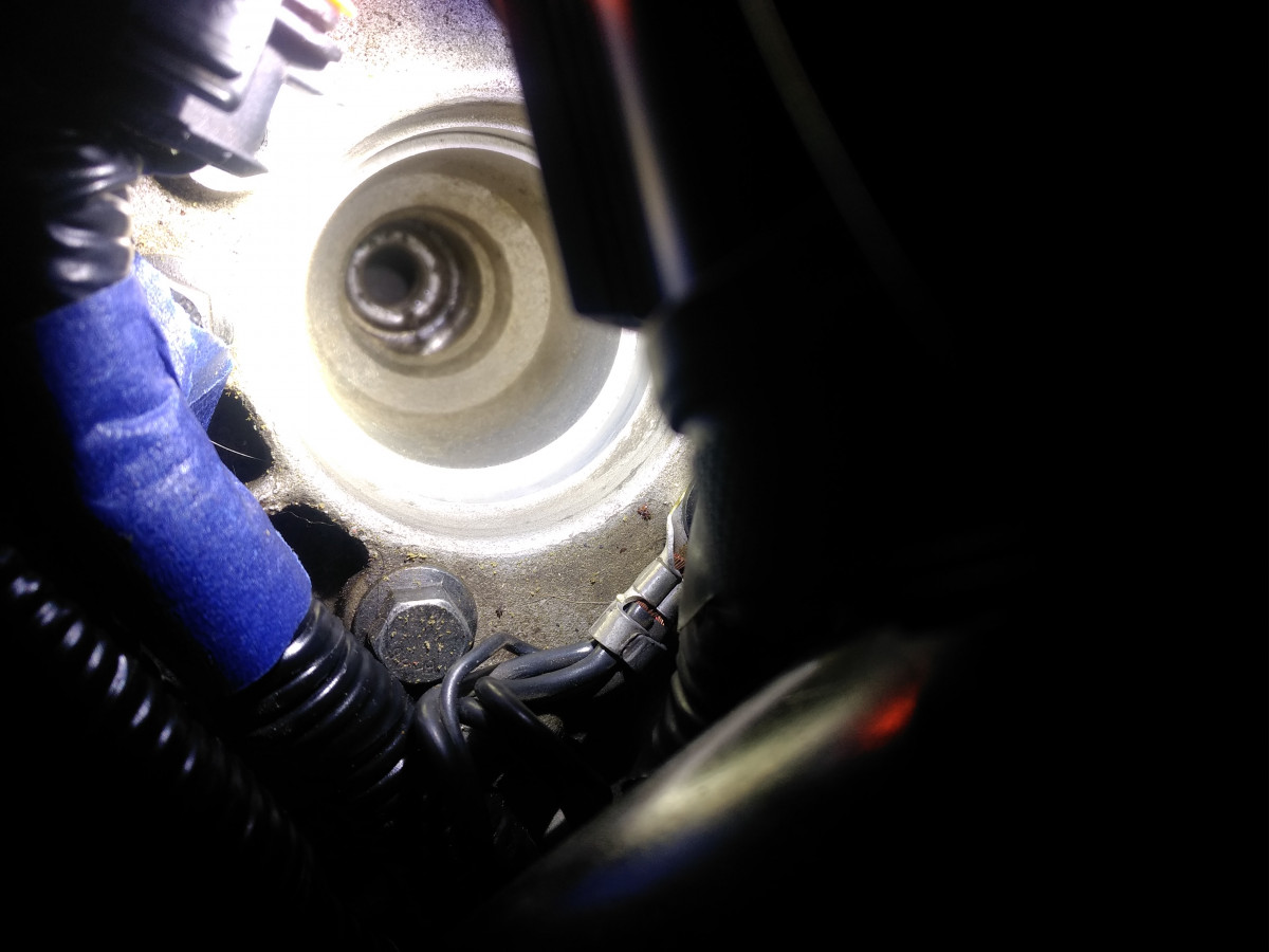

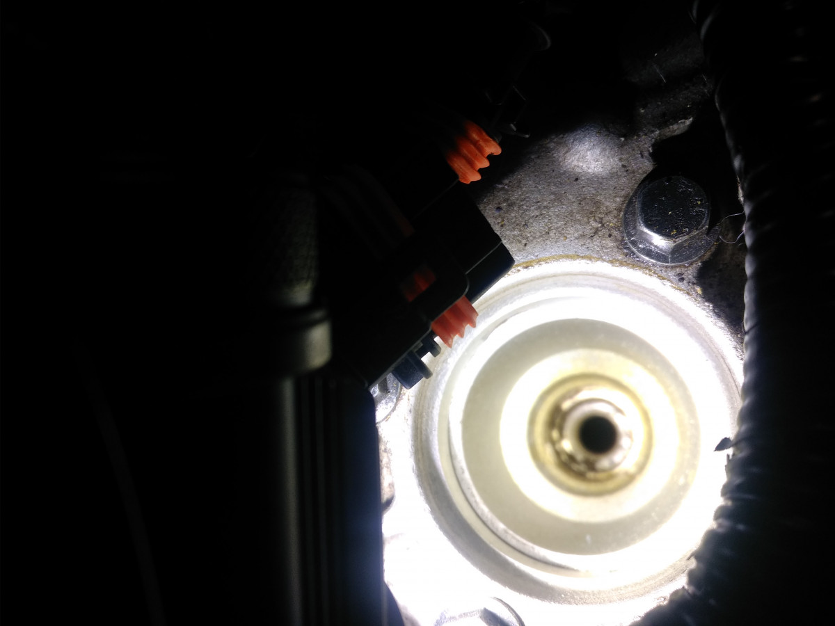

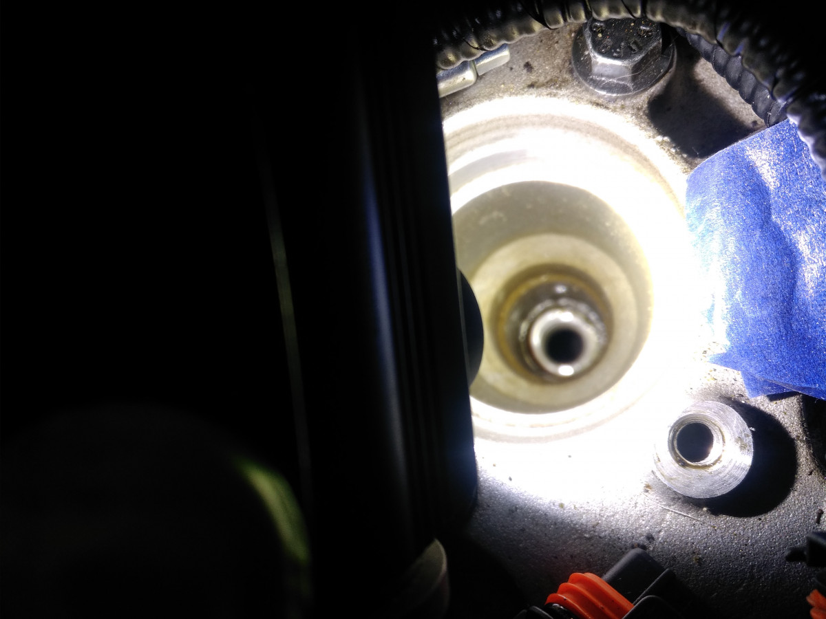

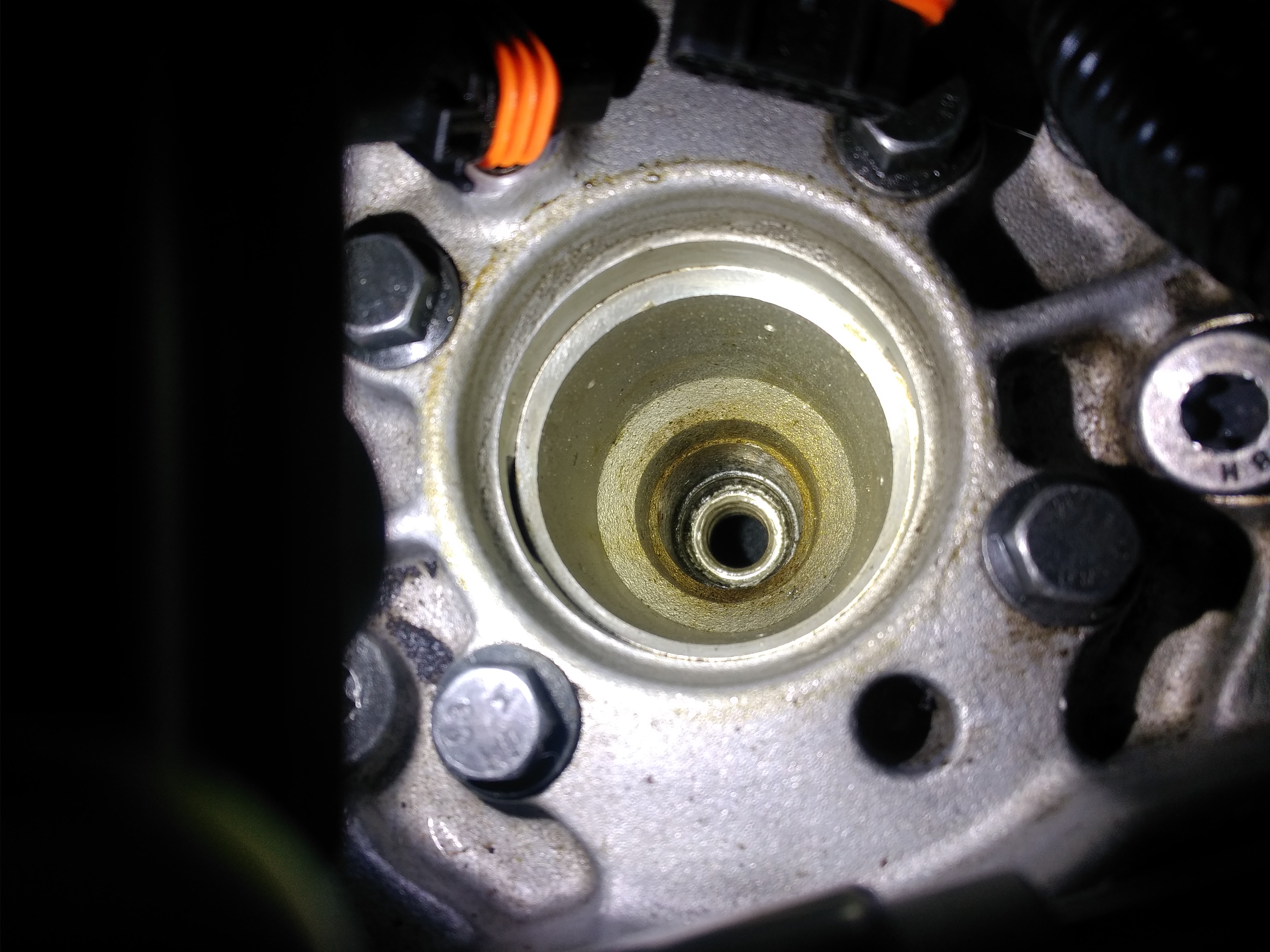

Ok, here are some images of the spark plug wells, plugs and the coils 1,2,4, and 5 starting with #1. Number 3 you seen already.
It is hard to see the top of piston,i will try with a light.Coil #1 and #2 are oily and wet but not melted, coil #4 and #5 are dry but #4 is melted by the plug just like #3 was.So it looks like coil 3 and 4 are both melted by the plug.
I am not sure if i am correct in actually numbering of each coil/cylinder but i numbered them 1 - 5 from left to right, picture 1 is first on left facing engine etc.
