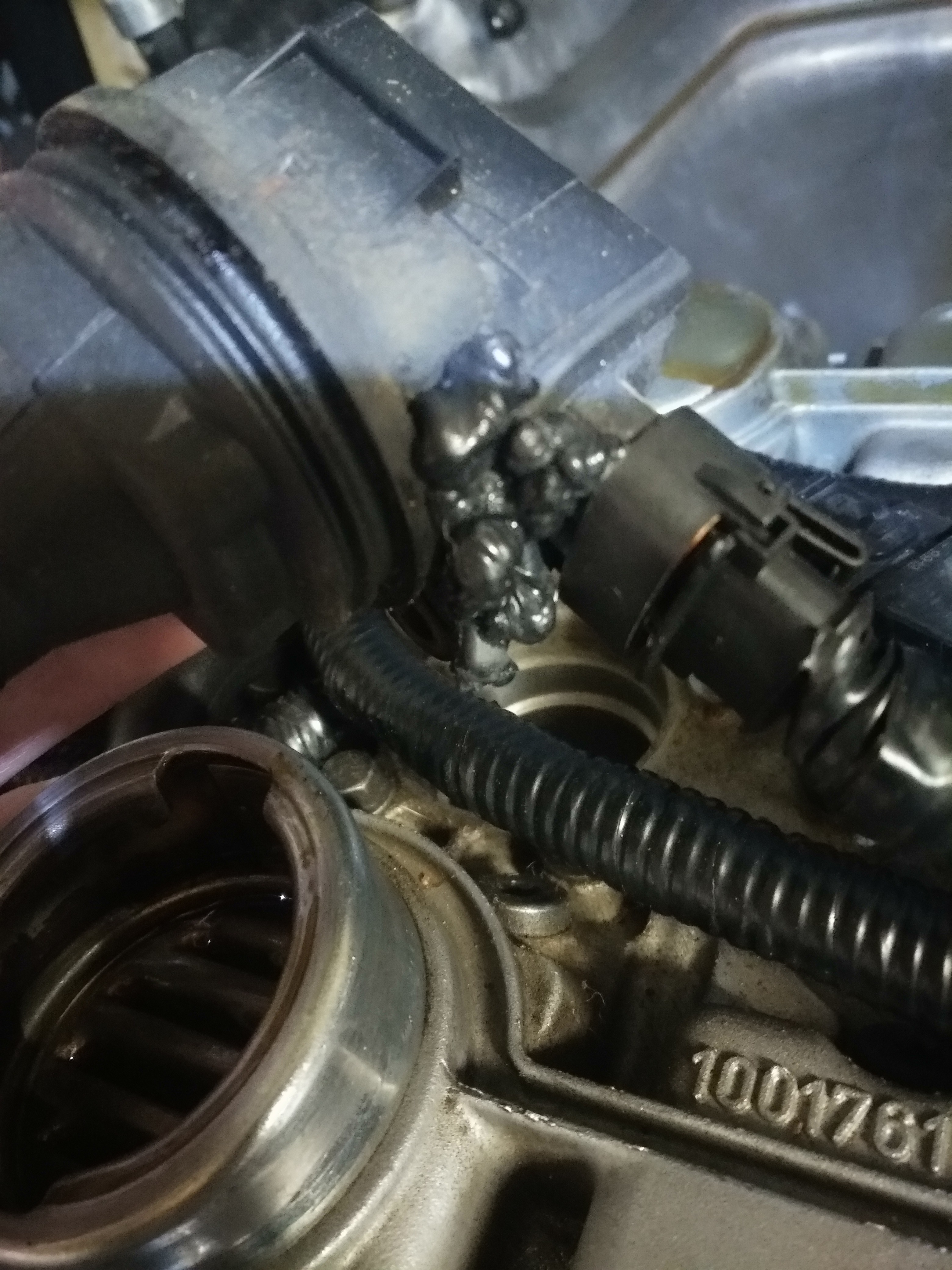

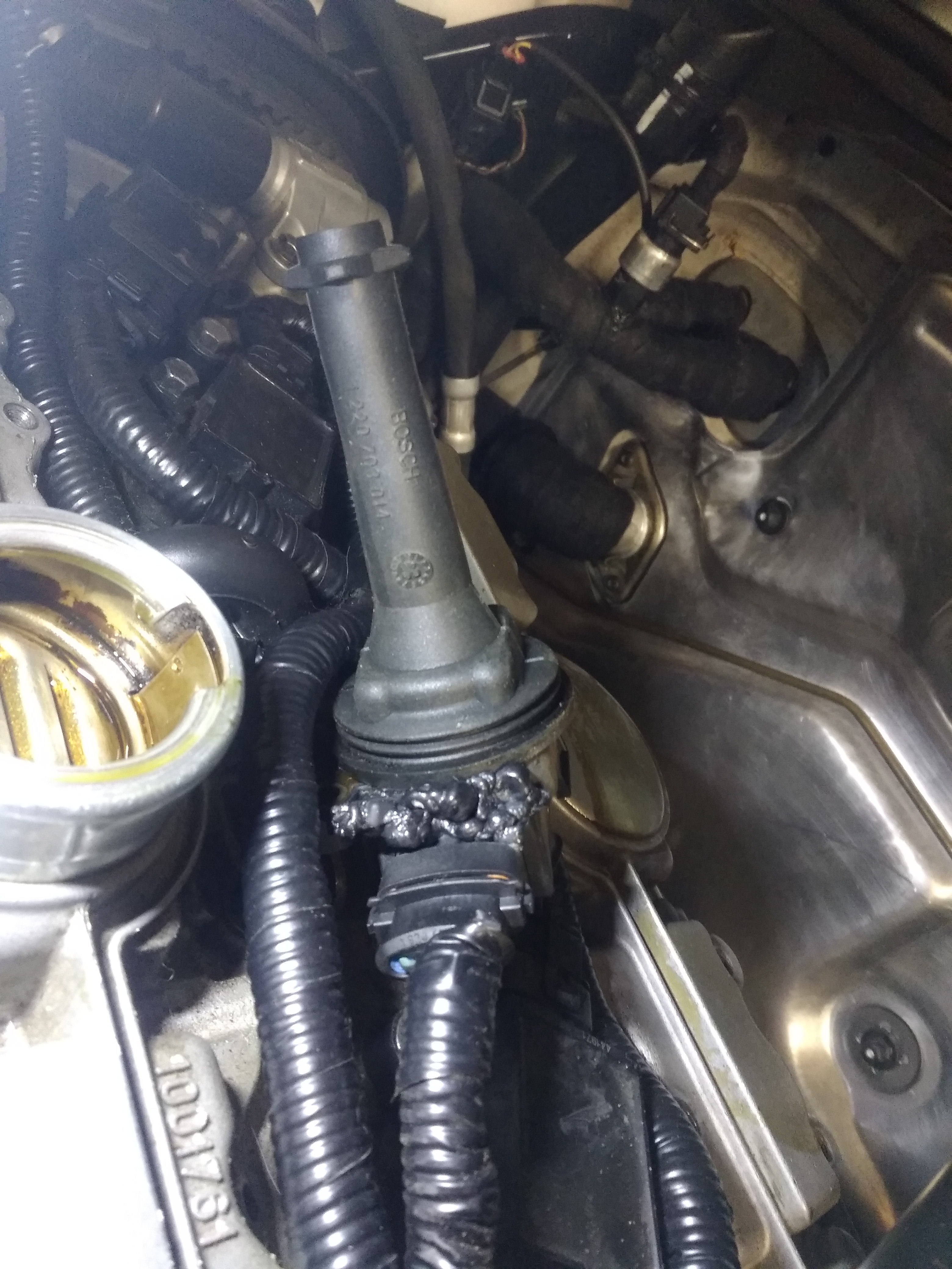

Whats going on with that coil? It looks like RTV gorped all over it for some reason?
- Posts: 15493
- Has thanked: 2202 times
OP said it has melted! I have never seen that before and can only suggest an internal short of some kind. I'd pull the spark plug and have a good look to see what it is like.
Did you replace any of the coil packs? Reason I ask is that I have heard of them shorting out. When I puled some out of a V70 I had a few years ago, they were full of cracks in their casings. One was causing a misfire. I ended up replacing them all, and cleaned the surface where the bolt for them goes through and connects to the head, and the head surface to make sure they were clean. This is the ground and again will cause a misfire if not clean and in good contact.

It was melted,never seen a coil do that before!abscate wrote: 01 Jul 2020, 08:32 Whats going on with that coil? It looks like RTV gorped all over it for some reason?

Neil,I have never replaced any of the coils, I guess I should use only Volvo Coils now that I need to replace them,or at the very least,the one that is melted.Do you know where I can buy the coil wiring harness at,the plug is melted to the coil so I would rather replace the harness if possible instead of splicing in a new aftermarket plug. Should I just go ahead and replace all the coils while i'm at it?
