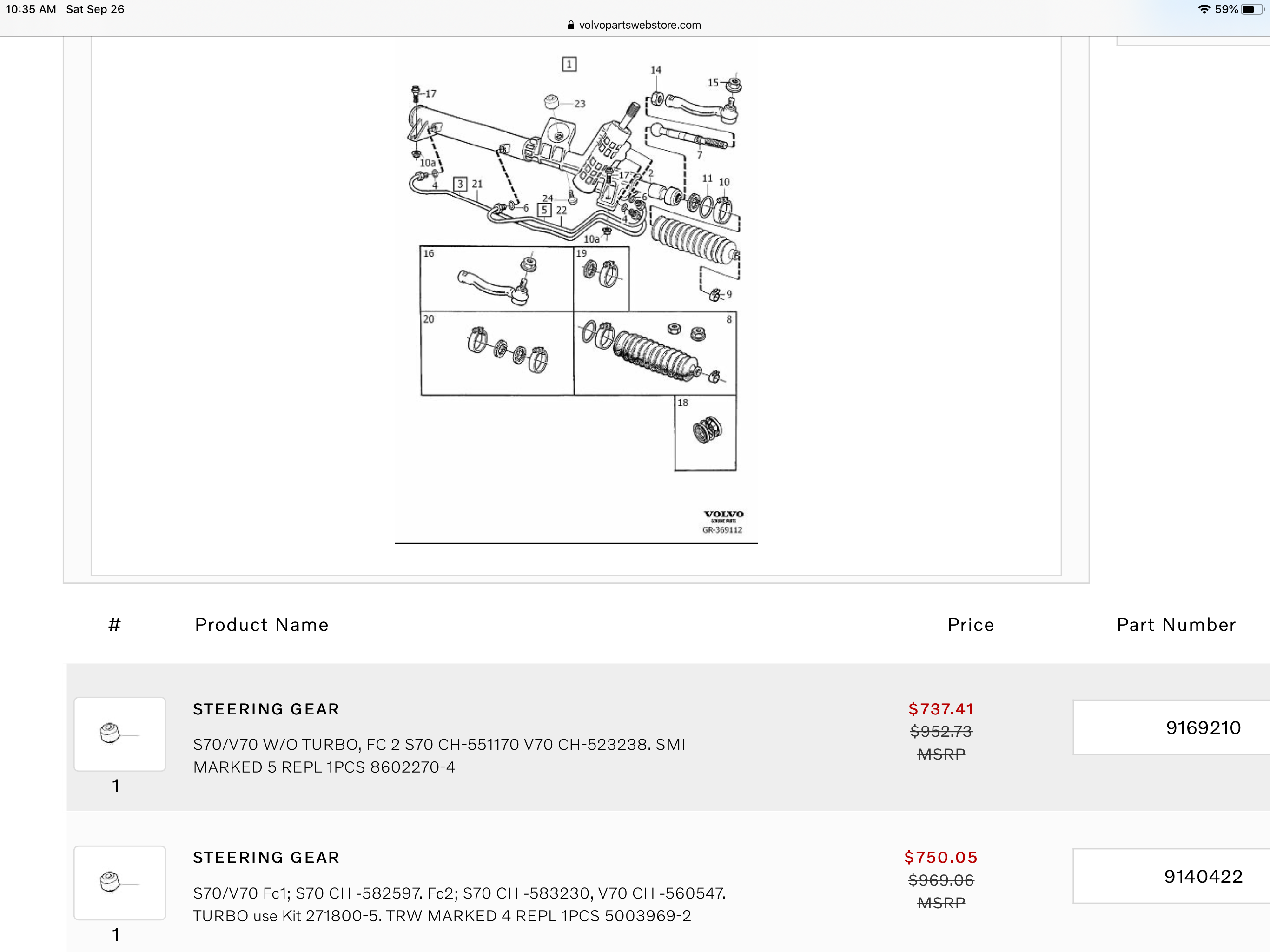

TRW and SMI racks are both listed in the Volvo web- store, with different part numbers
Someone pasted recently that you can tell them apart by looking at the cap on the end of the shaft gear

Here's the best consolidation I know of for using the hex cap versus round cap to make the distinction: viewtopic.php?f=1&t=75524 see especially pics on pages 2 and 3
And here's some good info from IPD about original equipment: https://www.ipdusa.com/products/5801/11 ... 413,T10029
And a quote of the most useful bits from the above mentioned IPD page, which supports the overwhelming (!) evidence that the racks are interchangeable:
"These models were originally equipped with SMI racks:
1999 S70 AWD with Chassis Number 572015 and higher
1999-2000 V70 AWD/XC with Chassis Number 549831 and higher
1998-2000 S70 FWD with Steering Rack Code "5" (Position 8 of Product ID)
1998-2000 V70 FWD with Steering Rack Code "5" (Position 8 of Product ID)
1998-2004 C70 with Steering Rack Code "5" (Position 8 of Product ID)
If you have an early 1998 S70 FWD or 1998 V70 FWD with 7 digit Product ID then your car originally came equipped with a TRW rack not SMI.
See attached technical article for more information regarding Product ID plate.
If the rack was ever replaced on your car, then it could be either style.
It's not a bad idea to buy both styles and simply return the units you don't use."
