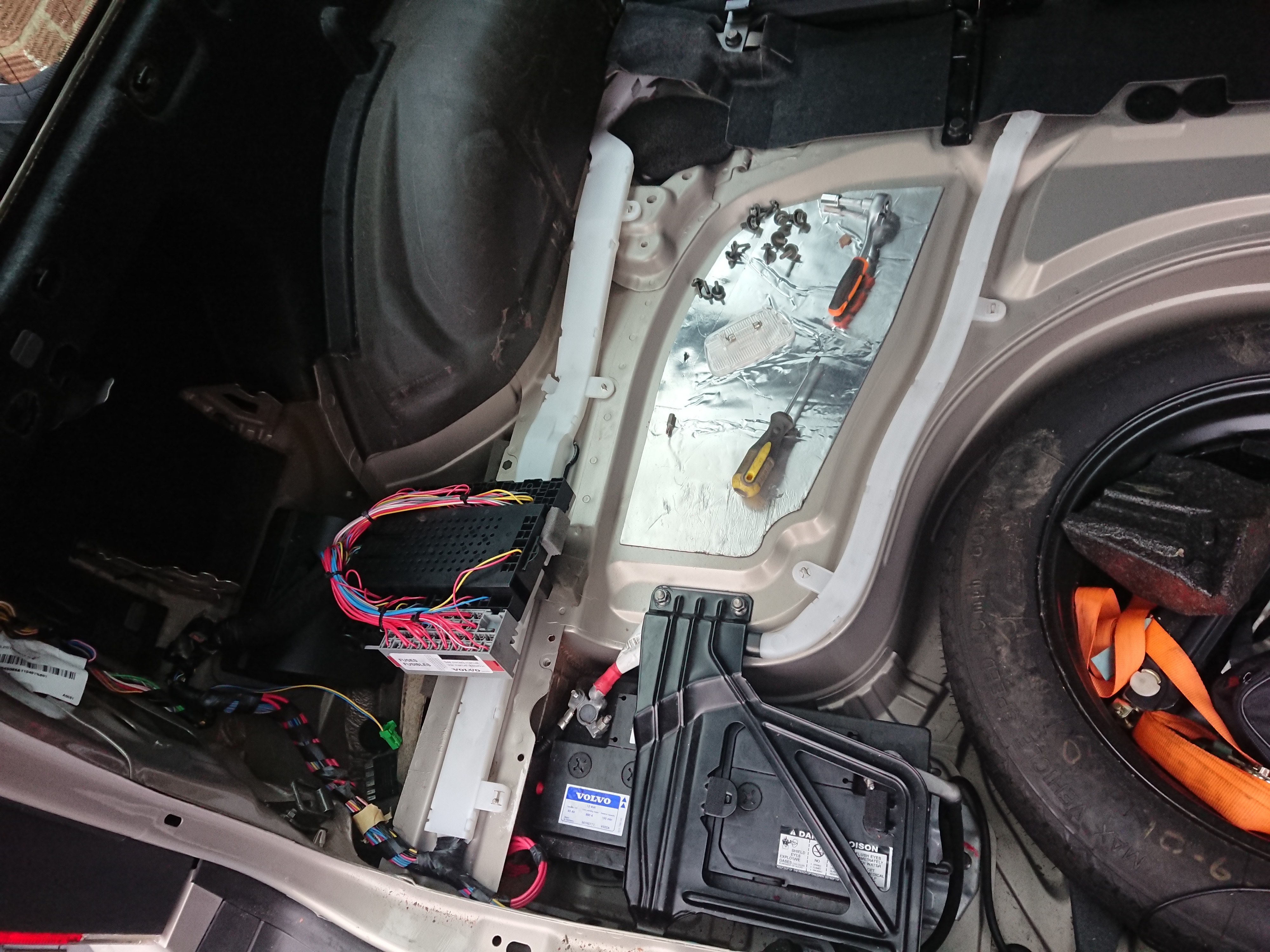

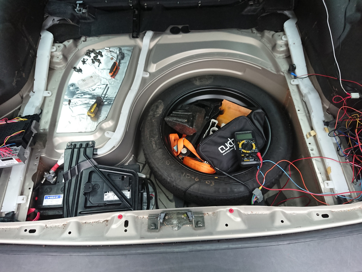

Lucy has had the backend gutted this morning... No broken wires. However I unplug the harness on the rem side back door by the earth points and all lights go out no further messages. So now I'm convinced it is a problem in the rear of the car beyond the back seats..
I don't even care if the warning system stops working is there anything I can do with the shunts to just kill the error reporting?

All the bulb out warnings you are seeing are related to each of the shunts in the REM. The REM monitors the voltage drop across low resistance shunts and if the voltage drop is less that expected you'll get the bulb out warning. If a bulb is out there will be less current and a lower voltage drop across the shunt resistance. I'm wondering now if there's just something wrong with the REM itself. If the REM is not measuring the voltages correctly (or some other problem) then you'll get the bulb out warnings. There are 5 shunts, 4 to monitor the lights and 1 for the 12V socket in the rear compartment. I think it would be difficult to do something with the shunts to avoid the errors especially if the REM is not measuring the voltage correctly. The middle part of the REM is the electronics and the replacement part new is close to $400 and I'm not sure if programming is needed for the REM, if not then a salvage part may work.ashleyg82v702001 wrote: ↑10 Dec 2020, 05:43 Lucy has had the backend gutted this morning... No broken wires. However I unplug the harness on the rem side back door by the earth points and all lights go out no further messages. So now I'm convinced it is a problem in the rear of the car beyond the back seats..

I don't know how interchangeable the REMs and if programming can be avoided. Hopefully someone else can provide this information, I do know the REM design is definitely different from 2005-on. One thing you could still do is disconnect the battery and pull out all the relays, shunts and fuses out of the REM and check for any overheating or corrosion on the leads and sockets.ashleyg82v702001 wrote: ↑10 Dec 2020, 10:09 OK, so are these interchangeable without programming if I match the part number (or do I need one with the exact same accessories from a different car? ) because I cannot afford to put another £500+ into the car like I did for the etm.

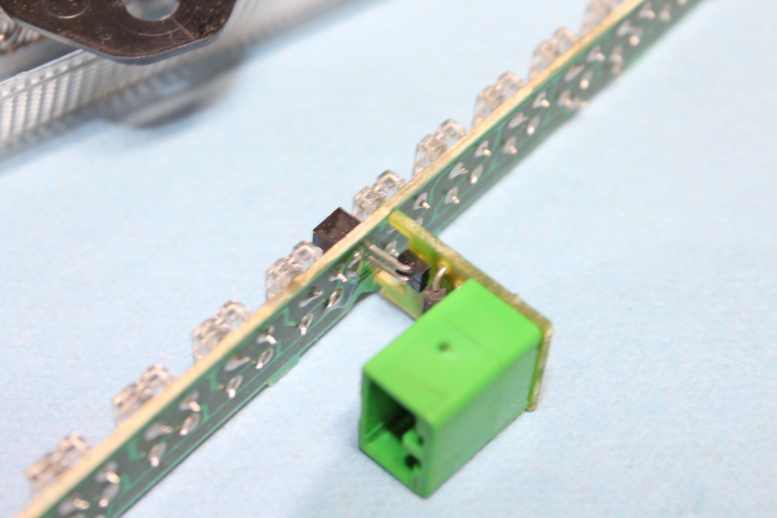

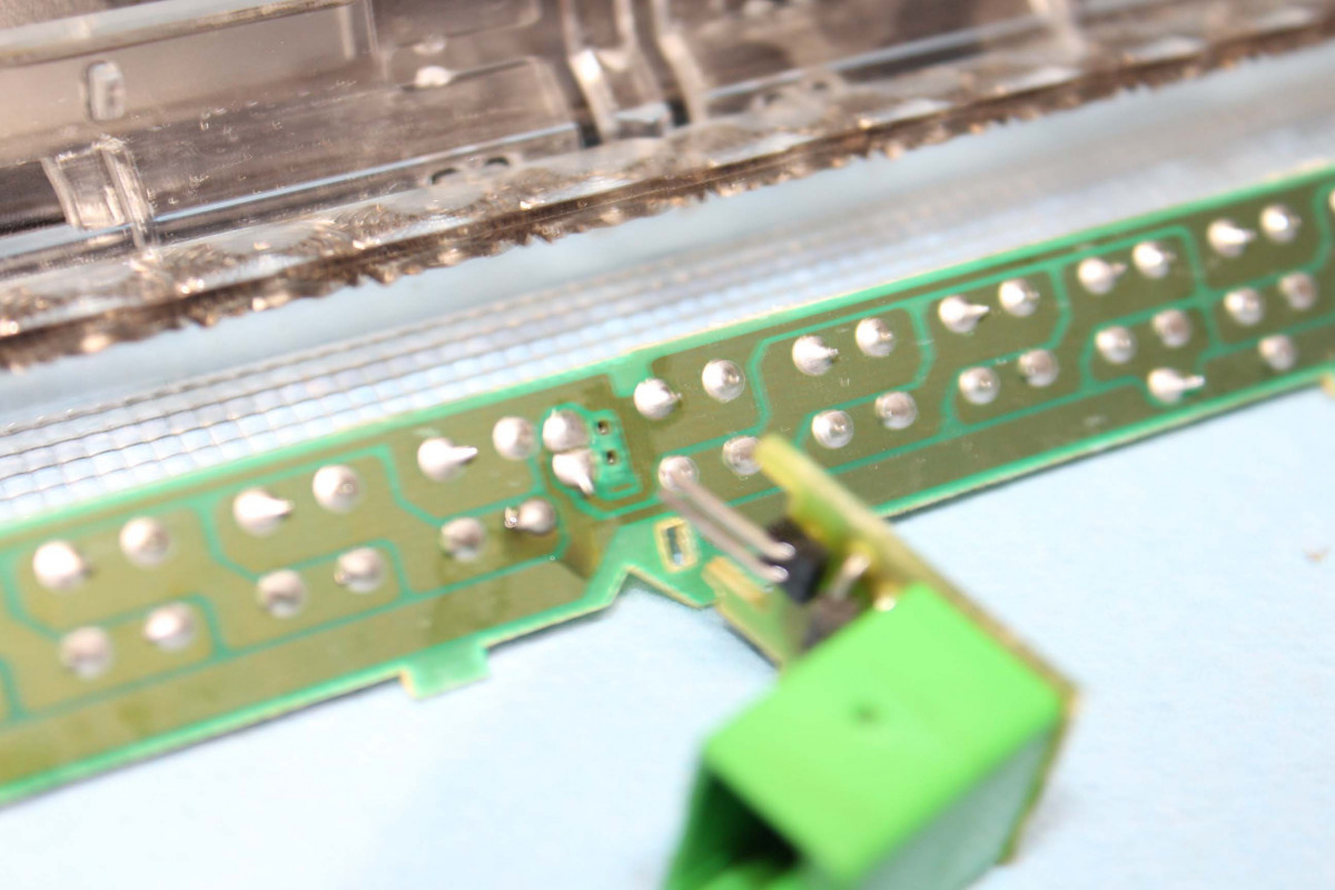

Just for reference, I had a problem with the 3rd brake light LED strip and an error in Vida for the signal going to this light. It turned out to be a connector that plugs into the LED strip circuit board. I cleaned the two pins that plug into the socket and all was well. The problem was the 3rd light wasn't working and if I tapped on the back of the tailgate near the light it would come on. It was an intermittent problem but mostly it didn't work. The LED light assembly can be taken apart to get to the two pin connector, it just snaps together. You have to pull off the inner panel of the tail gate, which is 4 torx screws and pry out the handle piece then remove this panel and pry out the top panel to get to the upper brake light.ashleyg82v702001 wrote: ↑10 Dec 2020, 11:06 This now confused me a little, looking through mathews and I see comments of the lower brake lights are controlled by the 'rem' but the high level is controlled by the 'cem' and the reader I have says its a brake light issue involving the 3rd light..... The cem is under the steering wheel, yes?
