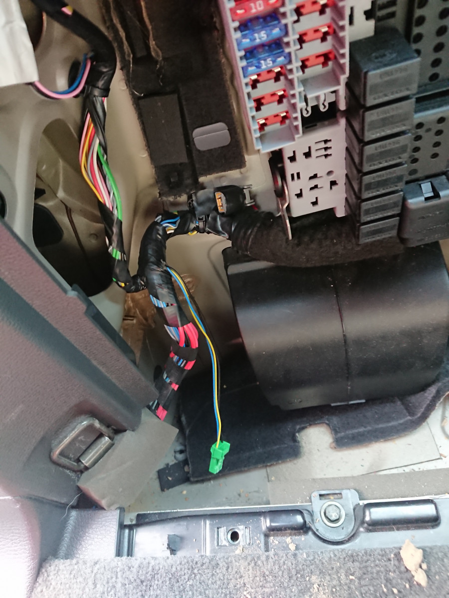

Still having this issue 😭 been investigating and found a three cable connector disconnected near the rem anyone got any idea what it is?

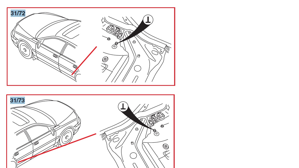

I can't find any earthing points at the rear of the car can anyone point me in that general direction for them?
I have removed, emeried and refixed all 6 in the engine bay (3 on either wing) and various others around the engine.
That made no difference.
Attached is where the ground junction points are for the rear lights, looks to be in front of the rear tires. I'm not certain what needs to be removed to get these ground points. If you don't mind what are all the lights with bulb out warnings? I'll look for what's common to these lights and what's not, it may help and since there's multiple bulb out warnings I have to think it's a common power or ground connection to all that give the warnings.

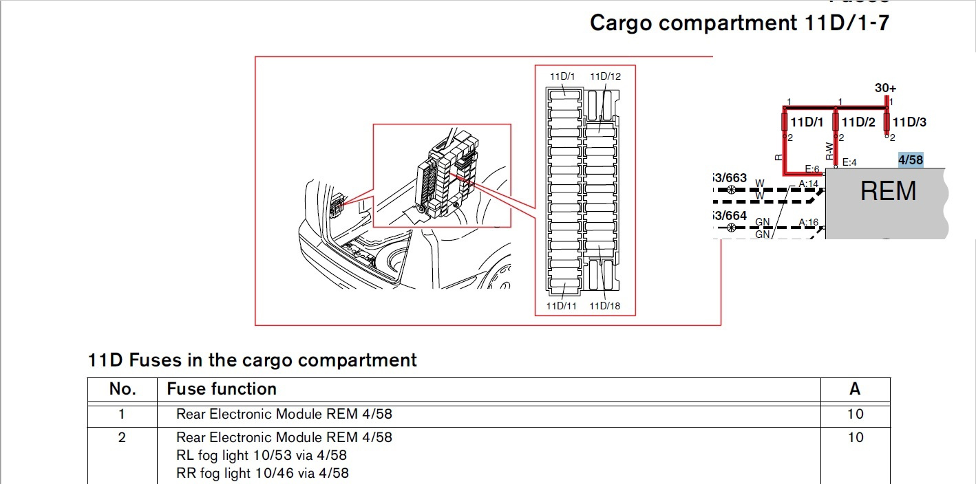

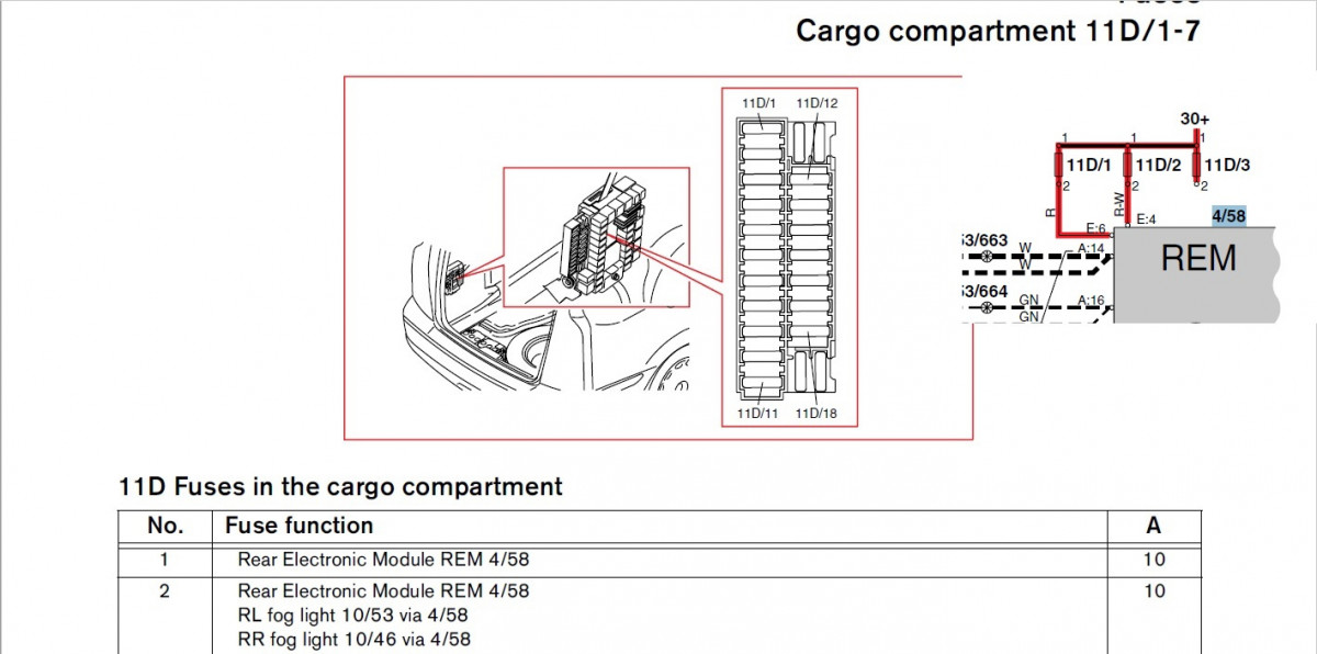

One thing you might do is check fuses 1 and 2 in the rear compartment. These are the power fuses to the REM. Make sure both are good and contacts are clean. These fuses are both 10A and if you're only able to do a visual inspection (vs a measuring with a meter) swap the positions of the fuses when you reinstall them to see if any difference in the bulb out conditions. For the position lights this includes the front, side, rear and license plate bulbs. There are two bulbs I believe for the license plate and 2 position bulbs in each tail light, are all these lights working? I've read some people can miss one of the two lights out in the rear tail lights and make sure both license plate bulbs are working.
