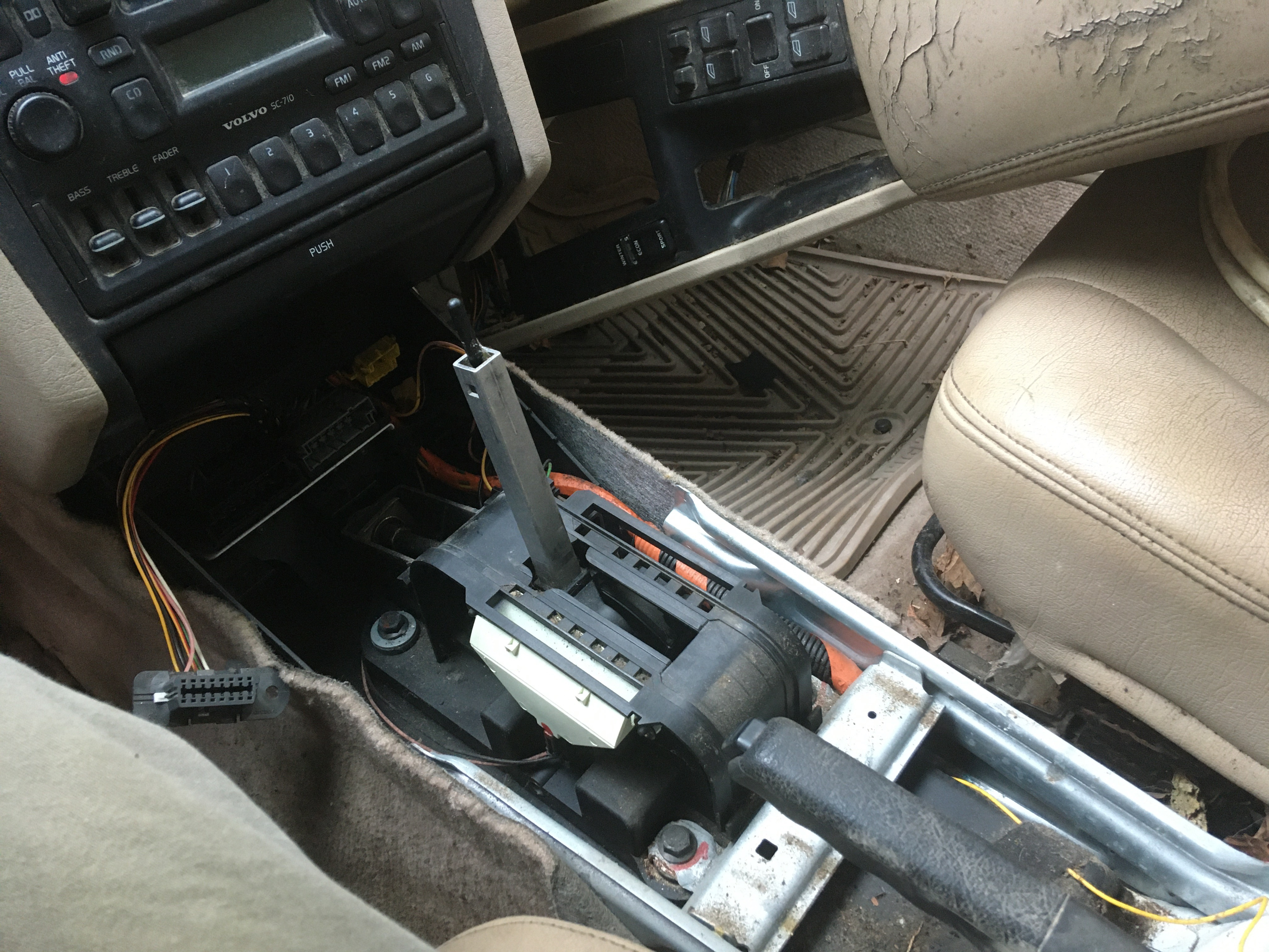

You need to get a helper to try and shift while you go the front and see if the linkage is binding. You might need to disconnect the linkage to see this.

Here's a Picture see that yellowish looking section of the mechanism -- similar color to the solenoid... IT looks like the solenoid moves out of the way (or shift lock does the same thing) and it is supposed to go down but it slightly moves up when I press on the rod (without the shifter in place)... Should I stick a screwdriver in there?

So seeing this (read above), even though technically my park job was pretty close to flat. The air having come out of my back tires. Does the air come more out of tires exposed to the Sun? And I might have been on like a 1/2 degree incline. This led me to consider that I had slipped back enough to be leaving the Parking Link -- or whatever it is -- too tight to let the shifter pull the cable.
So I not particularly strong 205 pound Man. Now that there is sufficient air in my tires, I bounced on the back of the car for a minute. Then I got in and thought how is this thing going to run without the console but then I examined the console windows and that one switch for sport winter economy etc...
So I started the Car and pushed on the rod a few more times and guess what. It released!
And honestly the grease in and around it seems enough but maybe I should spray some silicone in there too? Somewhere if any one has any ideas Where to? And amazingly my brain kicked in and said: You better drive this thing 3 feet you idiot so I did. And now it seems FREE. However I am really not in the mood to put it back together right now my back hurts I might play guitar instead. BTW, the shift rod as I am officially naming it is now sitting a bit higher up then before.
I might raise the price to 750. Actually I wish I lived on a bigger piece of property I wouldn't hesitate to get a windshield and get this thing inspected and keep it. I have an emotional attachment to it -- not only because it was a graduation gift at 36 getting my first degree (thanks Mom). But what I went through with it after my Mechanic inadvertently led me to learn about and perform a PCV system change on this all by myself thanks to Matthew's Volvos Forum. I'll never forget the day I was about to give up and realized the bottom bolt of the manifold cover was either horizontal or vertical and I had been feeling around down there for like 3 hours off and on. Who knows maybe I'll keep the car..
