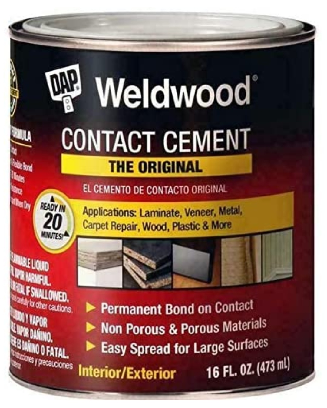

Is this what you're talking about?volvolugnut wrote: 03 Dec 2020, 09:36 Tips for door panel attachment:
After trying several adhesives, I had good long term success with contact cement on the door panels. A tip I found was to spread the contact cement on both surfaces and then just before assembly, use acetone to activate the contact cement. Acid brushes work well for spreading. The contact cement may take quite a while to get spread on both surfaces, but the acetone will reactive the contact cement when you are ready to clamp. Have all the clamps planned out before applying the acetone.
Scrape down to the wood material to get good adhesive grip.
- Posts: 6510
- Joined: 19 Jan 2014, 09:51
- Has thanked: 987 times
- Been thanked: 1075 times
I actually used Pliobond brand contact cement. Any brand will likely work.
