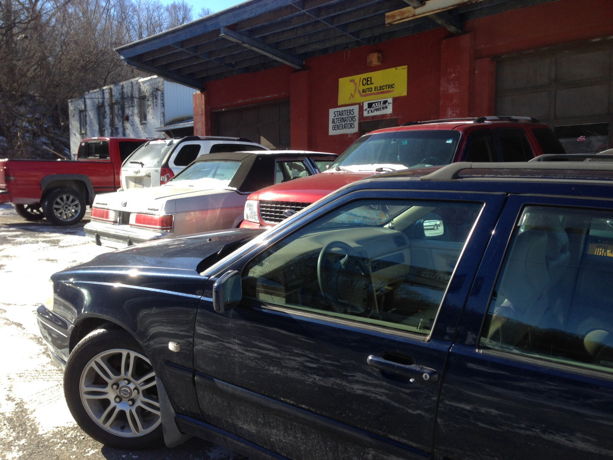

Nasty, but the tool comes free in the tool kit with Willow Green XC if you can find one nearby.Blacklab467 wrote: 03 Mar 2021, 07:35 I think it's probably something simple like that. I'll get some new brushes and bearings and rebuild my spare now in the meantime. How difficult is it to get that pulley clutch thing off?
I think Wisechatmgr and I both stood on the alternator to counter hold my 1999 pulley, and neither of us is Twiggy. Watch out for LH threads , too.
I’ve got the real deal 20 minutes away....
