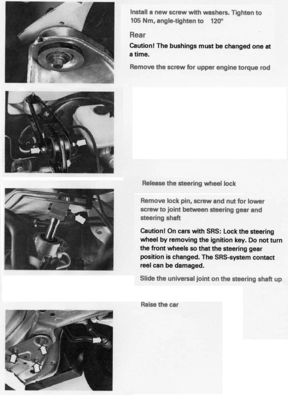

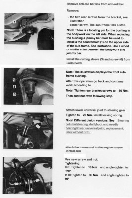

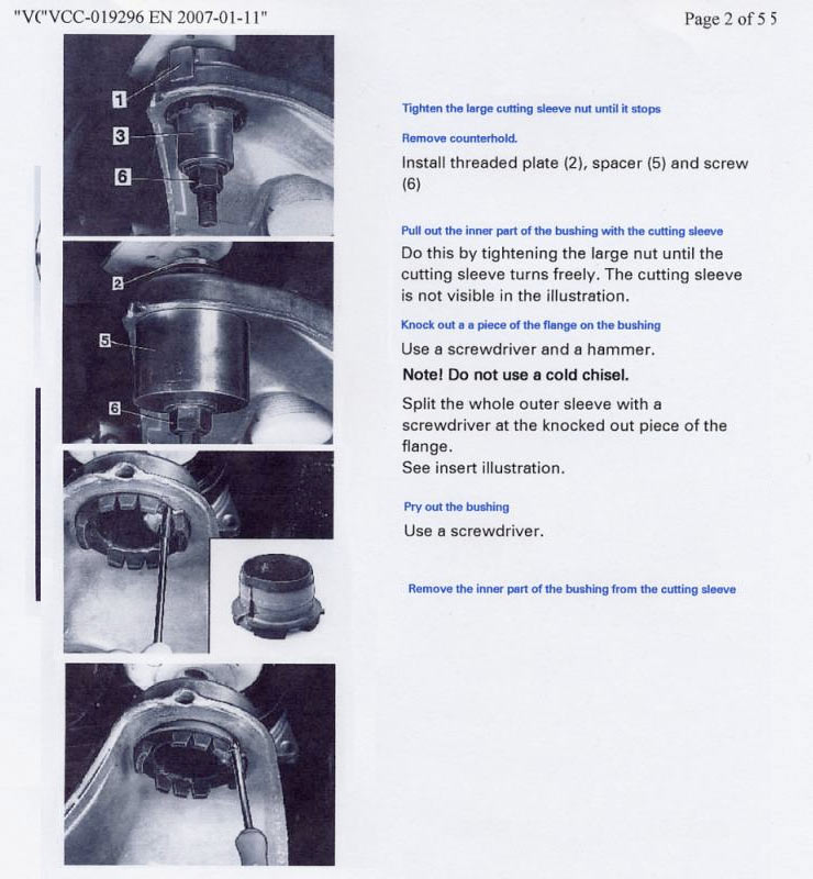

Here are Bill's pages modified slightly in Photoshop to be ideal for printing. They are 8 inches wide.
- page1.jpg (79.09 KiB) Viewed 6084 times
- page2.jpg (85.79 KiB) Viewed 6081 times
- page3.jpg (111.92 KiB) Viewed 6088 times

Doubt your abilities you do, young Jedi. Good were the files you attached. A bit wide, but too wide not.billofdurham wrote:I now go, cap in hand, to the boss and ask him to reduce them.

To finish this topic here are the two pages that went walkabout: Bill.

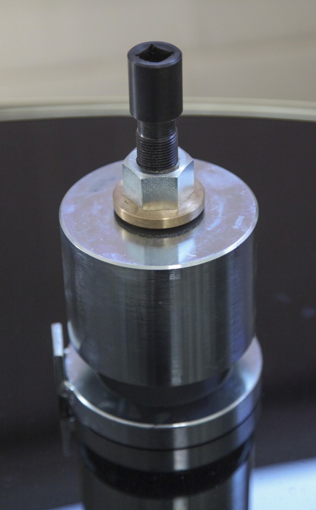

I just spoke with a guy out in San Jose, California who has about ten (yes, ten) brand new Volvo subframe bushing removal/pressing tools (Volvo p/n: 9995457), as a result of having bought out a distributor some time back.
He's looking for $150 each (plus shipping if you aren't local).
Contact information:
Rob Dietsch
rob AT dietschwerks DOT com
Dietsch Werks
521 Charcot Ave, Suite 251
San Jose, CA 95131
408-355-0081
