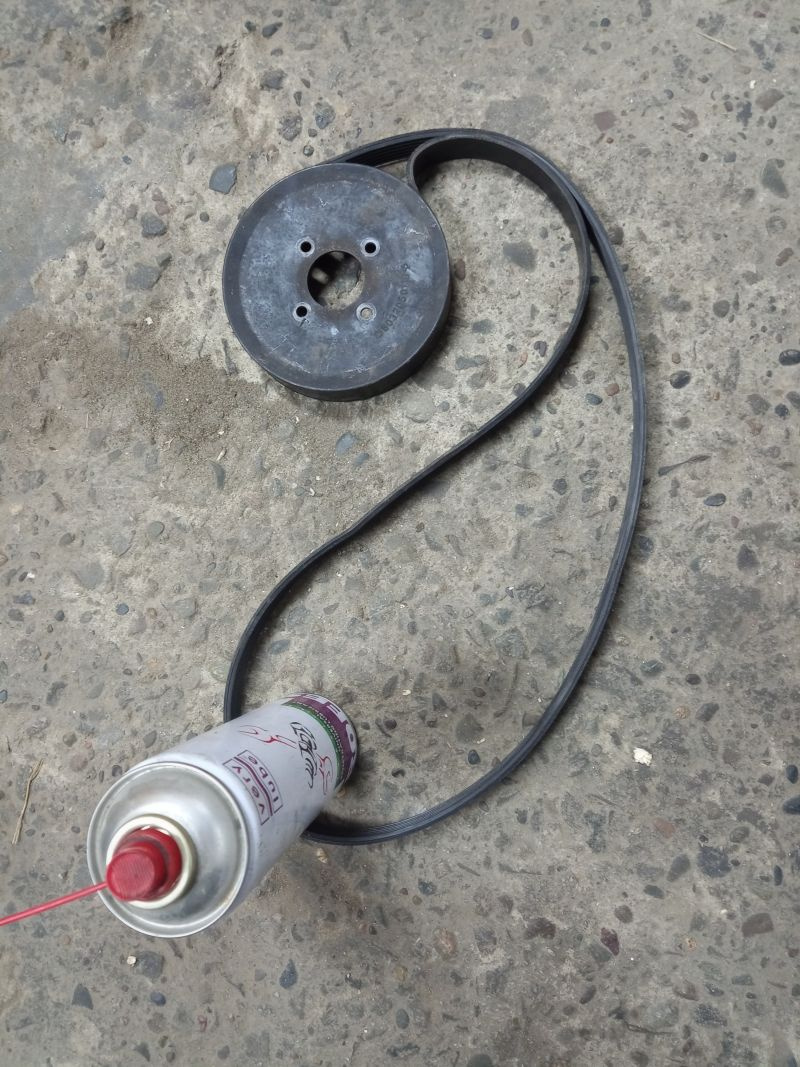

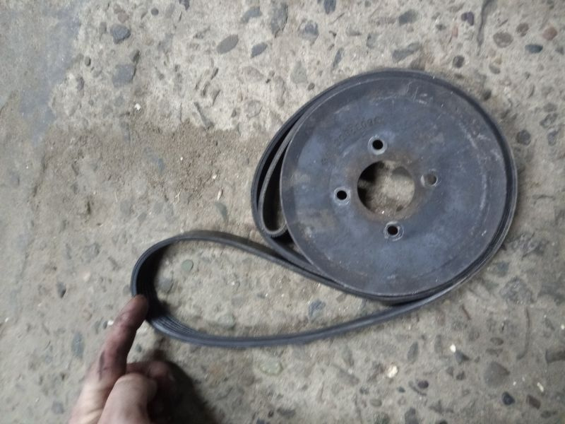

My way to hold any pulley in any direction using an old belt
Free end of a belt should be placed at any strong part of engine

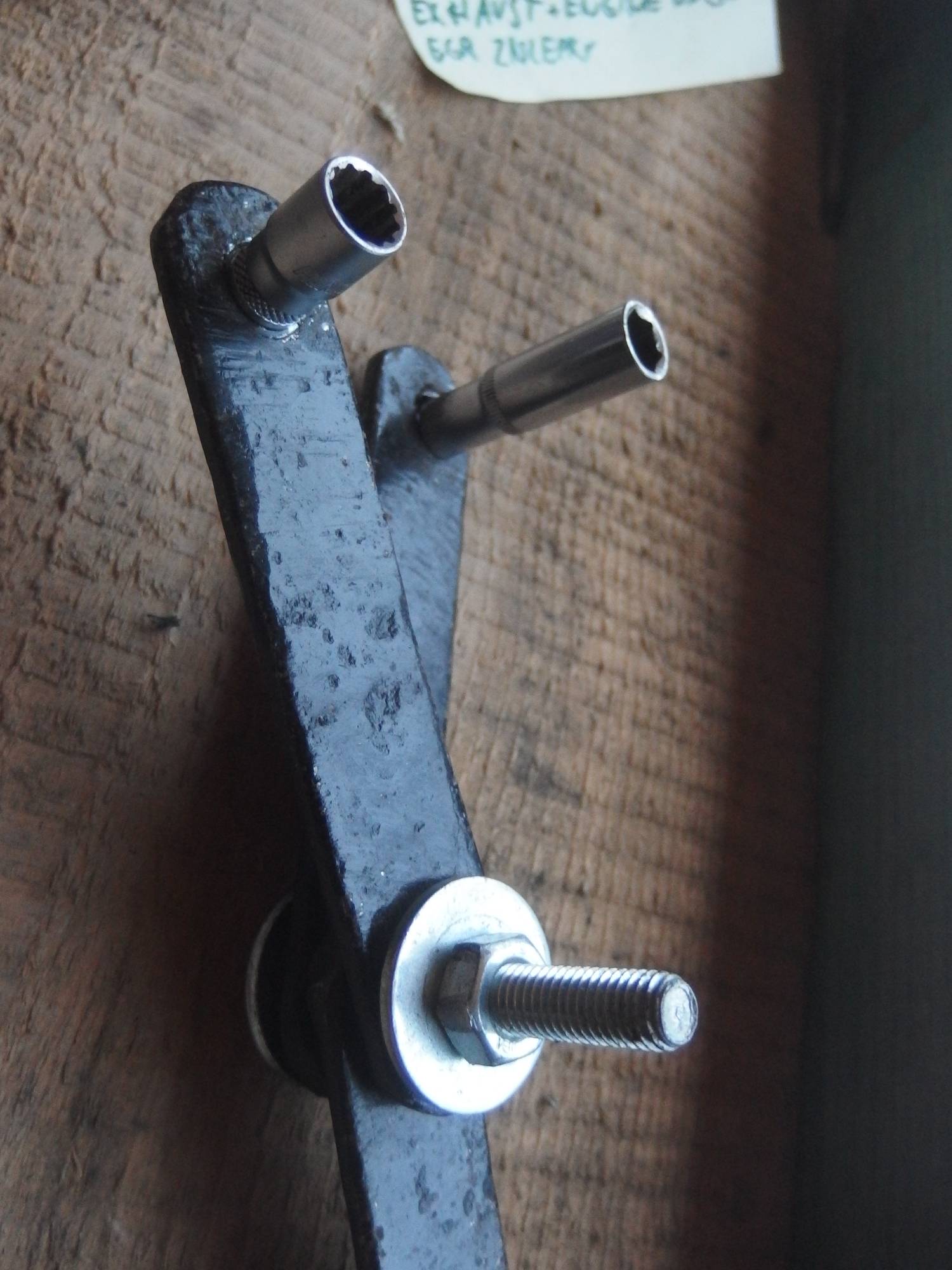

I thought I had a photo of the tool I made to hold the crankshaft, but I cannot find it. It is simple to make. I used about 1/8 x 1 x 1 inch steel angle (but other sizes will work). A Y shape is made from a short length and a longer length. Both angles at the top of the Y have holes to match two of the four holes in the crank pulley. Two opposite bolts of the pulley bolt through the end holes. The two angles are joined by a pivot bolt at the middle of the Y. The long end of the angle is braced against something (or held with a cheater bar) to prevent rotation of the crank while torquing the crank nut.

About tightening the crank nut on the engine. I have made a good tool that worked for me perfectly. You just tap the Y ends with 10mm sockets on the pulley screw heads while the middle of the tool has long M10 rod that will stop at the engine mount side and will safely lock the engine so you can tighten the crank nut to180Nm (on 850) with torque wrench according to manufacturers spec.
