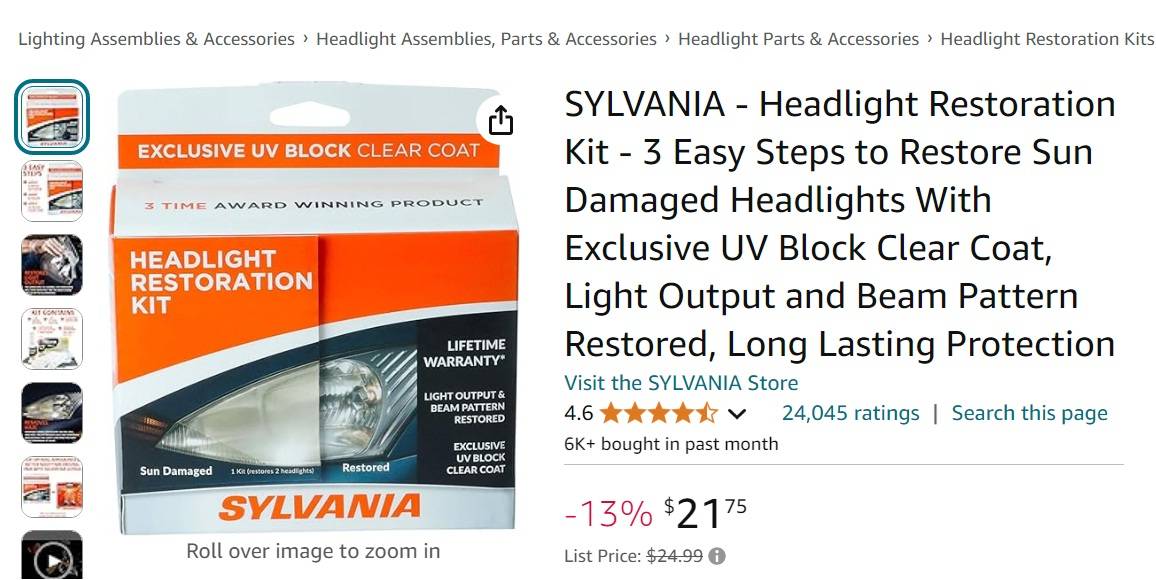

This is not unique to Volvo S60 but any car with plastic lens.
I just used this Sylvania product ($21 online) with great results on my 2006 Volvo S60 and 1998 BMW 528i
with great results.
In theory, all you need is the clear coat bottle bc sand paper (included in the kit) and the so-called conditioner (included in the kit) are not that unique.
- What is important is to sand it down to the finest sand paper.
- Then rinse with water and dry it.
- Then the clear coat goes on (watch the youtube video but basically similar to wood varnish).
The clear coat has the smell of varnish (polyurethane) that ppl use to varnish wood floor.
- One kit is enough for 4 cars!

I've done this a few times now, but I don't use the clearcoat anymore. Instead I buy Laminex UV protectant film, which lasts much much longer. The sanding process is quite time consuming, and I don't want to do it again every 2 - 3 years :wink:

Now I know the tricks, I can do this 15 min per side.
Every 2-3 yrs, just sand a bit, clean, dry, then apply the clear coat.

cn90 wrote: 04 Oct 2024, 07:33 Now I know the tricks, I can do this 15 min per side.
The last time I did this, the previous owner used the clearcoat, which didn't even last 2 years. The remnants of that were a bear to remove, the stuff gets rock hard and it was a thick layer. It took me an entire Saturday morning to sand a pair of headlights. Hoping to never have to do that again. How do you do this in 15 mins.?

This thingy is almost like a wood floor varnish.
Lightly sand, wash, clean, dry then new coat.
No need to make a science out of it for me.
