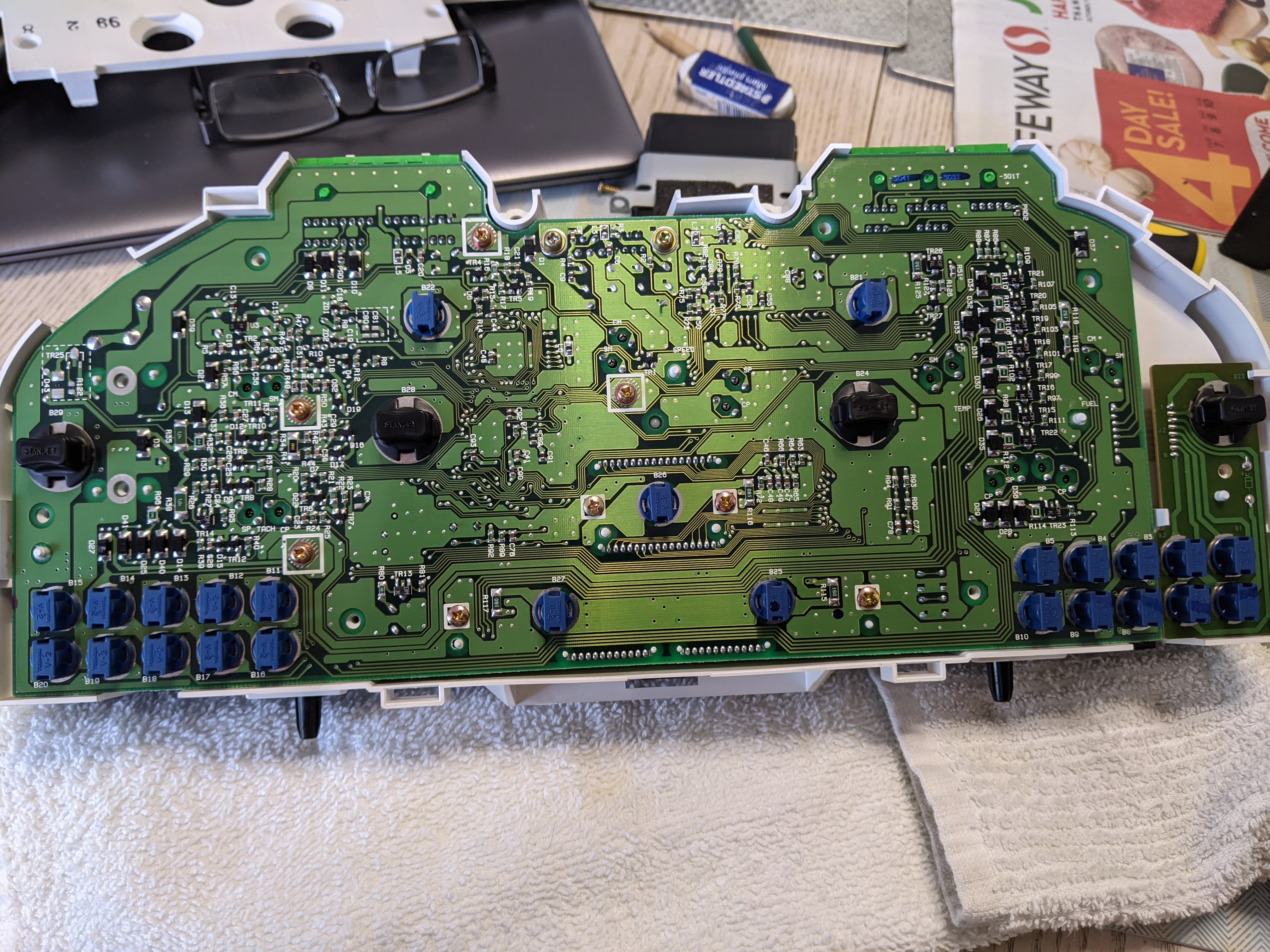

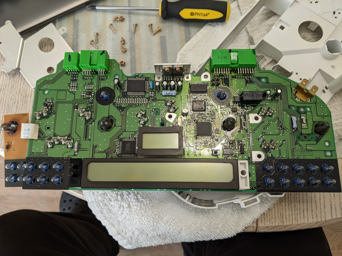

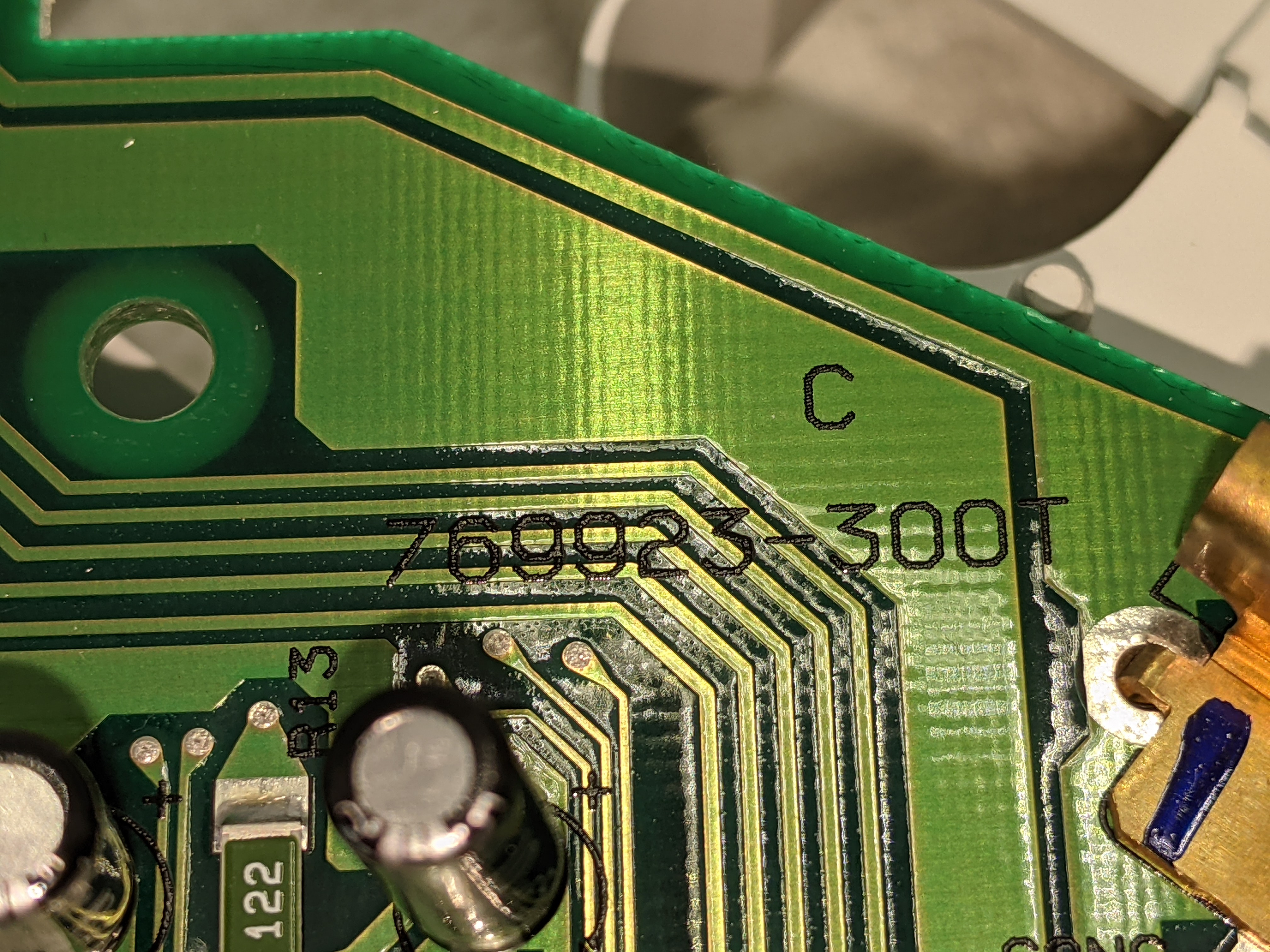

I have looked at the pcb and can not find any identifiers so that I know for sure if the circuit boards are the same throughout on 98-00 or at least MY99-00. Ideally it would be great to confirm all of it. I have asked a parts guy who is an expert on Volvo stuff and getting answers to see if he can help.

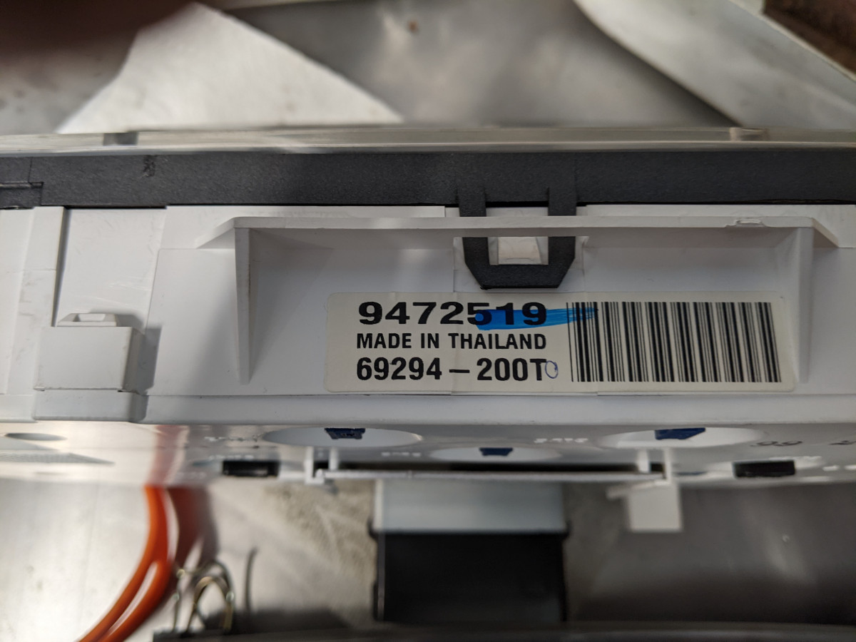

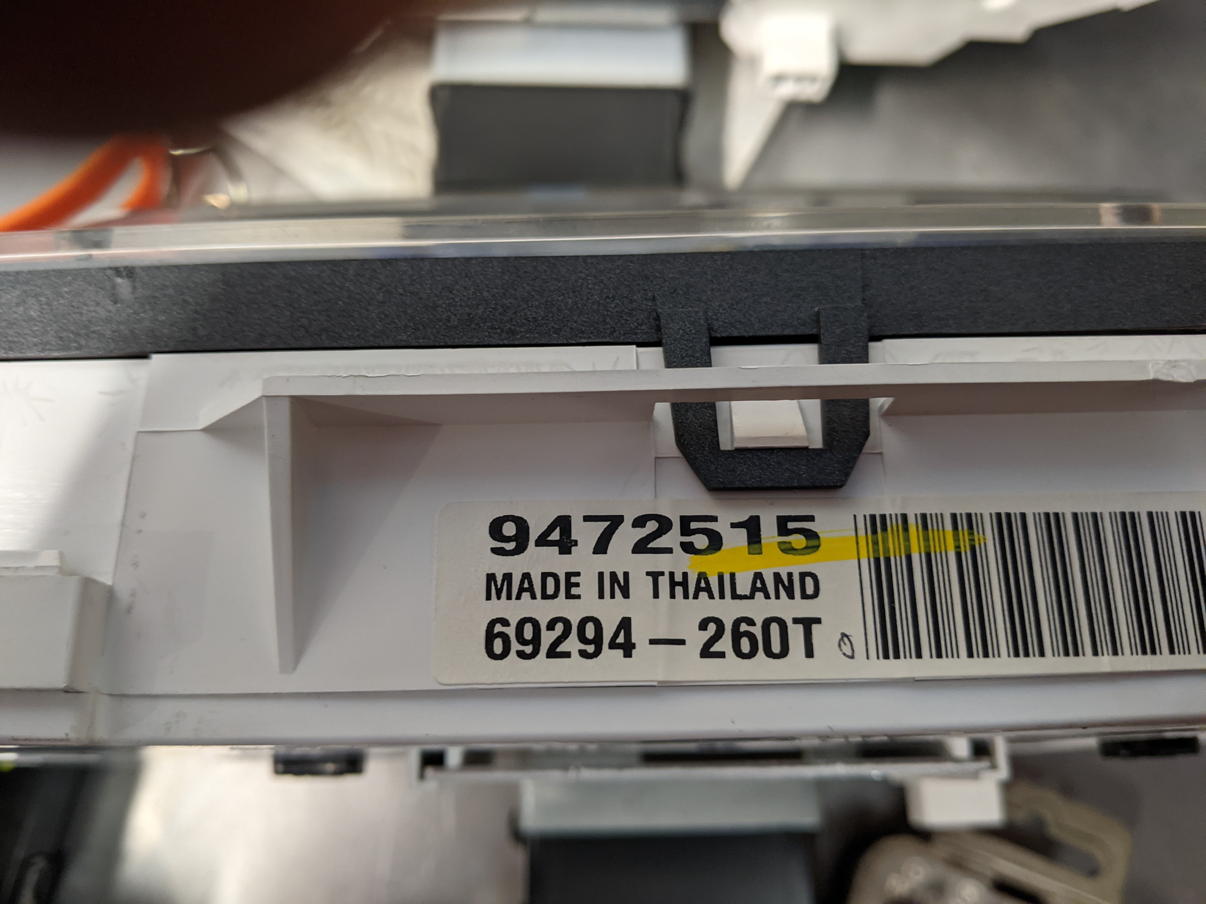

So far I cannot find part numbers for the whole DIM units. Volvo has NA against the whole unit. Don't know if it has always been like that but there are part numbers on the whole unit casing which I cannot find a description for. That may help to identify and confirm if all units or at least some used the same pcb as a base.
I may have got that the wrong way around. I thought a picture I had showed the front of the unit with the number on it but hard to tell if it is 'R' gauges or normal black ones. Sorry!
You can see these have different part numbers but I cannot find any reference for those.
I know US and CA units have different warning lights and symbols but not sure if you can transfer a US to CA or reverse and it may work on an identical spec car.
I am nothing if not stubborn, and will continue to try to get definitive answers!
I have tried talking/e-mailing Xemodex on the subject as they seem to claim to re-flash units for 99-2017 V70's but they do not show a picture of the P80 unit which makes me question this. I have e-mailed them for clarification bu after a week have had no reply. Phone calls go to a voicemail but they say it is seldom checked, maybe once a day. Have to say their tech support sucks!
The pcb

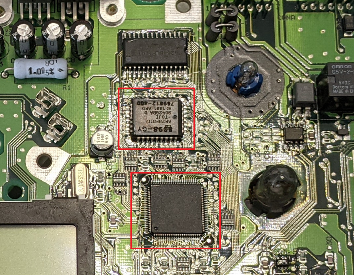

Your car has P80 platform. This module has name us CDM (not DIM). Unfortunately, we do not have solution for online cloning this kind of modules, pretty old module actually ((
We can transfer data to used module only if we get it to our lab, use direct connection to PCB.

I think we can transfer data from your original CDM to used CDM. You can send us PCBs only, but you have to mark each to exclude confusing. Also, if you have soldering experience, you can do it yourself, just transfer couple chips from your original pcb to used one.

In my younger days I would have done the chip swap (used to work in chip then board manufacturing) but hands no longer up to this.
May take a while, but maybe I will see if I can find 2 used boards and see if you can swap info from one to the other. That way we will hopefully find a way around this issue going forward. I will try to find a 5 speed as that should still work in my car with the trans and that way on it's return we could verify info transferred ok.

Options:scot850 wrote: 19 Oct 2021, 15:42 In my younger days I would have done the chip swap (used to work in chip then board manufacturing) but hands no longer up to this.
1. Take the two PCBs to a computer repair or a cell phone repair shop and have them swap the chips for you.
2. There are at least five places in Calgary, Alberta that specialize in Automotive electric. One of them might do automotive electronics also.
