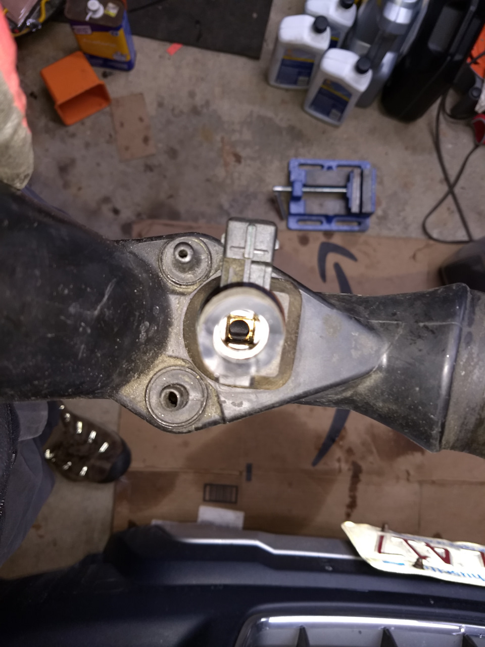

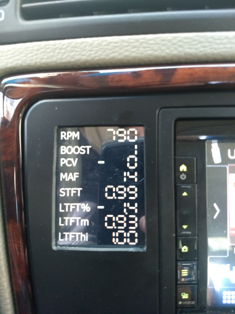

Years ago I've built myself an extended CAN-bus monitor: https://github.com/vtl/volvo-ddd/ It reads/displays a lot of sensors, so I can keep an eye on things like fuel trims while driving. No need for DiCE/VIDA.
Before the engine died, it has got all the new sensors, so I knew they are not "tired".

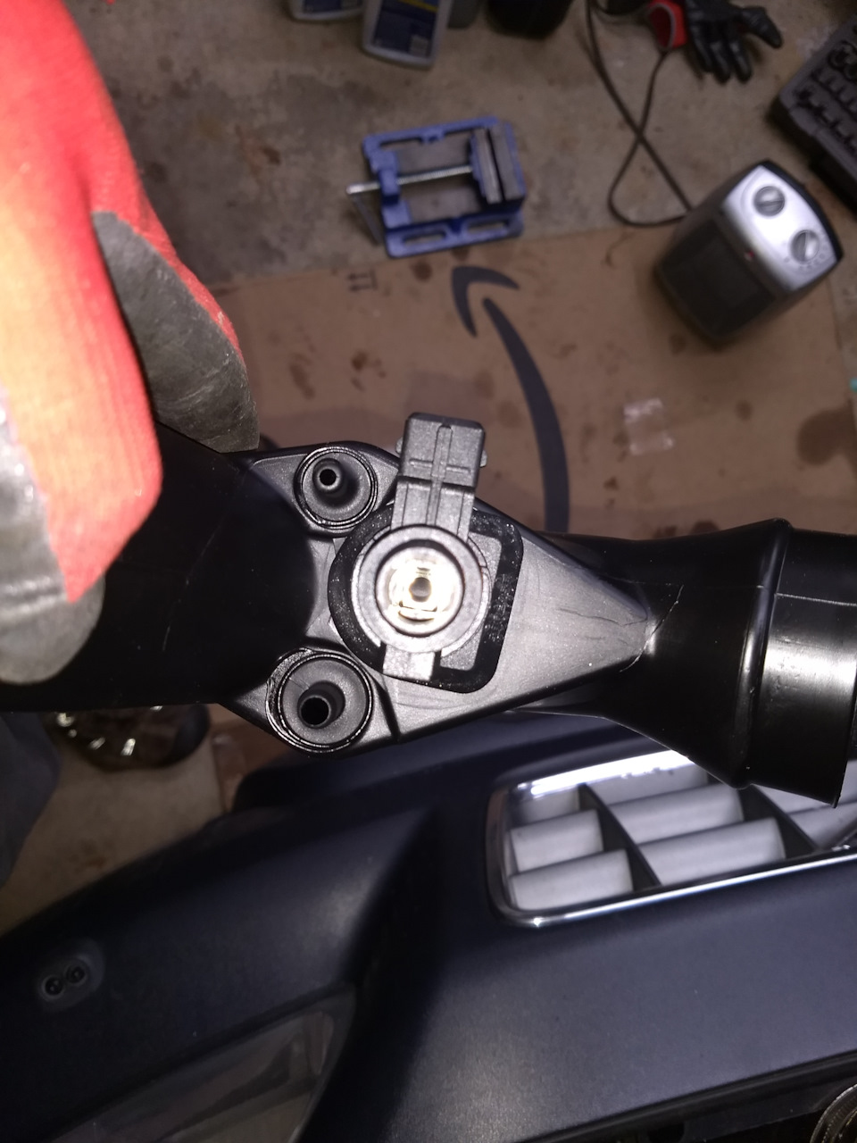

After the rebuild the fuel trim went slightly off. The only thing that changed was the new piston rings and re-honed bores, so the amount of blow-by gases went down, the crankcase got more vacuum, it started to pull more air from the long PCV pipe, which is not as restricted as it was before, because I filed that PTC hole to its max. Filed from this:
To this:

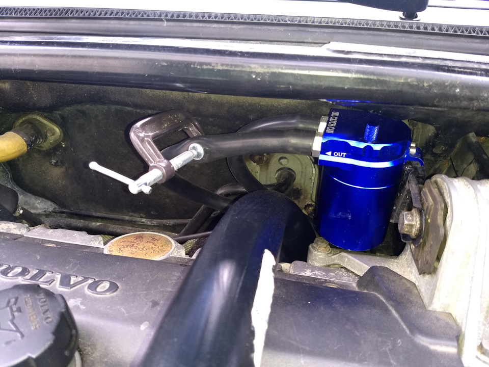

In order to verify my hypothesis, I partially clamped the oil catch can hose:

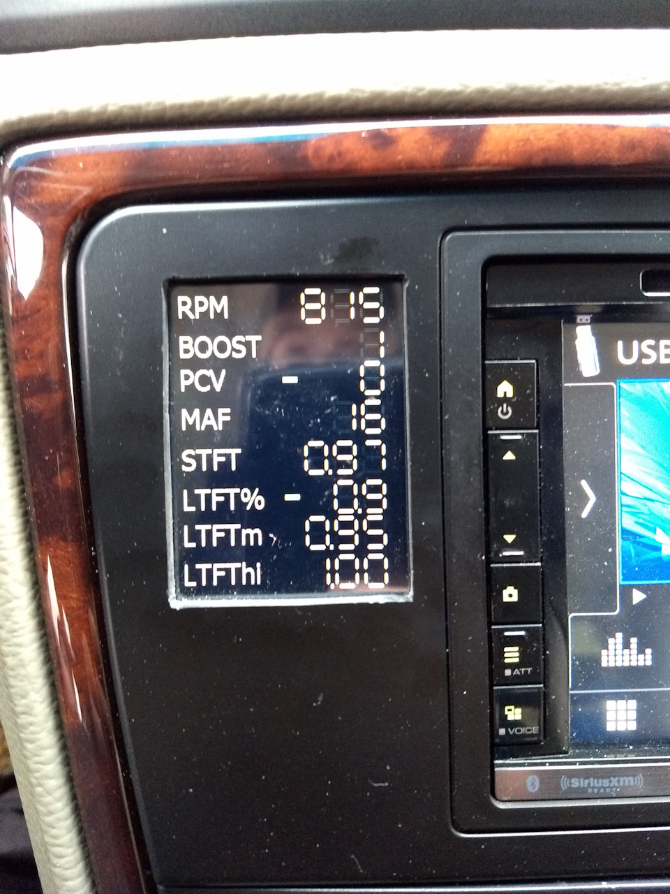

And the fuel trim went to norm quickly:
So I knew this is a parasitic vacuum drain through PTC. I got the whole new pipe, installed it, threw out the catch can and all is good now.
