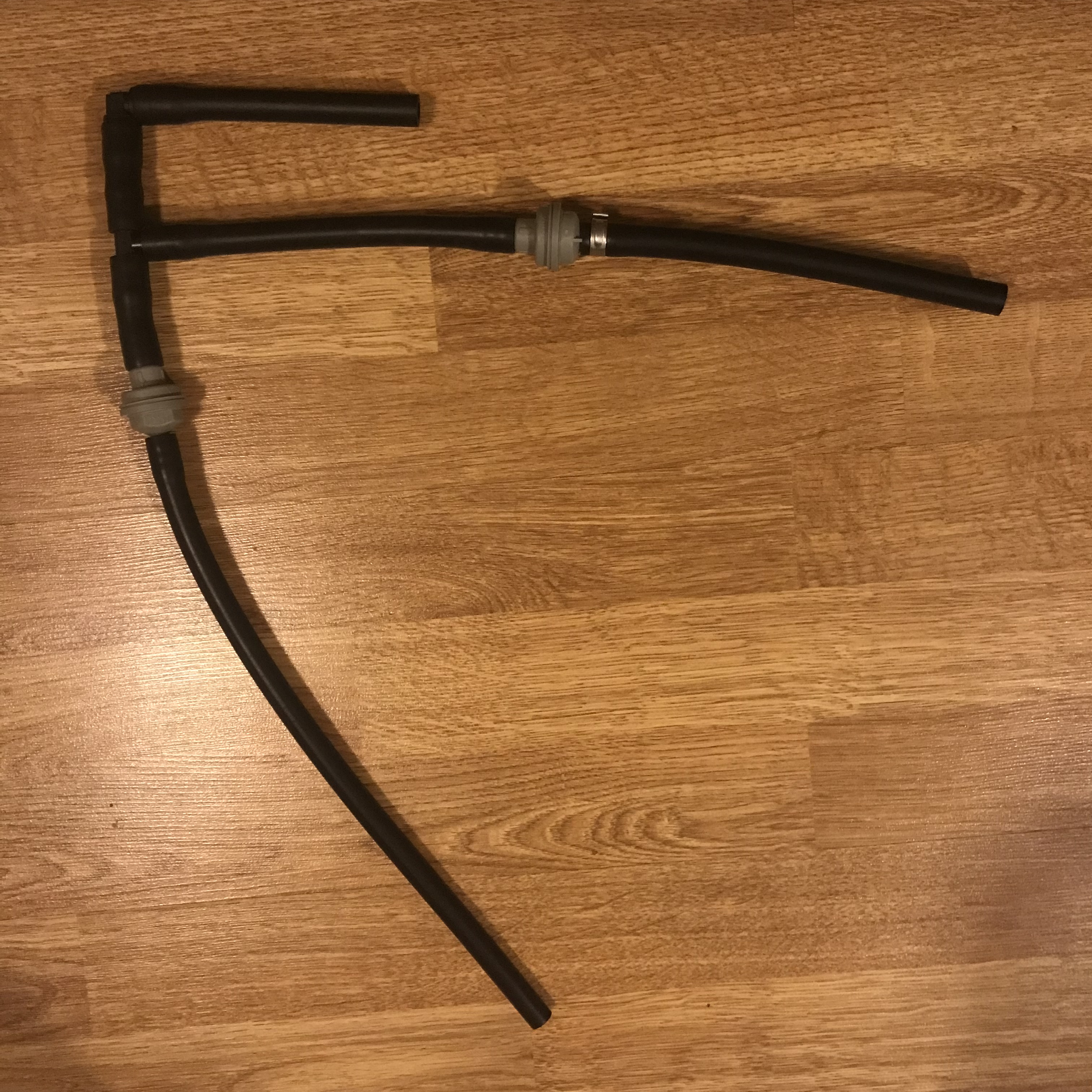

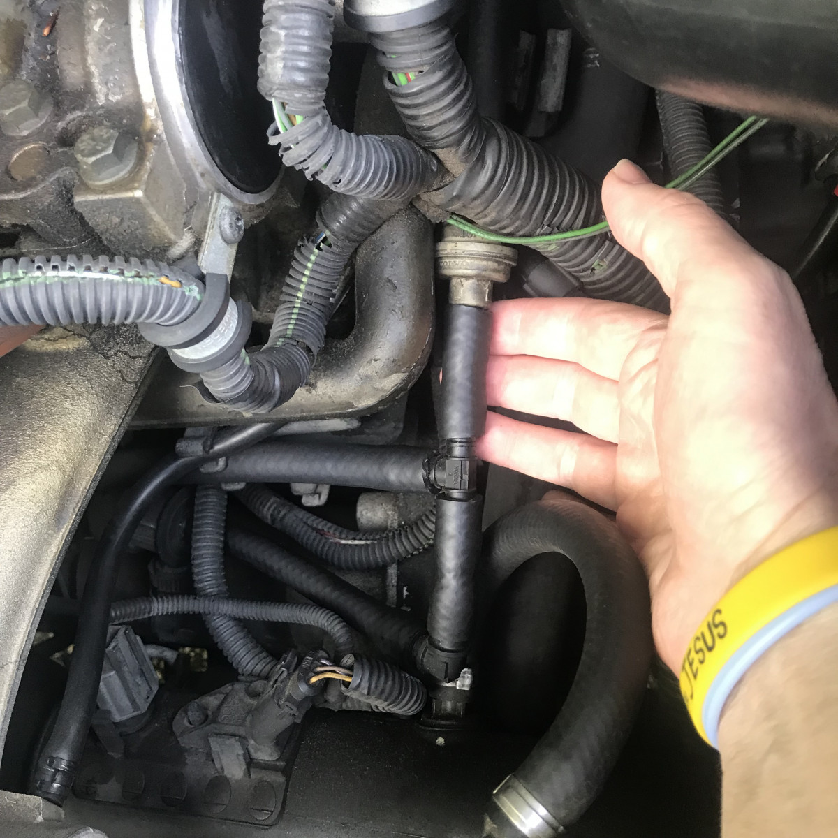

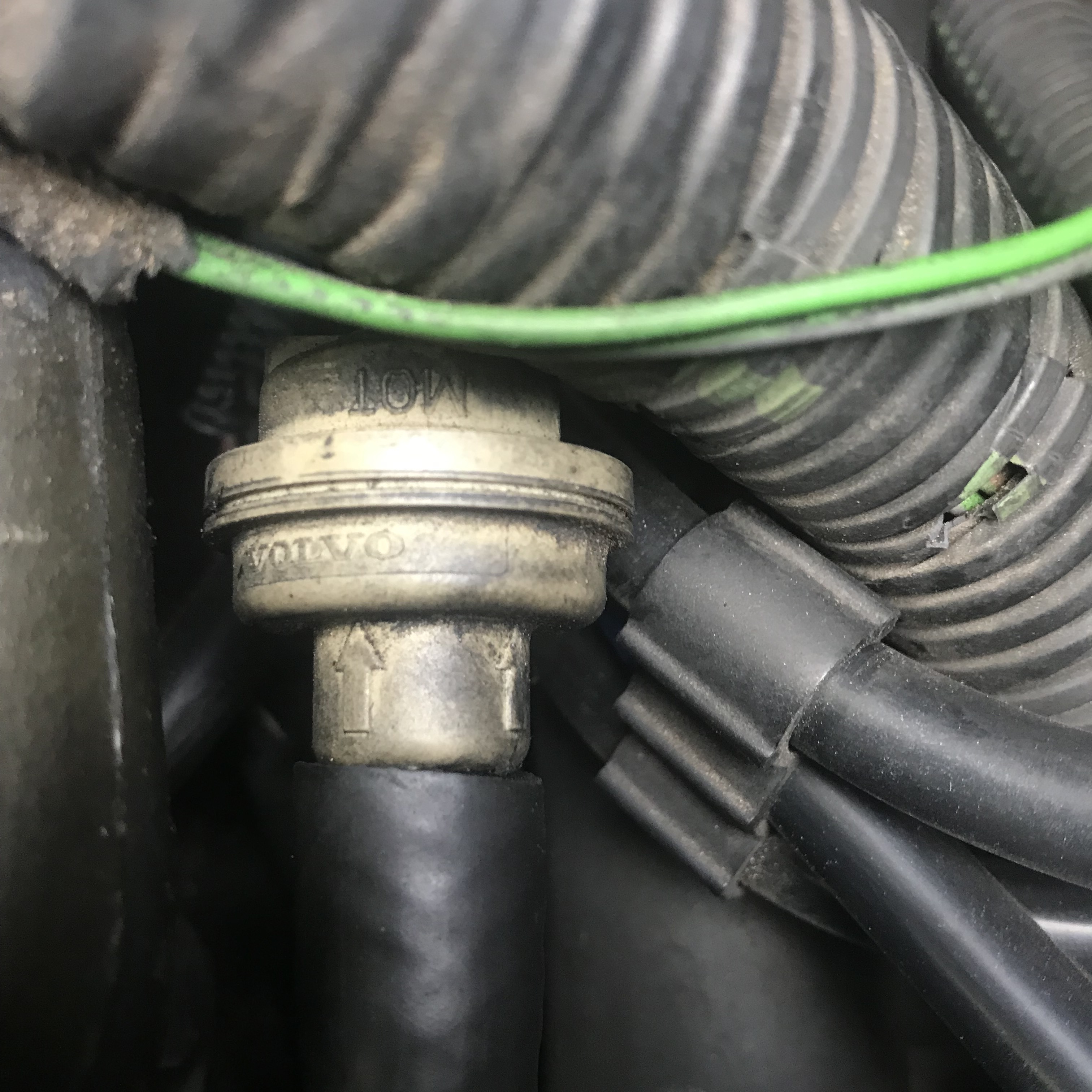

Side note - on my visual inspection, the larger evap hose has split in several places. I'm not sure if that's all the way through, or mainly cosmetic, but I probably should replace that with the correct size tubing - who can tell me what that is and where to get it? If you're not sure what hose I'm talking about, see the pictures. And as a side question - what is the white fitting in that line? a 1 way valve?

The turbo model pulls evap vacuum from two places, the intake manifold when at idle ( that’s the right hand* branch of the T connection in your photo) , and the snorkel when under boost ; that’s the rear* branch of the T heading down to the snorkel.
The black and white valve is a check valve that stops those two vacuum sources from fighting each other

Well, that appears to have done the trick! Here is the new assembly:
New Evap hose assembly

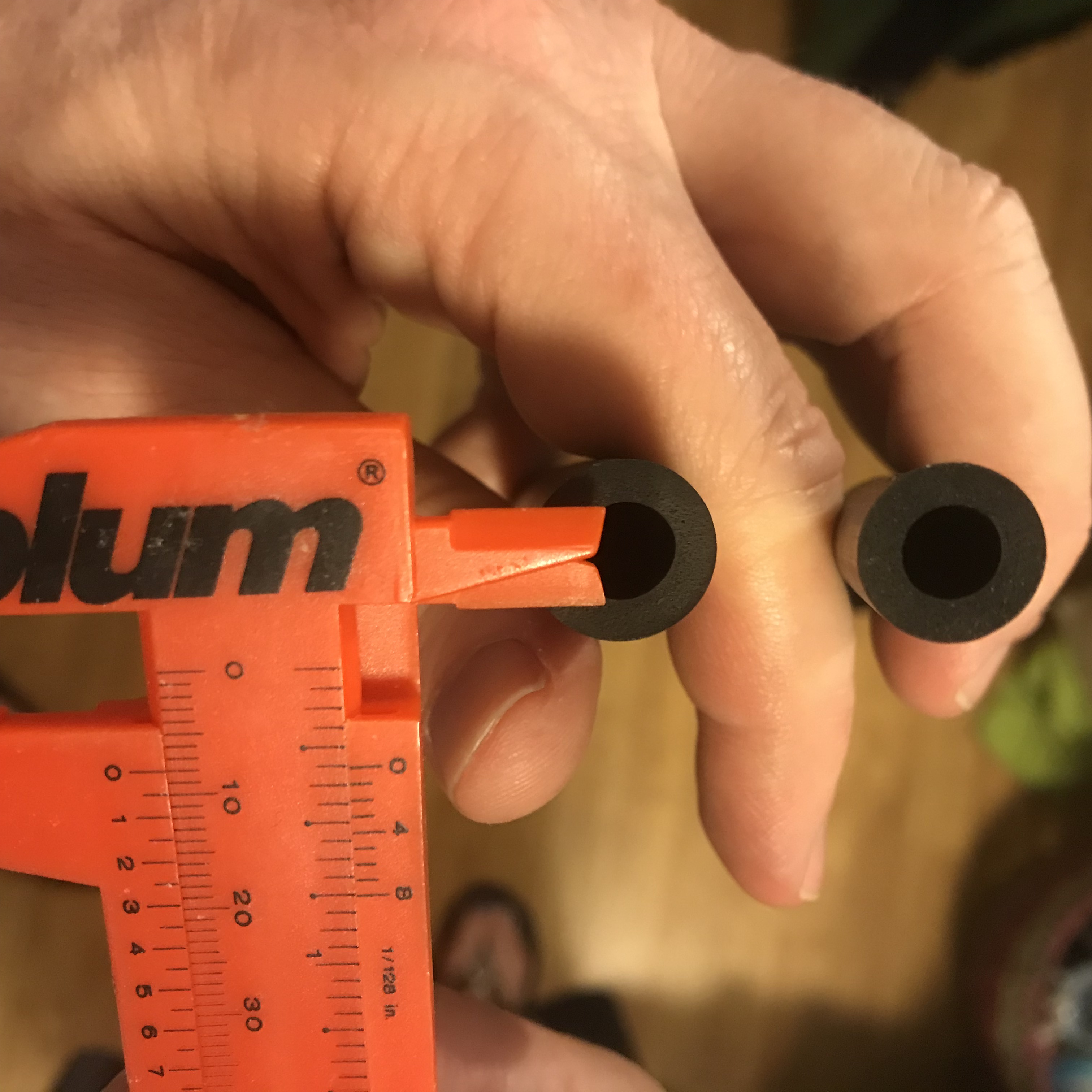

Also, for anyone else who stumbles acros this thread, the assembly appears to be made with a non-reinforced silicone rubber that is actually two different sizes. All but one hose appears to be 8mm ID, wheras the long hose that goes back to the air intake appears to be 6mm ID. It is hard to tell in this picture, but I assure you that they ae different sizes (I should have put my calipers up against each one, but oh well).
New Evap hose sizes
New Evap hose sizes

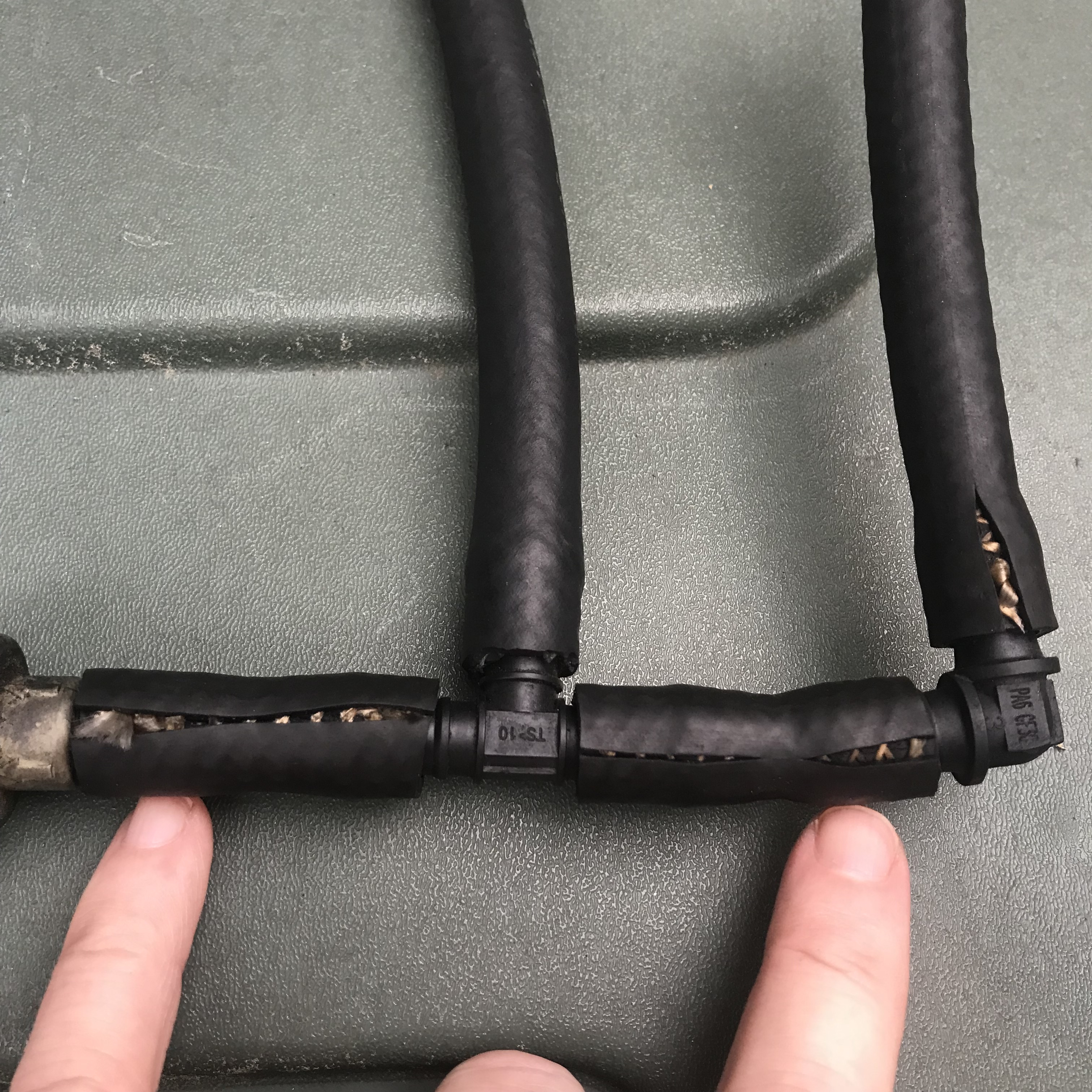

And for anyone curious - here are the split hoses....yeah, that might cause a problem! :lol:
DIY with the wrong size fuel line - results in split hoses
