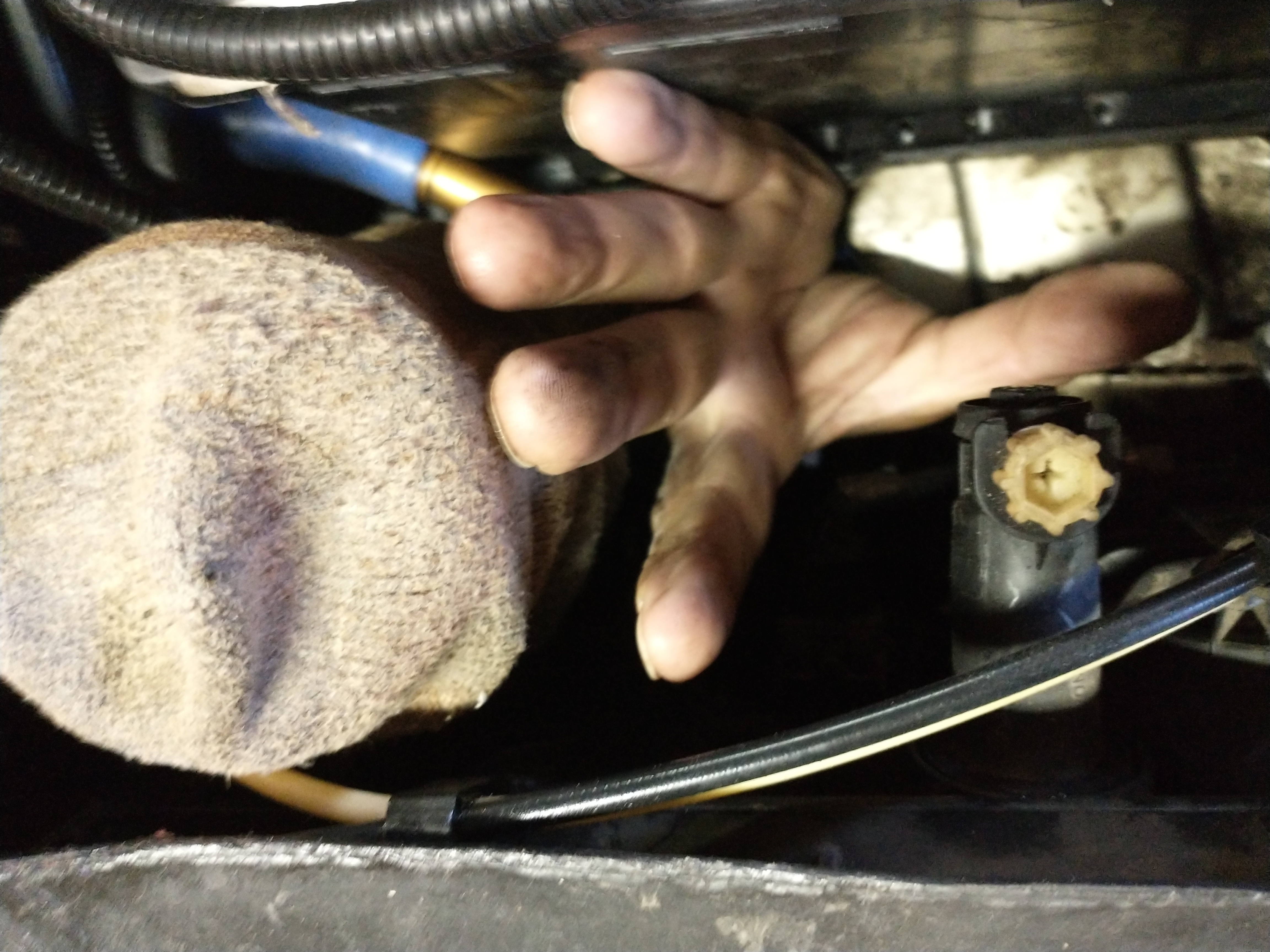

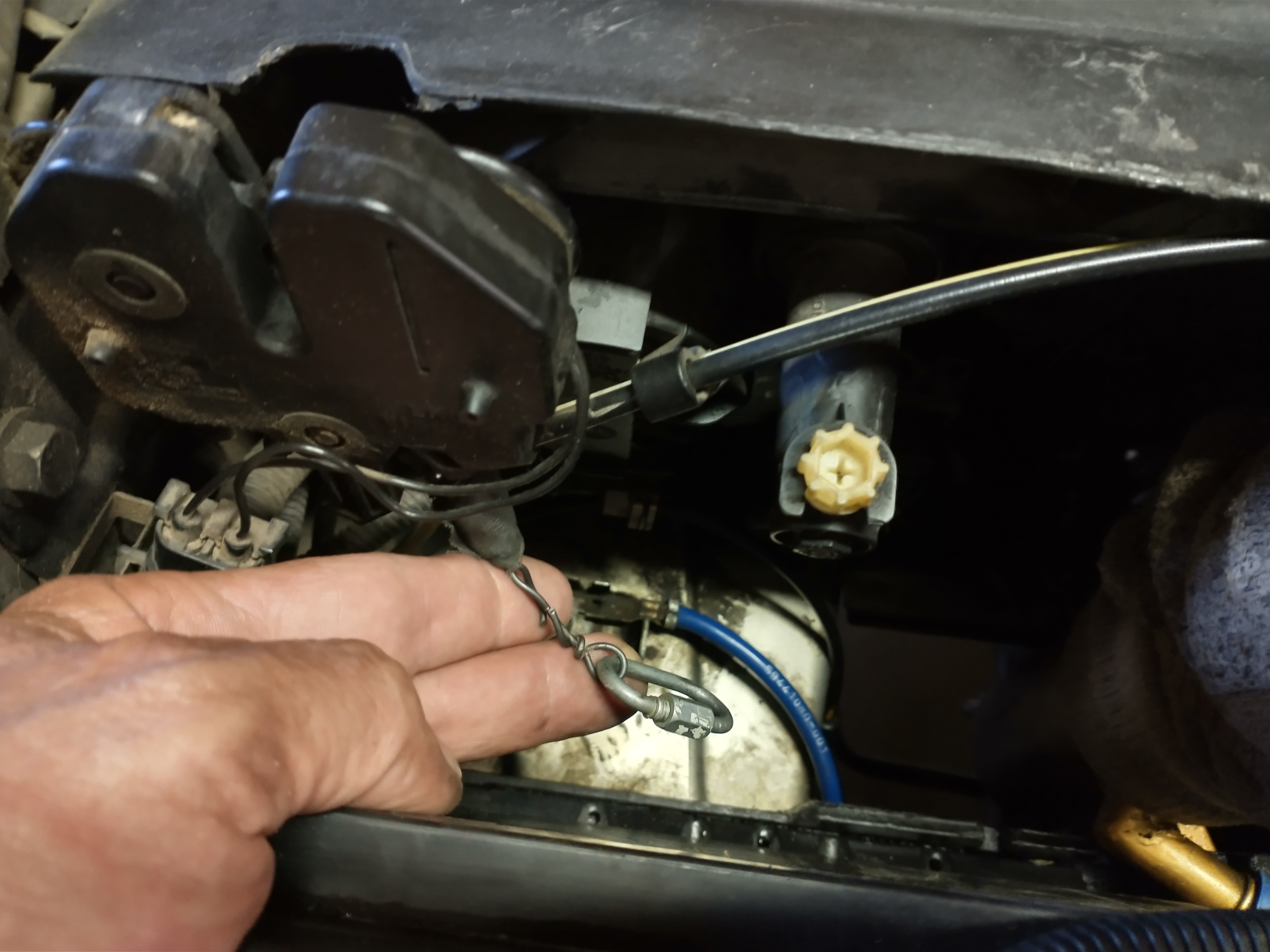

I put a little piece of wire with a doohickey on it so I can reach up and find the latch from underneath. it's a little tighter in my case because I have an oil catch can there between the battery and the latch. But I still have 0 trouble opening the hood this way. I wrapped the " tab " on the latch with tape so it was more comfortable to push. If you play with that tab you will see that it operates both latches.

Best backup is something like Sveedy posted. On my P80 cars I used bicycle brake cables so the cable runs further down than in Sveedy's pics and you can just reach under the car and pull it. One cable on each side.
