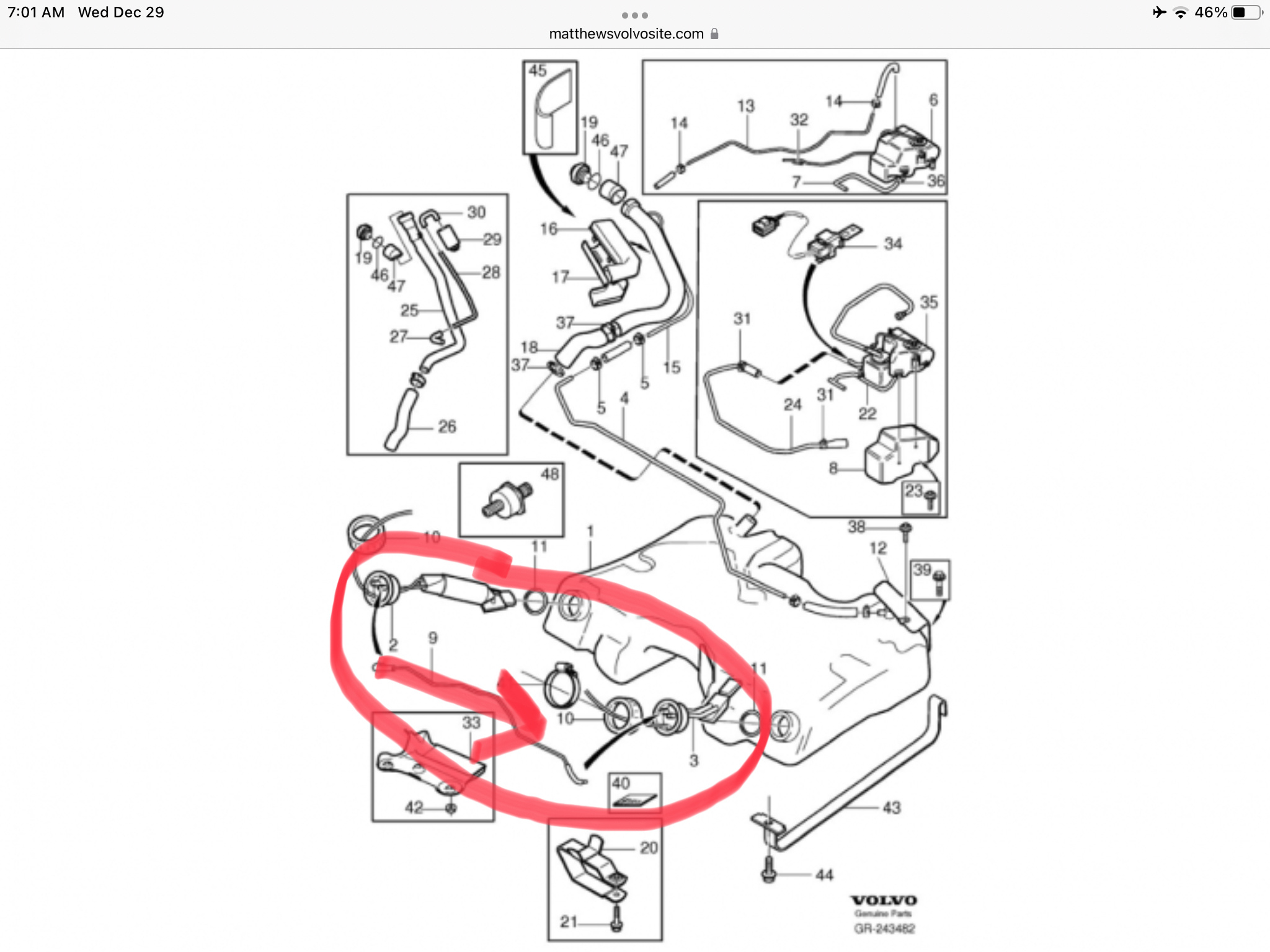

- Posts: 36149
Here’s the detail on the crossover pipe. The thing on the right side of picture ( left of car) isn’t a pump , but that ejector contraption Neil refers to above. It’s basically a Venturi that duck fuel from left saddle to right saddle so can get the whole tank volume available

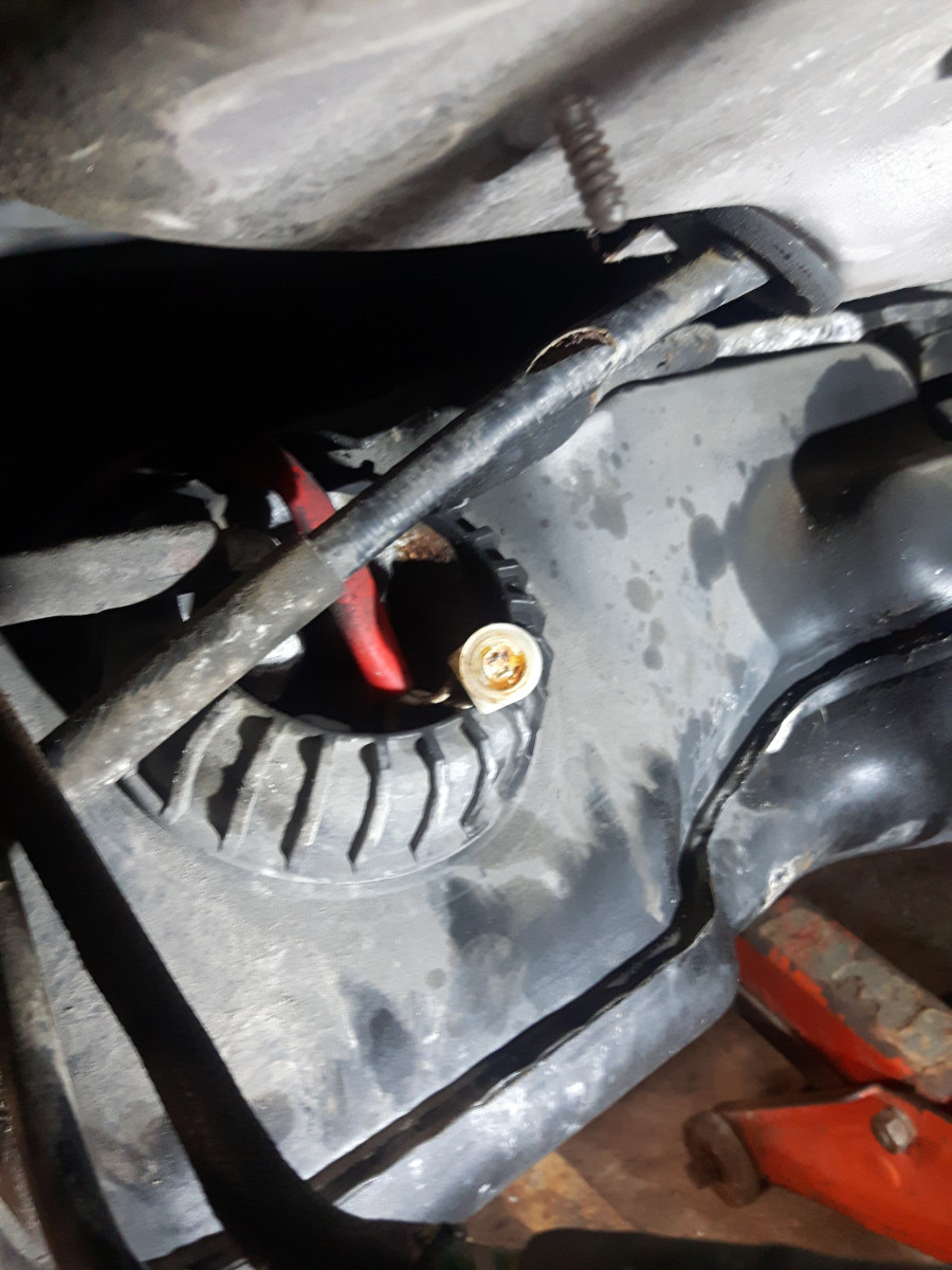

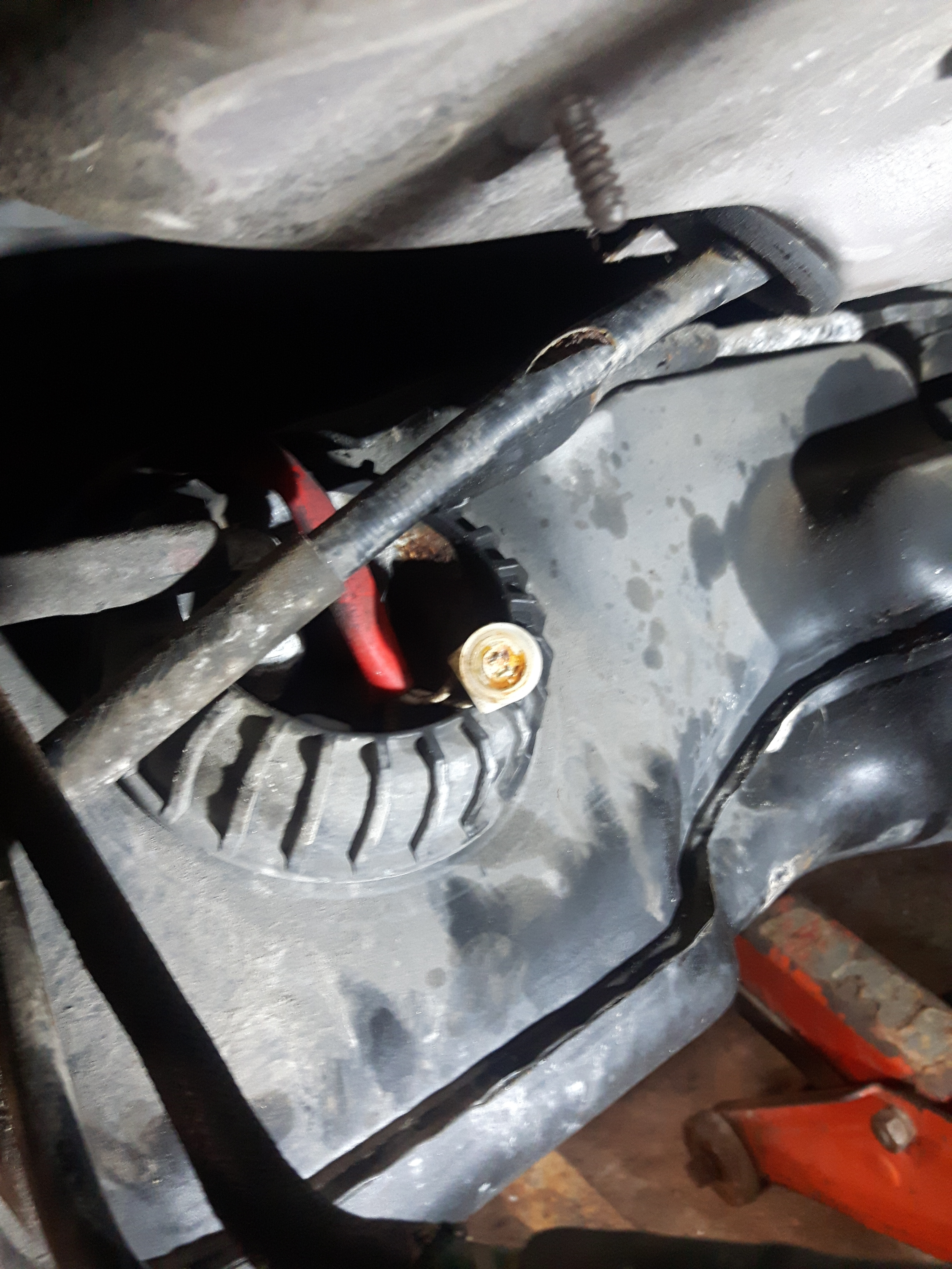

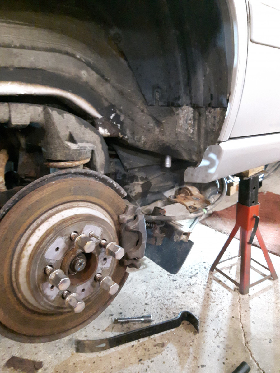

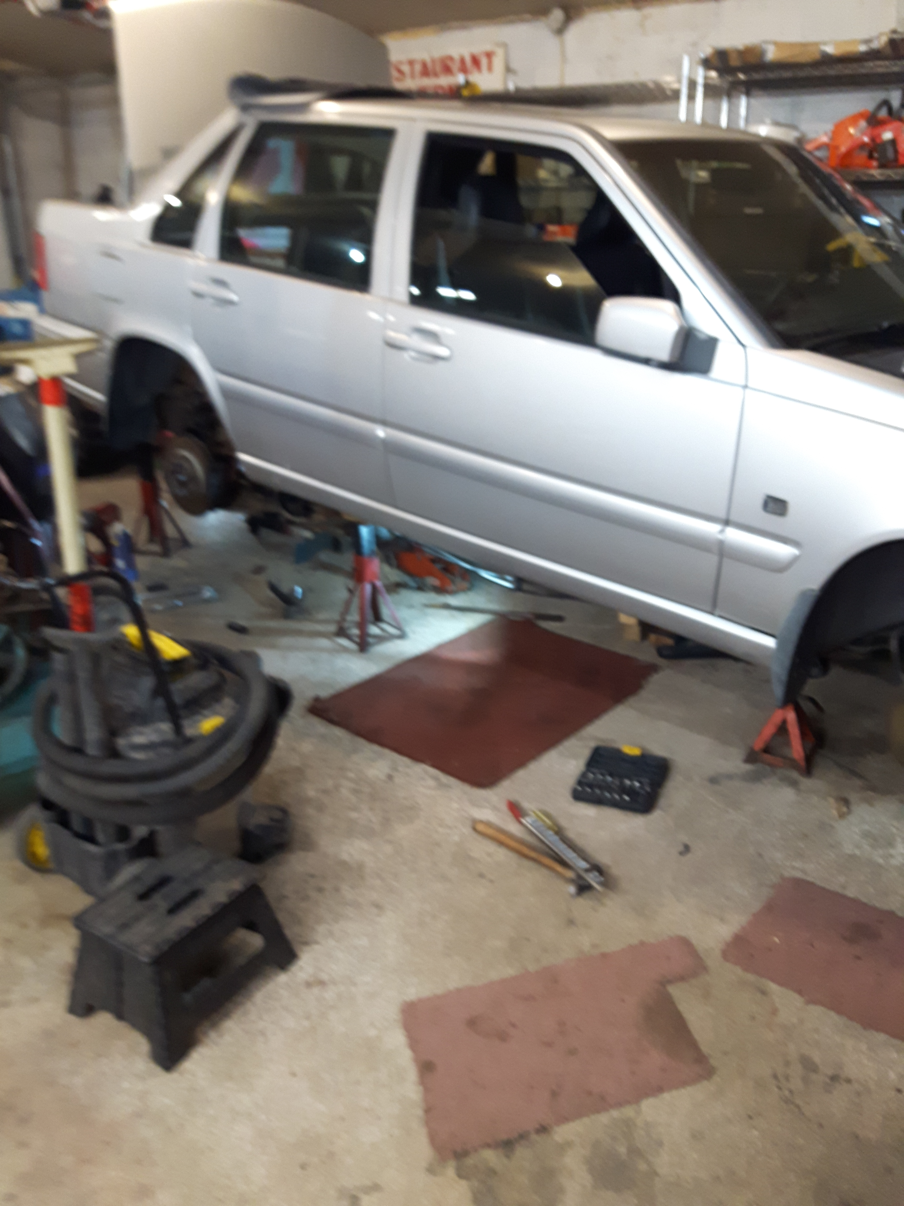

Had me some extra time yesterday and did what you guys suggested.
Third picture show corroded wires that are causing the trouble.
So today's mission will be to remove pump from tank and run test see if pump is still alive.
cheers
cheers

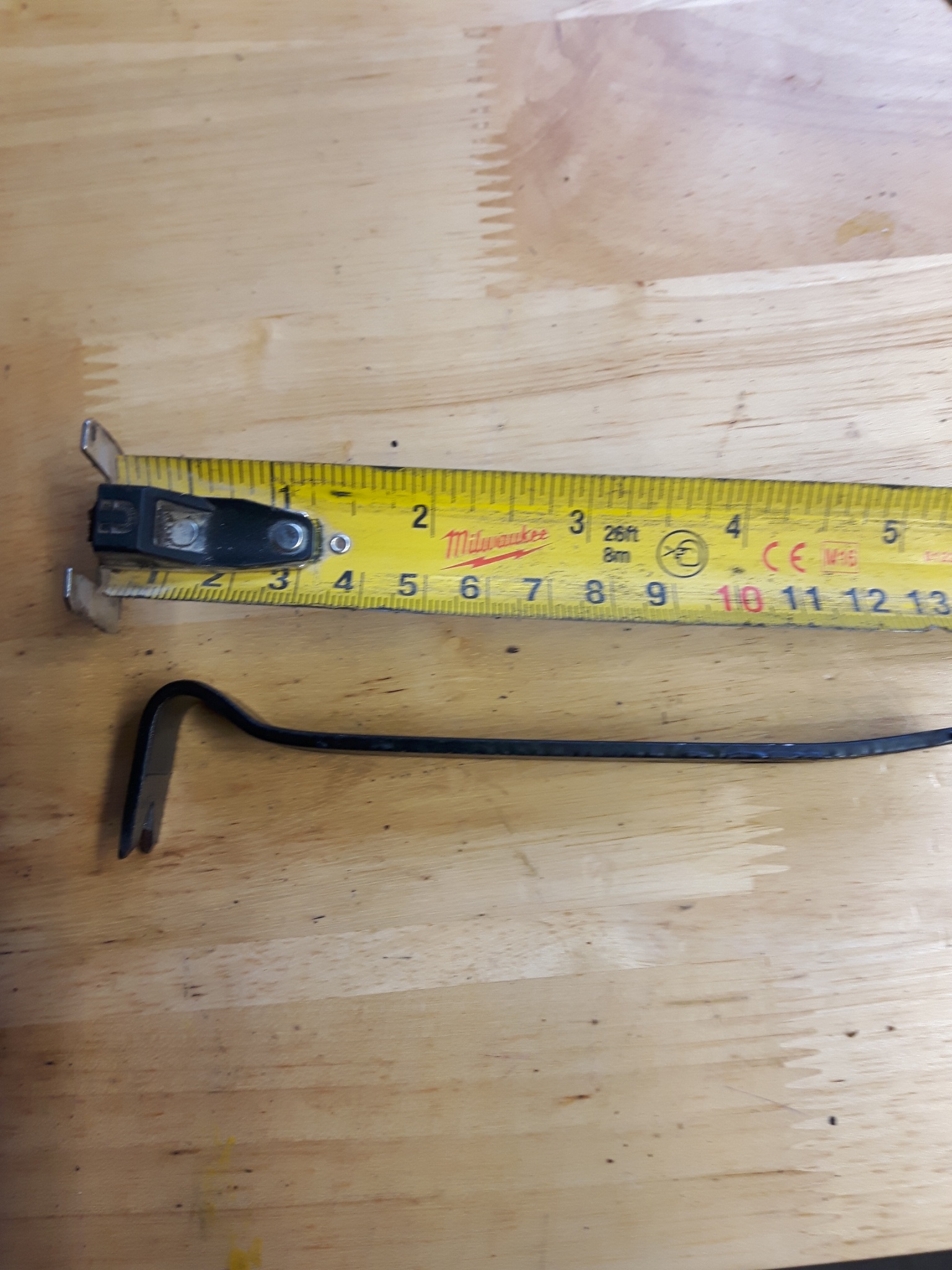

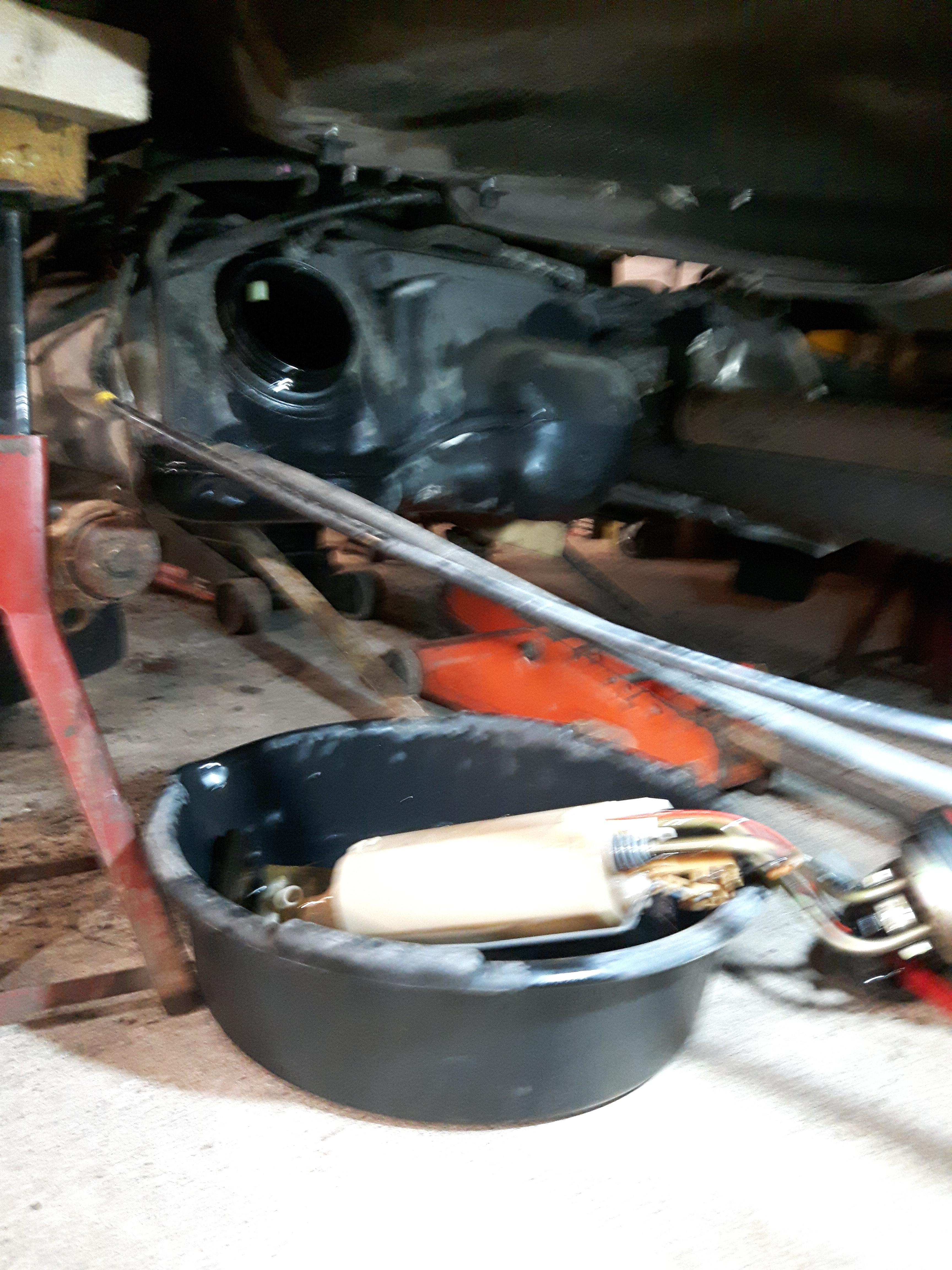

Okay figured out the fuel line thing,, used this tool
and finally got it out
determined pump is still functioning but wiring simply corroded at tank entrance.
sorry about pic quality
