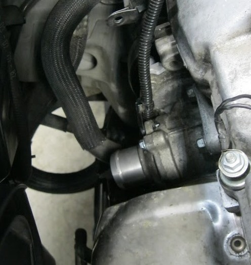

I did note a photo of the t-stat from the top and when everything is fully seated, there is no gap between cover and housing. This is after replacement:
B8444S T-Stat from top.JPG (65.17 KiB) Viewed 555 times

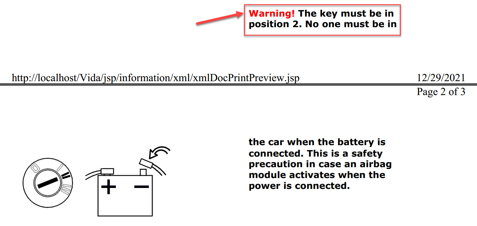

The issue of putting the key to position 2.
I had brought up this issue in the XC70 forum and was told it is not a big deal.
What do you think?

The "book" way on reconnecting the battery is to have the key in POS II to allow all the vehicle modules to absorb the current in-rush when the primary power source (battery) is reconnected.
I personally think it's the safest way to reconnect but I'm sure I've forgotten a few times over the years to follow my own advice.
Have not read outright any threads on airbags going off but there must be a legitimate reason for the warning.
Good luck with your repair

ggleavitt wrote: 08 Jan 2022, 08:26 The "book" way on reconnecting the battery is to have the key in POS II to allow all the vehicle modules to absorb the current in-rush when the primary power source (battery) is reconnected.
I started putting the key in that position since it sounds more logical. As you mentioned, no one has complained about not doing as the book says.
Thanks.
